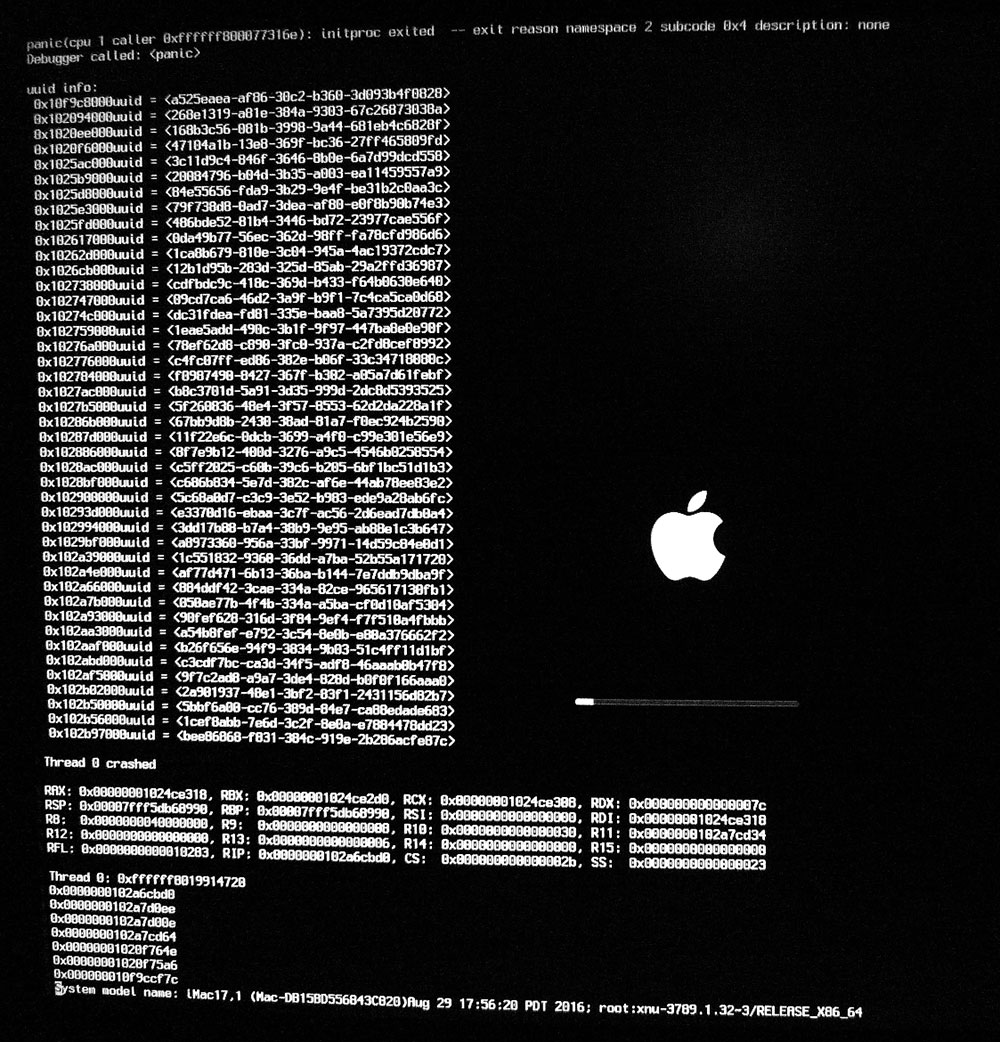

zeg66 Posted March 19, 2017 Author Share Posted March 19, 2017 Tried it. I get a KP very early, it's so fast I cannot read what it says or take a picture, but before the system reboots I can read "thread 0 crashed". motherboard settings: load optimized defaults and then: intel vt off, intel vt-d off, CFG lock off, legacy usb on, xhci handoff off, hda audio on/ac97, serialport off, parallelport off, fastboot off, csm off, secureboot=OtherOS/PureUefi. the system boots fine with ubuntu 16.04 LTS and I extracted the DSDT.aml and DSDT.dsl just in case. Quote Link to comment https://www.insanelymac.com/forum/topic/321816-gigabyte-ga-965p-ds3-rev33-beginner/page/2/#findComment-2387297 Share on other sites More sharing options...

zeg66 Posted March 19, 2017 Author Share Posted March 19, 2017 Here is the DSDT.dsl file: DSDT.7z but the picture of the KP... that is very difficult, it's so fast, all I can see is dumping registers and rebooting. Perhaps if I can borrow a high framerate camera to make a small video of it and examine it frame by frame in vlc. isn't it possible to have the -v verbose output saved into some log file so we can examine it in a more human fashion? Quote Link to comment https://www.insanelymac.com/forum/topic/321816-gigabyte-ga-965p-ds3-rev33-beginner/page/2/#findComment-2387405 Share on other sites More sharing options...
zeg66 Posted March 19, 2017 Author Share Posted March 19, 2017 ok I managed to get a picture by disabling verbose and ... waiting for it. here it is: the first line reads: panic (cpu 1 caller 0x.....): init proc exited -- exit reason namespace 2 subcode 0x4 description: none Quote Link to comment https://www.insanelymac.com/forum/topic/321816-gigabyte-ga-965p-ds3-rev33-beginner/page/2/#findComment-2387438 Share on other sites More sharing options...
MaLd0n Posted March 19, 2017 Share Posted March 19, 2017 i dont know about support Celeron skylake need try CLOVER.zip Quote Link to comment https://www.insanelymac.com/forum/topic/321816-gigabyte-ga-965p-ds3-rev33-beginner/page/2/#findComment-2387481 Share on other sites More sharing options...
zeg66 Posted March 20, 2017 Author Share Posted March 20, 2017 Thank you but I still get the same KP. Well, I tried something different: Prepared a very simple El Capitan 10.11.6 installer with Clover and tried booting with that. If I put the new ElCap thumbdrive on the rear USB2 port I get the same KP as with the Sierra installer. If I put the ElCap thumbdrive on the front USB2 port I get a circular "stop" sign and a message saying "still waiting for root device". Maybe the onboard HD510 graphics card is not supported after all. An i3-6100 costs 130E here so it's a bit out of my reach. Could I keep the Celeron G3900 and try a simple (and preferably fan-less) video card like this: http://xfxforce.com/fr-fr/products/gpus-prcdents/xfx-amd-5450-1gb-graphics-card-hd-545x-zch2 or like this: http://www.gigabyte.com/Graphics-Card/GV-N210SL-1GI#ov those are reasonably priced (around 35E each) but I don't know if 10.12.3 (or 10.11.6) would be ok with either. What do you think? Quote Link to comment https://www.insanelymac.com/forum/topic/321816-gigabyte-ga-965p-ds3-rev33-beginner/page/2/#findComment-2387610 Share on other sites More sharing options...
