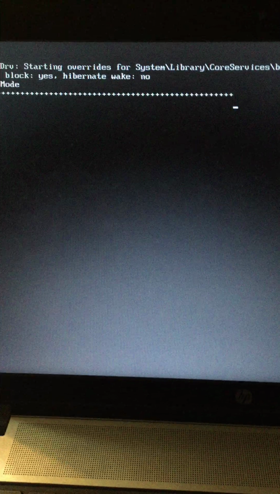

angel1972 Posted March 7, 2017 Author Share Posted March 7, 2017 allora ho lasciato solo i text: VoodooPS2 Fakesmc FakePCIID FakePCIID_Intel_HD_Graphics svuotato origin riprovato ma sempre stuk sui segni piu e riavvio Link to comment https://www.insanelymac.com/forum/topic/321660-sierra-problemi-istallazione-hp-450-g1/page/2/#findComment-2380070 Share on other sites More sharing options...
gengik84 Posted March 7, 2017 Share Posted March 7, 2017 Prova il config allegato config.plist.zip Link to comment https://www.insanelymac.com/forum/topic/321660-sierra-problemi-istallazione-hp-450-g1/page/2/#findComment-2380079 Share on other sites More sharing options...
angel1972 Posted March 7, 2017 Author Share Posted March 7, 2017 niente stesso comportamento Link to comment https://www.insanelymac.com/forum/topic/321660-sierra-problemi-istallazione-hp-450-g1/page/2/#findComment-2380089 Share on other sites More sharing options...

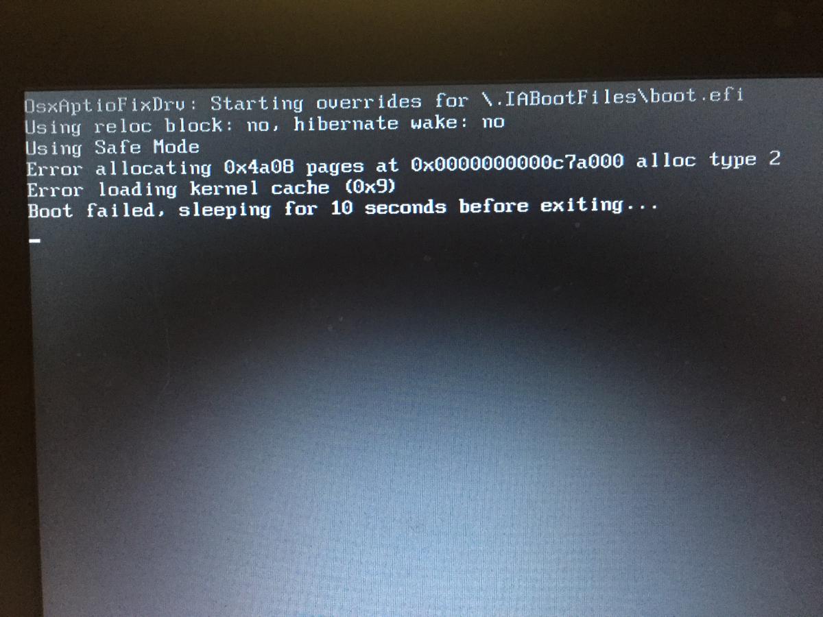

gengik84 Posted March 7, 2017 Share Posted March 7, 2017 il bios mettilo in UEFI puro... Controlla qui le impostazioni Poi potresti postare la foto del blocco? Link to comment https://www.insanelymac.com/forum/topic/321660-sierra-problemi-istallazione-hp-450-g1/page/2/#findComment-2380095 Share on other sites More sharing options...
angel1972 Posted March 7, 2017 Author Share Posted March 7, 2017 ho allegato la foto scusate l'imprecisione ma dopo fa subito il reboot quindi è difficle fare foto decente il bios l'ho controllato e corrisponde boot solo EUFI Grazie Link to comment https://www.insanelymac.com/forum/topic/321660-sierra-problemi-istallazione-hp-450-g1/page/2/#findComment-2380097 Share on other sites More sharing options...
gengik84 Posted March 7, 2017 Share Posted March 7, 2017 tramite clover configurator, install driver...seleziona come destinazione la EFI e installa OSxAptioFix2Drv Recati in EFI/clover/Driver64UEFI e controlla che sia stato installato, poi cancella la versione normale dello stesso driver e riprova Prova anche su più porte usb Link to comment https://www.insanelymac.com/forum/topic/321660-sierra-problemi-istallazione-hp-450-g1/page/2/#findComment-2380103 Share on other sites More sharing options...
angel1972 Posted March 7, 2017 Author Share Posted March 7, 2017 fatto ho provato in tutte le quattro porte usb del pc adesso il messaggio è quello in allegato Link to comment https://www.insanelymac.com/forum/topic/321660-sierra-problemi-istallazione-hp-450-g1/page/2/#findComment-2380109 Share on other sites More sharing options...
gengik84 Posted March 7, 2017 Share Posted March 7, 2017 ma non hai messo la versione 2 del driver... Link to comment https://www.insanelymac.com/forum/topic/321660-sierra-problemi-istallazione-hp-450-g1/page/2/#findComment-2380118 Share on other sites More sharing options...
angel1972 Posted March 7, 2017 Author Share Posted March 7, 2017 si OsxAptioFix2Drv-64.efi Link to comment https://www.insanelymac.com/forum/topic/321660-sierra-problemi-istallazione-hp-450-g1/page/2/#findComment-2380122 Share on other sites More sharing options...

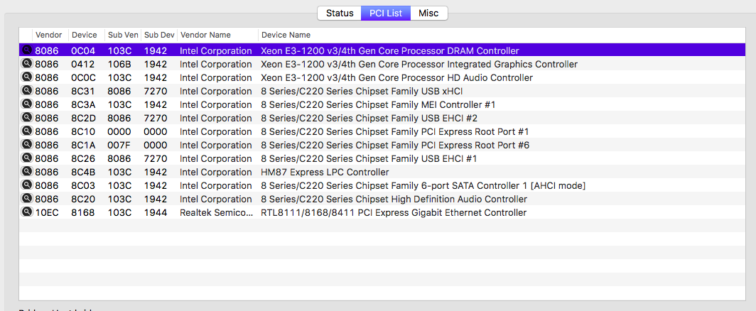

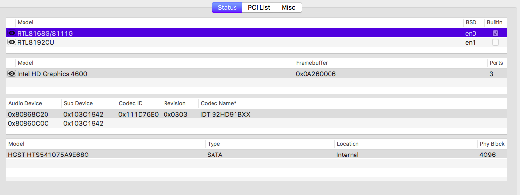

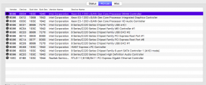

Jolly Posted March 8, 2017 Share Posted March 8, 2017 Per l'audio scaricati dpcimanager, lancialo, clicca su update seed e update id e poi posta immagini sia di Status che Pci List. Comunque dai post precedenti sembra tu abbia un "IDT 92HD91BXX". Scaricati AppleALC e mettilo nella EFI, nel config sezione Devices Audio/Inject metti 3. Nel config devi avere il Rename HDAS-->HDEF altrimenti no audio. Prova anche con 12 e vedi con quale dei due va meglio. EDIT: Non serve il Rename HDAS-->HDEF Link to comment https://www.insanelymac.com/forum/topic/321660-sierra-problemi-istallazione-hp-450-g1/page/2/#findComment-2380434 Share on other sites More sharing options...
angel1972 Posted March 8, 2017 Author Share Posted March 8, 2017 allego le immagini e intanto provo grazie mille! Link to comment https://www.insanelymac.com/forum/topic/321660-sierra-problemi-istallazione-hp-450-g1/page/2/#findComment-2380451 Share on other sites More sharing options...
Jolly Posted March 8, 2017 Share Posted March 8, 2017 È quello Link to comment https://www.insanelymac.com/forum/topic/321660-sierra-problemi-istallazione-hp-450-g1/page/2/#findComment-2380452 Share on other sites More sharing options...

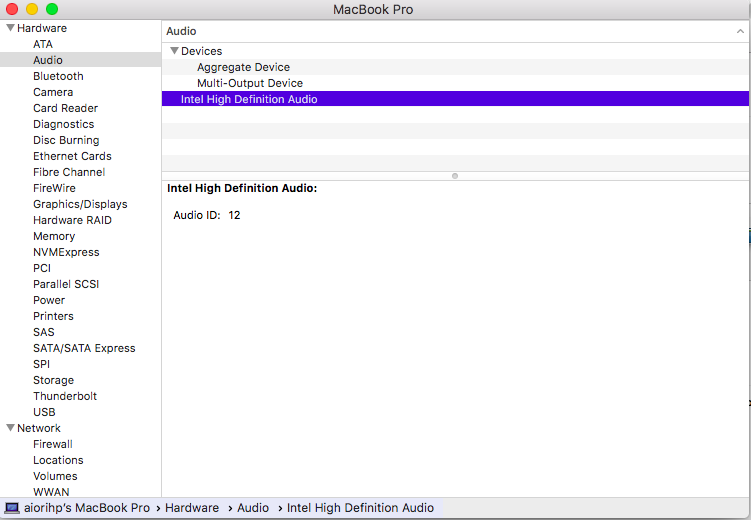

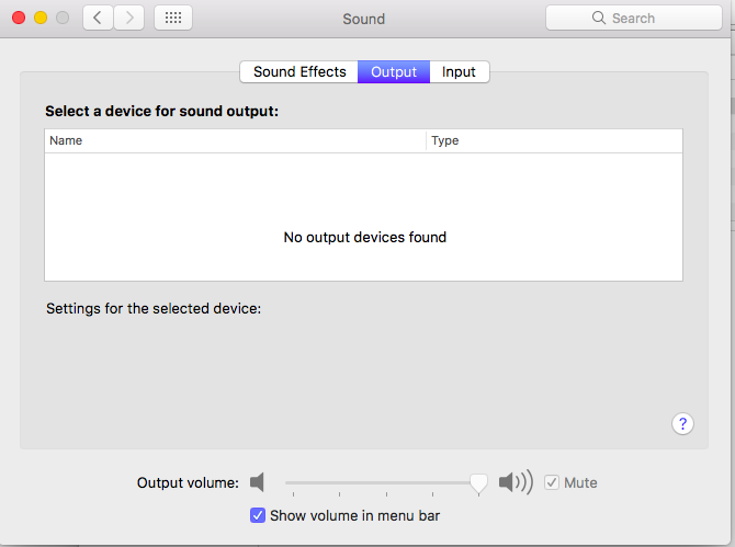

Jolly Posted March 8, 2017 Share Posted March 8, 2017 Posta screenshot di Informazioni di sistema / Audio e Preferenze di sistema / Suono/Uscita Link to comment https://www.insanelymac.com/forum/topic/321660-sierra-problemi-istallazione-hp-450-g1/page/2/#findComment-2380478 Share on other sites More sharing options...
angel1972 Posted March 8, 2017 Author Share Posted March 8, 2017 eccoli Link to comment https://www.insanelymac.com/forum/topic/321660-sierra-problemi-istallazione-hp-450-g1/page/2/#findComment-2380484 Share on other sites More sharing options...

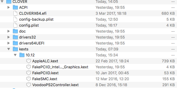

Jolly Posted March 8, 2017 Share Posted March 8, 2017 Strano, di solito dovrebbe esserci i device in informazioni di sistema. Hai appleALC in Kexts/10.12 sì? (Come mai le scritte inglese?) Link to comment https://www.insanelymac.com/forum/topic/321660-sierra-problemi-istallazione-hp-450-g1/page/2/#findComment-2380488 Share on other sites More sharing options...
angel1972 Posted March 8, 2017 Author Share Posted March 8, 2017 si cè ho istallato in inglese Link to comment https://www.insanelymac.com/forum/topic/321660-sierra-problemi-istallazione-hp-450-g1/page/2/#findComment-2380491 Share on other sites More sharing options...
