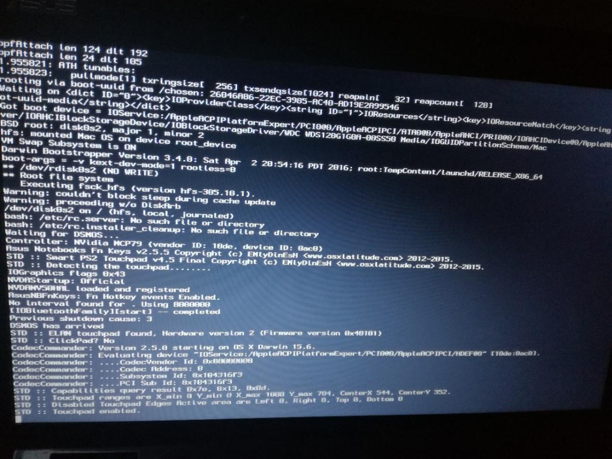

BadWolfAlfa Posted March 5, 2017 Share Posted March 5, 2017 After try install Mac OS Sierra without luck (my Intel T4300 no support SSE4,1) i installed El Capitan I few weeks ago installed Yosemite, and work all (battery, card reader, etc, etc) Now, i have El Capitan, working WLAN, NVIdia G102M But i have problems with Battery level (for Mac no exist the Battery, in Yosemite works) and card reader, and ALC662 (no detected), i attach the DSDT I use Chameleon clover no work...for me The Hardware are: 1. Model: Asus K50IN 2. Processor: Intel® Core™2 Duo CPU T4300 (SSE 2, SSE 3) 3. Southbridge: MCP79 4. Graphics card: NVIDIA GeForce G102M 5. Audio: ALC662 6. LAN: RTL8111/8168B 7. WLAN: Atheros AR9285 8. HDD and Optical disc recorder - SATA 9. Keyboard and touchpad - PS/2 (Elan) 10. Webcam: Chicony CNF7129 11. Card reader: Alcor AU6433 regards!!! PS; the proccesor are a 53º/60º ¿are normal? if i reboot/shutdown never off the PC i need push power button for that... ------- Update: For now ALC662 working perfect And shutdown No working: Battery level/detect Reboot (after in theory shutdown in reboot never load, stay in Black and leds working) DSDT.aml.zip Link to comment https://www.insanelymac.com/forum/topic/321647-asus-k50in-need-some-help-dsdt-inside/ Share on other sites More sharing options...

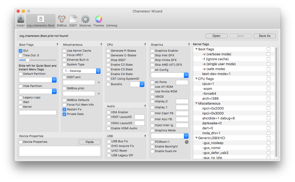

MaLd0n Posted March 6, 2017 Share Posted March 6, 2017 u can try with Chameleon Wizard and check Chameleon Wizard.app.zip Is a default option, but try i think ur problem is a old nvidia, many years ago all people have problem, many solve apply patch into _GTS(going to sleep), but dont work for all the best is Clover, amazin' bootloader. http://www.insanelymac.com/forum/topic/257464-chameleon-wizard-utility-for-chameleon/ Link to comment https://www.insanelymac.com/forum/topic/321647-asus-k50in-need-some-help-dsdt-inside/#findComment-2379096 Share on other sites More sharing options...
BadWolfAlfa Posted March 6, 2017 Author Share Posted March 6, 2017 are enabled... and yes Clover are amazing but in my computer no work Never load... Link to comment https://www.insanelymac.com/forum/topic/321647-asus-k50in-need-some-help-dsdt-inside/#findComment-2379099 Share on other sites More sharing options...

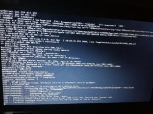

BadWolfAlfa Posted March 6, 2017 Author Share Posted March 6, 2017 never load, stuck in _ and never load... 1 Link to comment https://www.insanelymac.com/forum/topic/321647-asus-k50in-need-some-help-dsdt-inside/#findComment-2379132 Share on other sites More sharing options...
MaLd0n Posted March 6, 2017 Share Posted March 6, 2017 try and post a photo if u extract original DSDT i create ur Clover folder Link to comment https://www.insanelymac.com/forum/topic/321647-asus-k50in-need-some-help-dsdt-inside/#findComment-2379135 Share on other sites More sharing options...

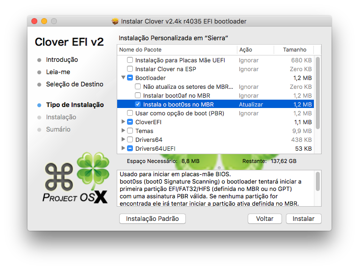

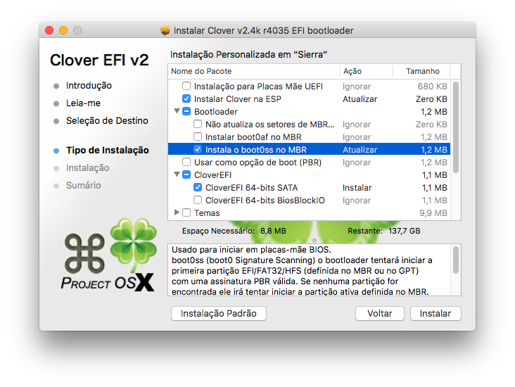

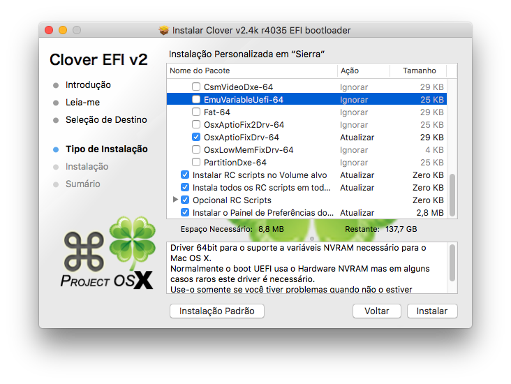

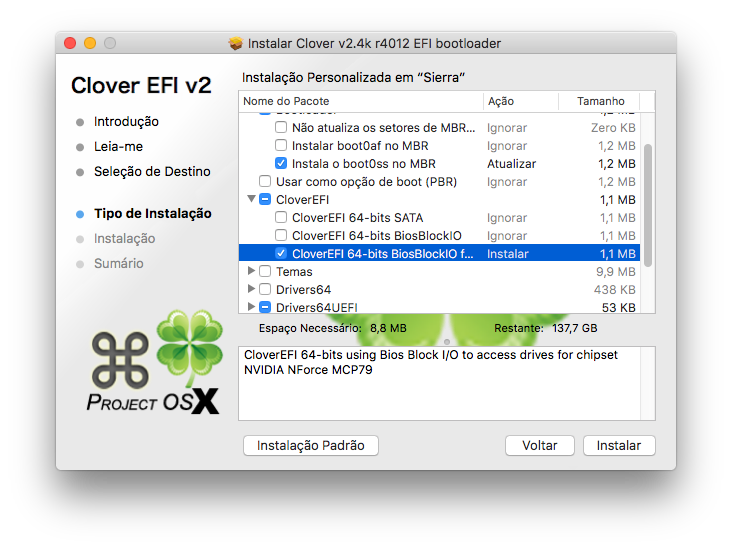

BadWolfAlfa Posted March 6, 2017 Author Share Posted March 6, 2017 what happens? if i delete all on EFI partition, reformat efi partition to (msdos) activate, and install CLOVER, and change your files, the " _ " still here and never boot in EFI partition i not see boot only boot6 and boot7 1 Link to comment https://www.insanelymac.com/forum/topic/321647-asus-k50in-need-some-help-dsdt-inside/#findComment-2379432 Share on other sites More sharing options...
MaLd0n Posted March 6, 2017 Share Posted March 6, 2017 try it config.plist.zip send me Clover folder generate with installer ok, try it for install install in root of the HD Link to comment https://www.insanelymac.com/forum/topic/321647-asus-k50in-need-some-help-dsdt-inside/#findComment-2379438 Share on other sites More sharing options...
BadWolfAlfa Posted March 6, 2017 Author Share Posted March 6, 2017 i cant upload more than 10MB i uploaded to MEGA, sorry: https://mega.nz/#!9JF2xS5A!5RRWJMBCkoWrzJI6ahKngHcIVF5S51ETGe13s278ITU Link to comment https://www.insanelymac.com/forum/topic/321647-asus-k50in-need-some-help-dsdt-inside/#findComment-2379447 Share on other sites More sharing options...
BadWolfAlfa Posted March 6, 2017 Author Share Posted March 6, 2017 try it config.plist.zip send me Clover folder generate with installer ok, try it for install 01.png install in root of the HD Tried without luck Probably mbr problem? Link to comment https://www.insanelymac.com/forum/topic/321647-asus-k50in-need-some-help-dsdt-inside/#findComment-2379483 Share on other sites More sharing options...

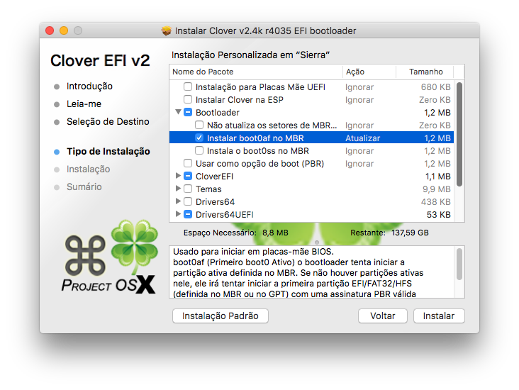

MaLd0n Posted March 6, 2017 Share Posted March 6, 2017 try CLOVER.zip if dont work, try with boot0af 1 Link to comment https://www.insanelymac.com/forum/topic/321647-asus-k50in-need-some-help-dsdt-inside/#findComment-2379492 Share on other sites More sharing options...
BadWolfAlfa Posted March 6, 2017 Author Share Posted March 6, 2017 if i install clover in Mac partition no need change current partition active to the partition 2? b1f error now "boot" but have b1f error 1 Link to comment https://www.insanelymac.com/forum/topic/321647-asus-k50in-need-some-help-dsdt-inside/#findComment-2379498 Share on other sites More sharing options...
MaLd0n Posted March 6, 2017 Share Posted March 6, 2017 u can try a fresh instal, and after install clover with boot0af option, i think work Link to comment https://www.insanelymac.com/forum/topic/321647-asus-k50in-need-some-help-dsdt-inside/#findComment-2379524 Share on other sites More sharing options...

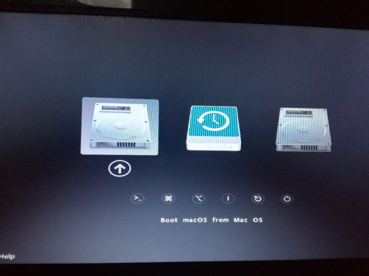

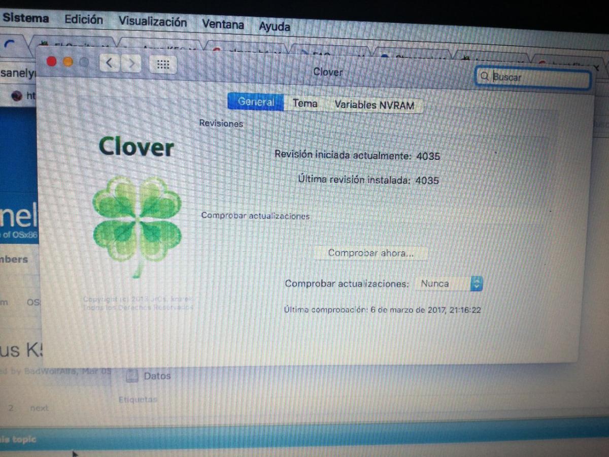

BadWolfAlfa Posted March 7, 2017 Author Share Posted March 7, 2017 OMG finally worked images attached my problem and solution: after install clover i need select: pbr options, after pbr files created i need change boot7 to boot and WORKS And now? still remain the problems on: no battery icon(and no battery info), the BT no load (no appear in settings/information of devices) (and yes i used your great clover folder) thanks thanks and big thanks finally get clover (never load for me, and you make yes load!) ps: clover it's ultra fast hahaha 1 Link to comment https://www.insanelymac.com/forum/topic/321647-asus-k50in-need-some-help-dsdt-inside/#findComment-2379642 Share on other sites More sharing options...
