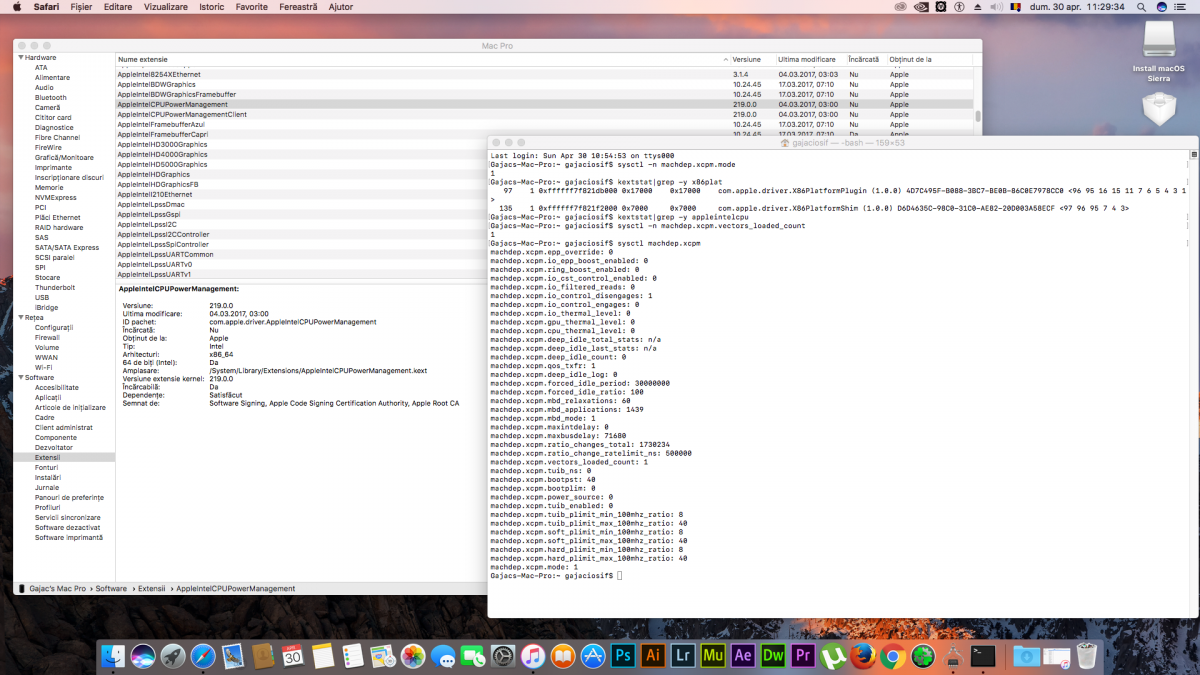

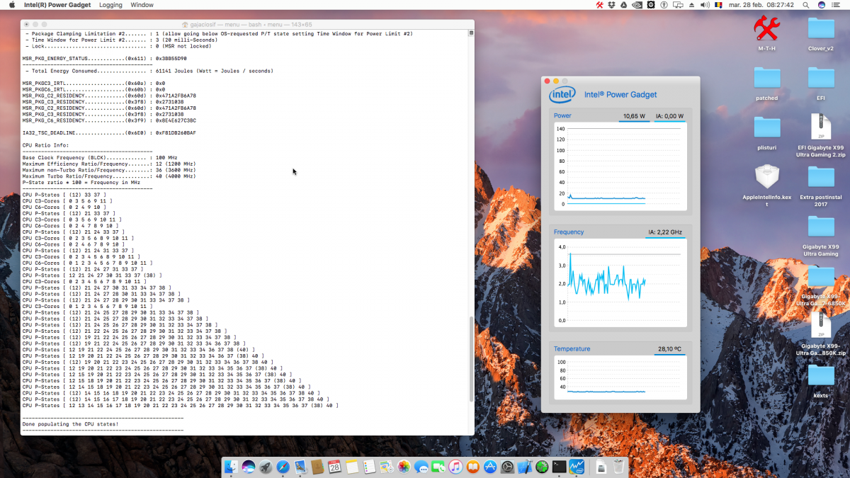

Sygey02 Posted February 20, 2017 Author Share Posted February 20, 2017 I Compiled and loaded the. AppleIntelInfo.kext. 1 Link to comment https://www.insanelymac.com/forum/topic/321216-macos-sierra-on-gigabyte-x99-ultra-gaming-cf-i7-6850k/#findComment-2370519 Share on other sites More sharing options...

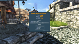

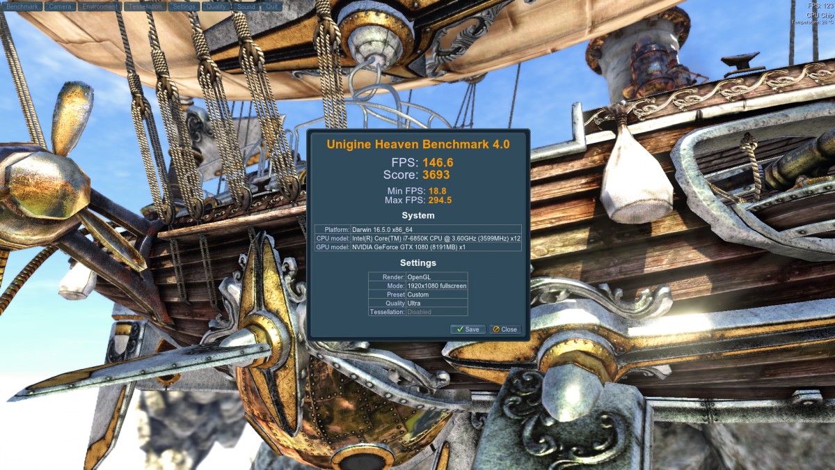

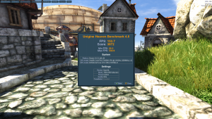

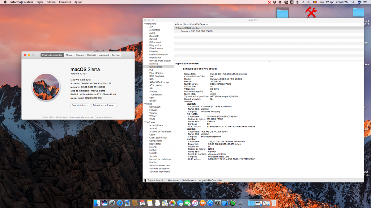

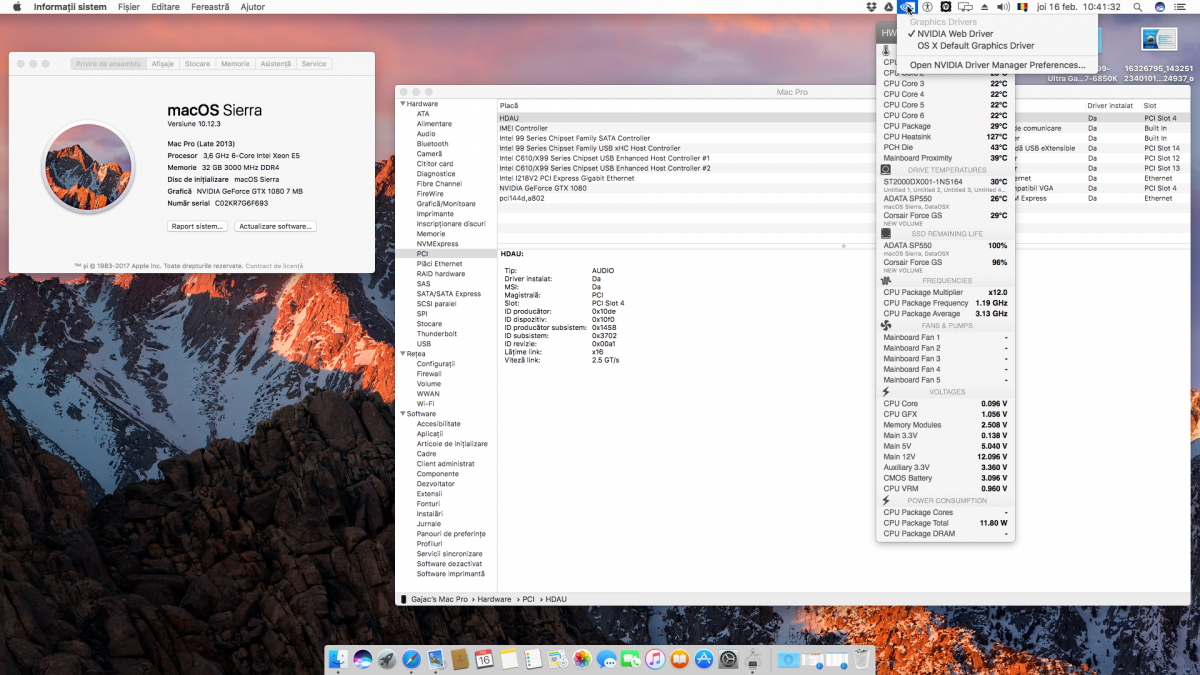

Sygey02 Posted April 13, 2017 Author Share Posted April 13, 2017 Working GTX 1080 on macOS Sierra 10.12.4 1 Link to comment https://www.insanelymac.com/forum/topic/321216-macos-sierra-on-gigabyte-x99-ultra-gaming-cf-i7-6850k/#findComment-2403533 Share on other sites More sharing options...

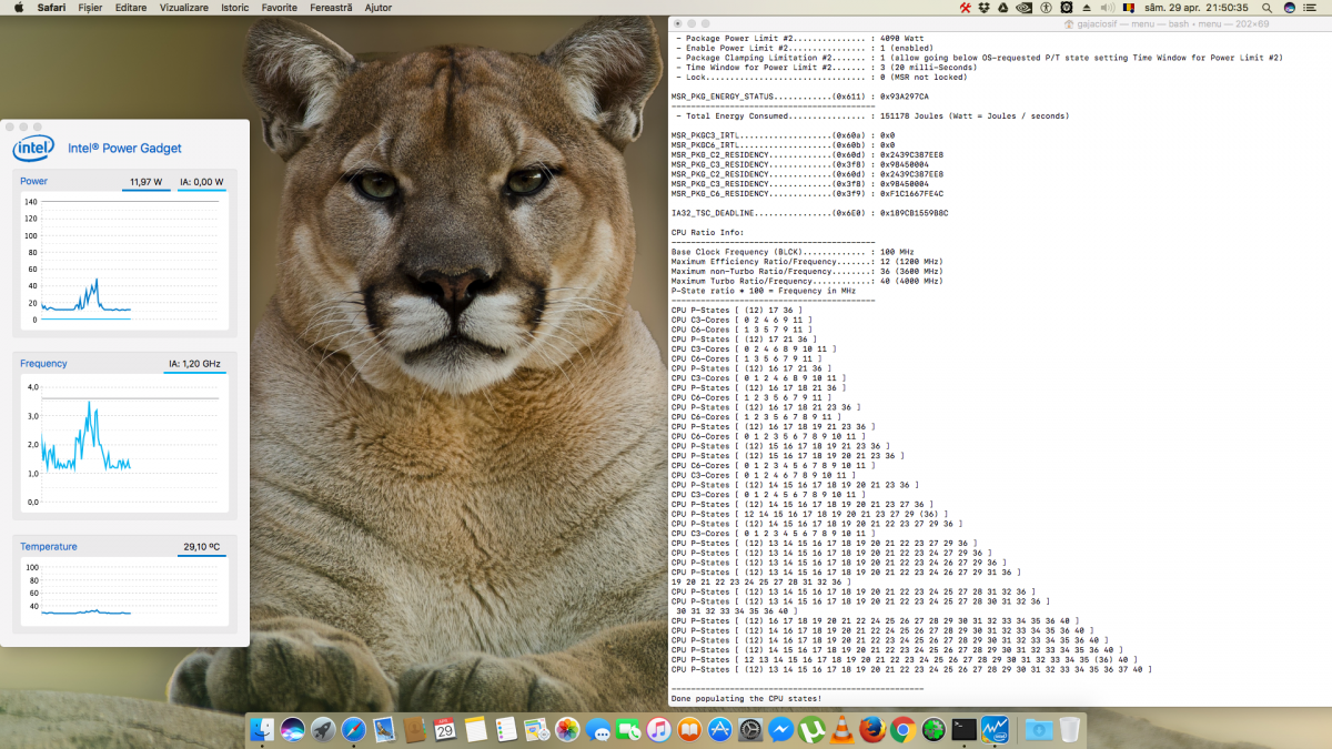

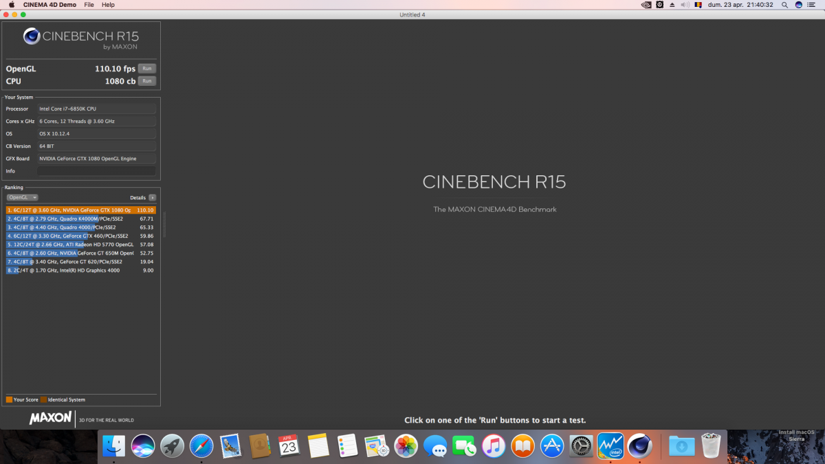

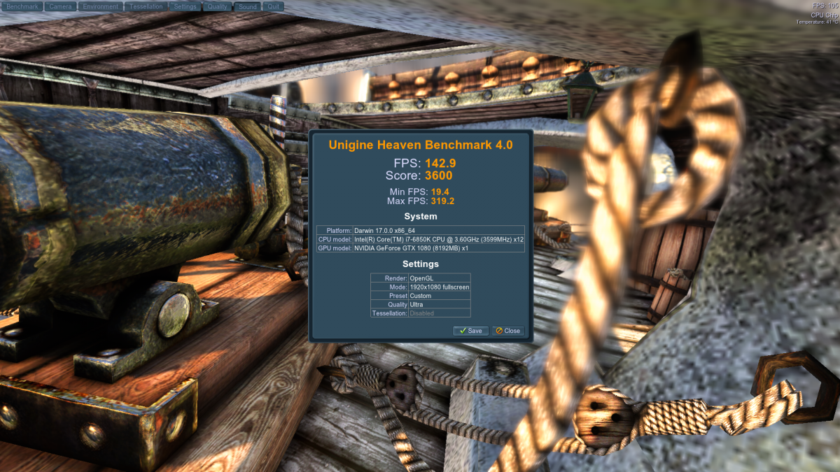

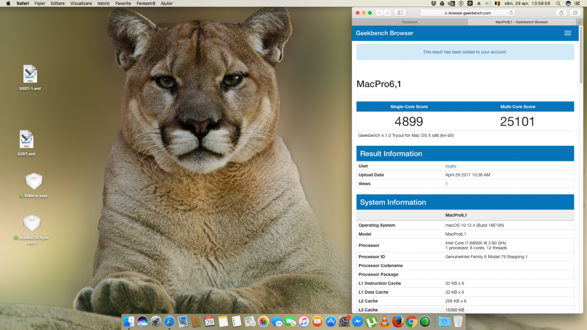

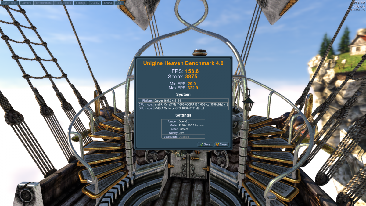

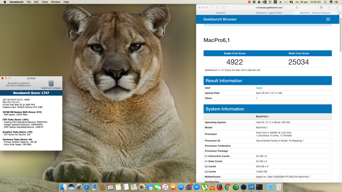

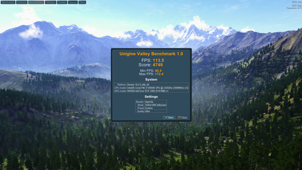

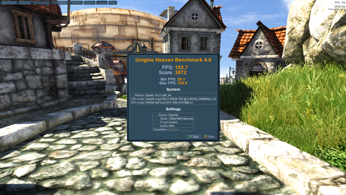

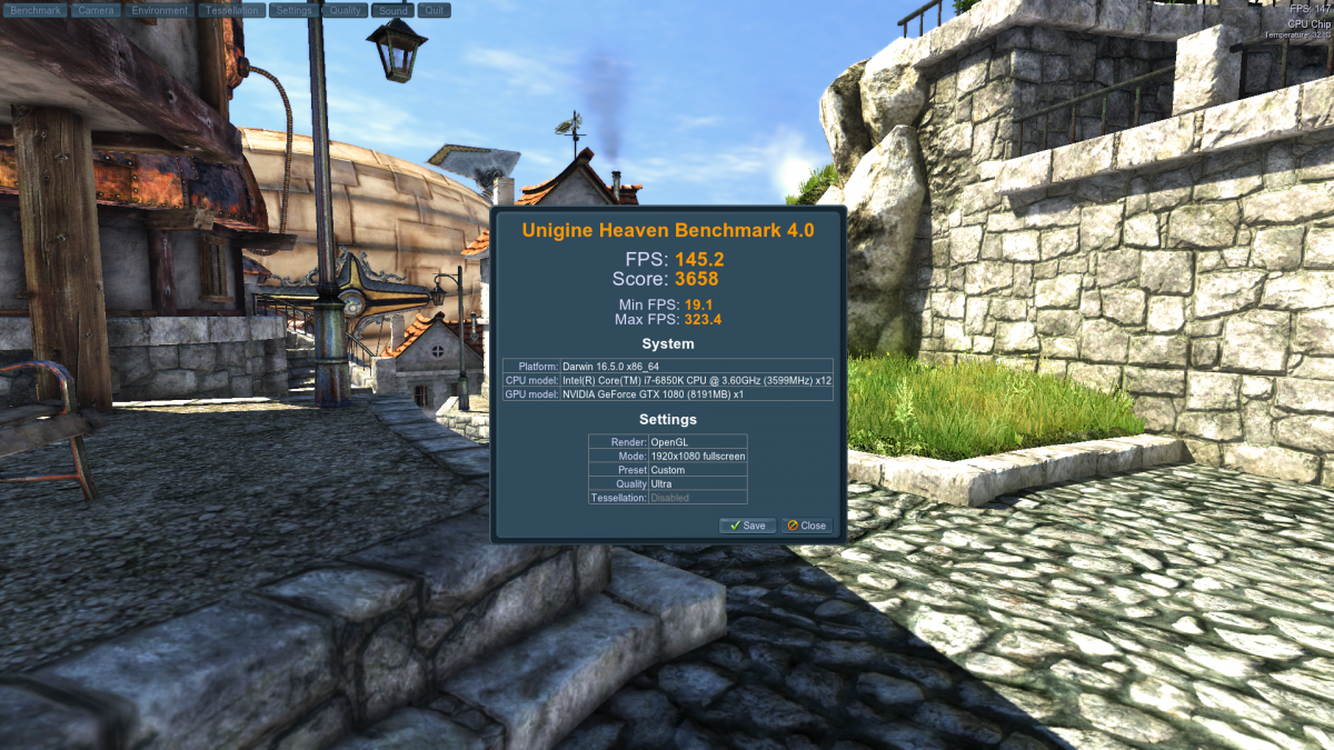

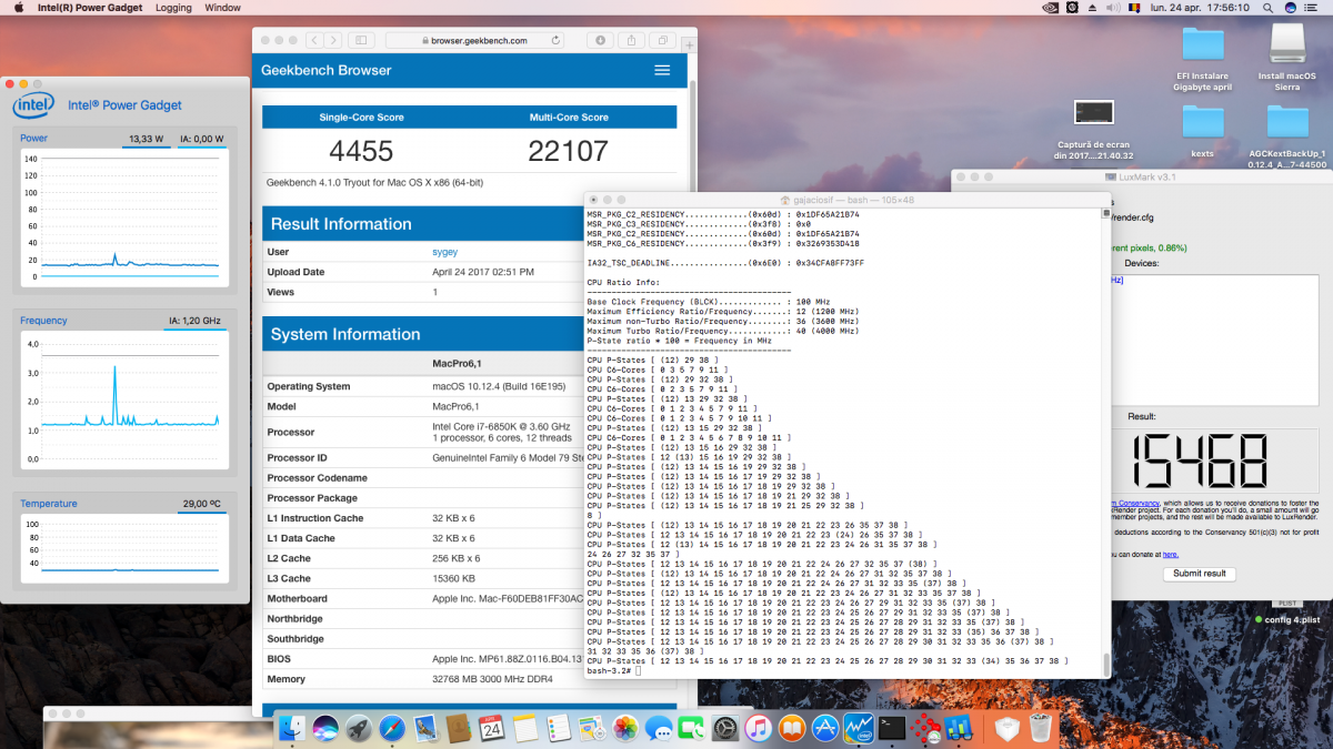

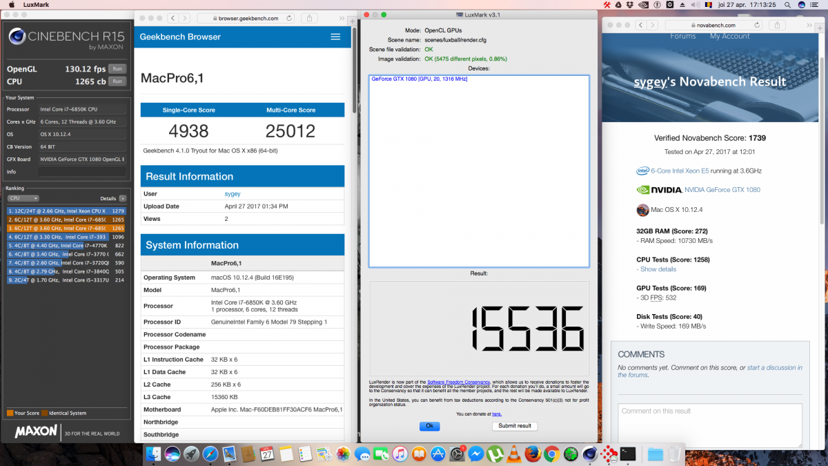

Sygey02 Posted April 24, 2017 Author Share Posted April 24, 2017 Here are some benchmarks of X99 Ultra Gaming CLOVER.zip 1 Link to comment https://www.insanelymac.com/forum/topic/321216-macos-sierra-on-gigabyte-x99-ultra-gaming-cf-i7-6850k/#findComment-2411255 Share on other sites More sharing options...

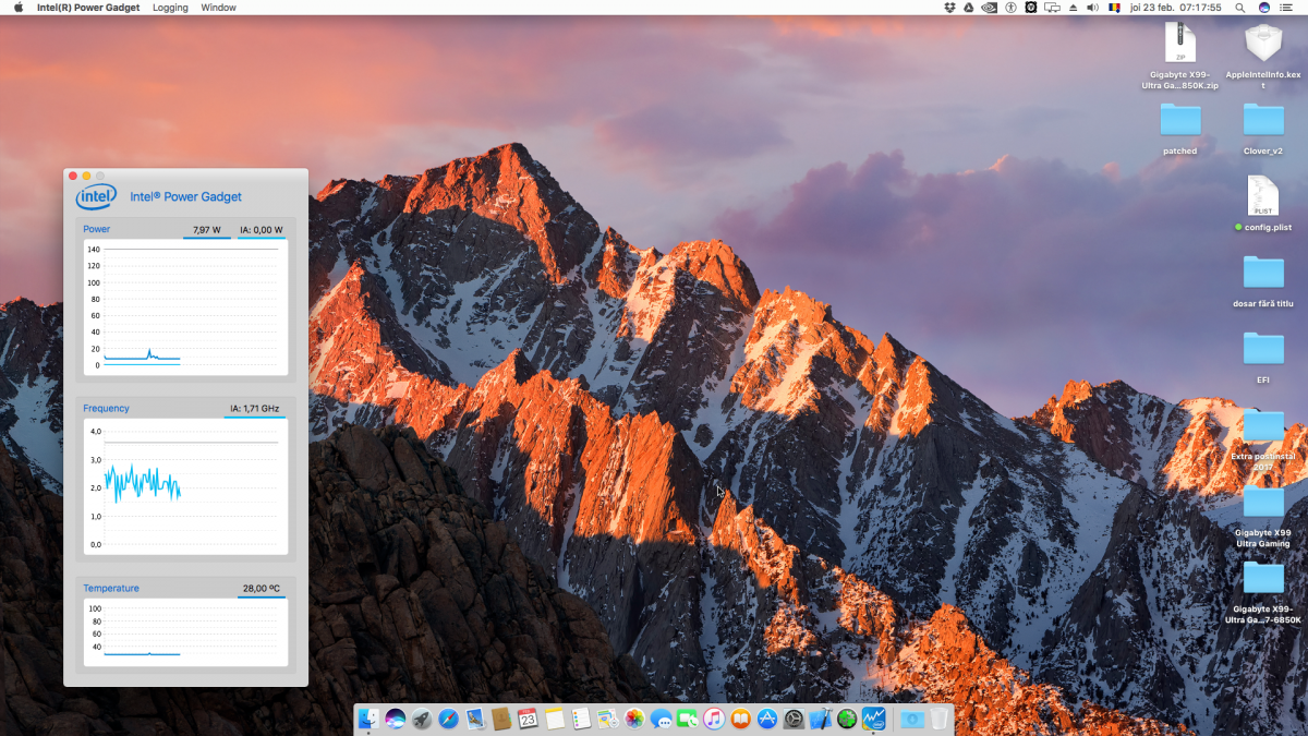

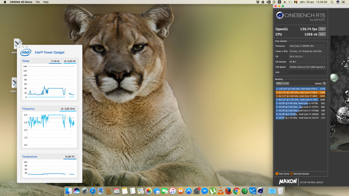

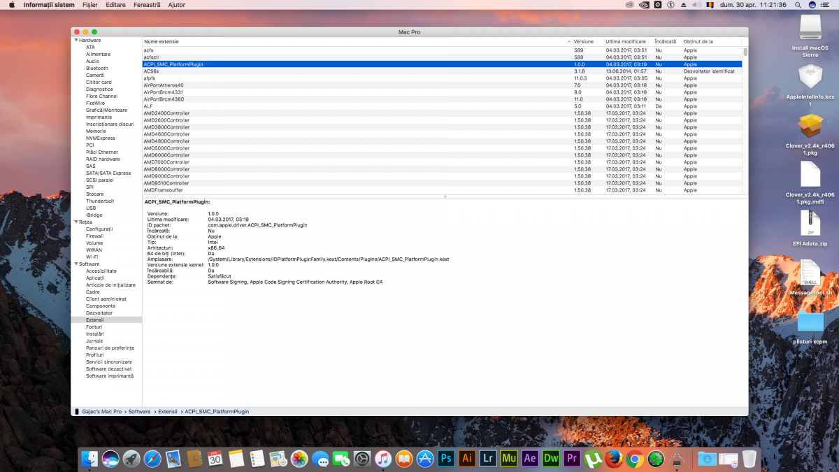

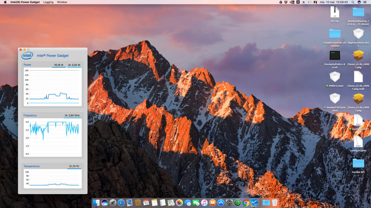

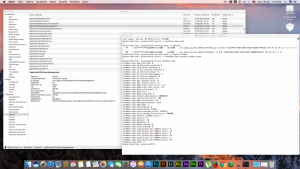

Sygey02 Posted April 27, 2017 Author Share Posted April 27, 2017 Working XCPM Screenshots of GA-X99-Ultra Gaming i7-6850K Overclocked at profile1 4,2 CLOVER.zip Link to comment https://www.insanelymac.com/forum/topic/321216-macos-sierra-on-gigabyte-x99-ultra-gaming-cf-i7-6850k/#findComment-2413275 Share on other sites More sharing options...

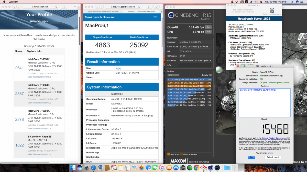

Sygey02 Posted May 10, 2017 Author Share Posted May 10, 2017 . . CLOVER.zip Link to comment https://www.insanelymac.com/forum/topic/321216-macos-sierra-on-gigabyte-x99-ultra-gaming-cf-i7-6850k/#findComment-2421024 Share on other sites More sharing options...

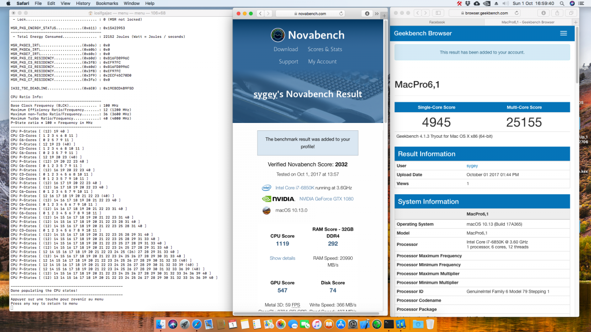

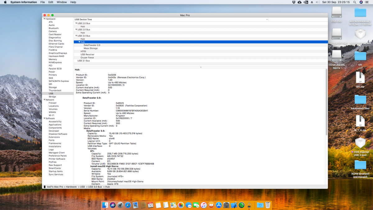

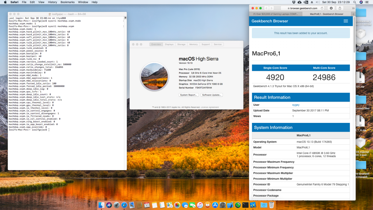

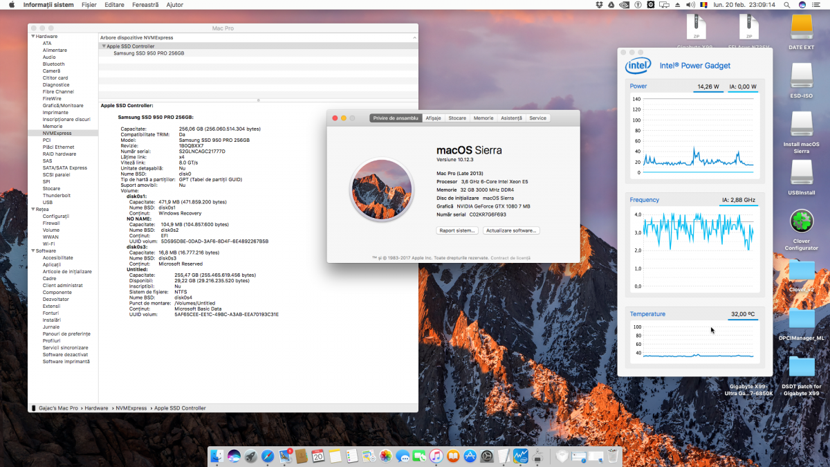

Sygey02 Posted September 30, 2017 Author Share Posted September 30, 2017 Hey bro,i have the same build. Please let me now if working all USB ports and how, and if u try to install High Sierra. i have successful installation on both but i have some problem with Usb's. Thanks. I installed High Sierra without any problems and xcpm works! All USB ports works but I'm pretty shore that not full . I mean I think it works just as usb 2. I not tested! Here are some screens an the files updated! CLOVER.zip 1 Link to comment https://www.insanelymac.com/forum/topic/321216-macos-sierra-on-gigabyte-x99-ultra-gaming-cf-i7-6850k/#findComment-2505625 Share on other sites More sharing options...
apfelnico Posted September 30, 2017 Share Posted September 30, 2017 Use these here. You can edit the info.plist in the kext. Remove all ports you do not need. USBX99.kext.zip 2 Link to comment https://www.insanelymac.com/forum/topic/321216-macos-sierra-on-gigabyte-x99-ultra-gaming-cf-i7-6850k/#findComment-2505680 Share on other sites More sharing options...
nmano Posted September 30, 2017 Share Posted September 30, 2017 Try this In DSDT change XHCI to XHC1 X99_Injector USB 3.kext.zip 1 Link to comment https://www.insanelymac.com/forum/topic/321216-macos-sierra-on-gigabyte-x99-ultra-gaming-cf-i7-6850k/#findComment-2505731 Share on other sites More sharing options...
apfelnico Posted October 1, 2017 Share Posted October 1, 2017 Use the HEX Converter in Clover Configurator and enter the values in DSDT patches (Acpi). My Kext also works, assumes two things ahead: 1. Name of the USB3 device = XHCI (standard in the DSDT) 2. SMBIOS is MacPro6.1 1 Link to comment https://www.insanelymac.com/forum/topic/321216-macos-sierra-on-gigabyte-x99-ultra-gaming-cf-i7-6850k/#findComment-2506504 Share on other sites More sharing options...
