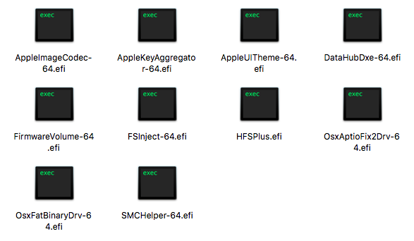

Allan Posted February 12, 2017 Share Posted February 12, 2017 (edited) Hello guys, after getting a great help by RehabMan, finally I can post my steps to use Clover UEFI with hotpatch.My laptop have the following hardware:CPU: i5-3210MVideo: HD 4000Audio: Cx20590Wifi: AR9285Network: Atheros AR8162BIOS: Insyde H2O - 3.7 (5ECN90WW)All OOB, unless Card Reader (yet).My BIOS settings: Boot mode: Legacy Support - This laptop has the UEFI option too, but if I enable it, I don't have the Ethernet port working. Boot priority: UEFI First USB boot: Enabled OS Optimized Defaults: [Other OS] OS X Installation.For install OS X El Capitan, use this guide: Making a 10.10/10.11 USB Installer /w Clover (UEFI and Legacy) the correct way!Clover version: v4003Steps.Look at RehabMan guide about 'hotpatch' for a complete info. Google for it.If you are using 'staticpatch' way, made a backup of the entire EFI/Clover first.Read more about what each Clover patch/resource do in CloverWiki or in Clover v.2 InstructionsMy 'Fixes' in config.plist: <key>Fixes</key> <dict> <key>AddDTGP_0001</key> <true/> <key>AddIMEI_80000</key> <true/> <key>AddPNLF_1000000</key> <true/> <key>FIX_WAK_200000</key> <true/> <key>FixAirport_4000</key> <true/> <key>FixHDA_8000</key> <true/> <key>FixHPET_0010</key> <true/> <key>FixShutdown_0004</key> <true/> My 'Patches': <key>Patches</key> <array> <dict> <key>Comment</key> <string>change EHC1 to EH01</string> <key>Disabled</key> <false/> <key>Find</key> <data> RUhDMQ== </data> <key>Replace</key> <data> RUgwMQ== </data> </dict> <dict> <key>Comment</key> <string>change EHC2 to EH02</string> <key>Disabled</key> <false/> <key>Find</key> <data> RUhDMg== </data> <key>Replace</key> <data> RUgwMg== </data> </dict> <dict> <key>Comment</key> <string>change GFX0 to IGPU</string> <key>Disabled</key> <false/> <key>Find</key> <data> R0ZYMA== </data> <key>Replace</key> <data> SUdQVQ== </data> </dict> <dict> <key>Comment</key> <string>change SAT0 to SATA</string> <key>Disabled</key> <false/> <key>Find</key> <data> U0FUMA== </data> <key>Replace</key> <data> U0FUQQ== </data> </dict> <dict> <key>Comment</key> <string>Rename _DSM to XDSM</string> <key>Disabled</key> <false/> <key>Find</key> <data> X0RTTQ== </data> <key>Replace</key> <data> WERTTQ== </data> </dict> <dict> <key>Comment</key> <string>Change _OSI to XOSI</string> <key>Disabled</key> <false/> <key>Find</key> <data> X09TSQ== </data> <key>Replace</key> <data> WE9TSQ== </data> </dict> <dict> <key>Comment</key> <string>Change Mutex(ABCD,7) to Mutex(ABCD,0)</string> <key>Disabled</key> <false/> <key>Find</key> <data> WwFBQkNEBw== </data> <key>Replace</key> <data> WwFBQkNEAA== </data> </dict> <dict> <key>Comment</key> <string>_Q12 to XQ12</string> <key>Disabled</key> <false/> <key>Find</key> <data> X1ExMgA= </data> <key>Replace</key> <data> WFExMgA= </data> </dict> <dict> <key>Comment</key> <string>_Q11 to XQ11</string> <key>Disabled</key> <false/> <key>Find</key> <data> X1ExMQA= </data> <key>Replace</key> <data> WFExMQA= </data> drivers64UEFI: The files used in Clover/ACPI/patched: Patches.zip For get WiFi working, I use the ProBookAtheros.kext provided by RehabMan. Credits: RehabMan and ahmed_ais Edited March 17, 2017 by Allan Updated - New Clover way. 3 Link to comment https://www.insanelymac.com/forum/topic/321120-guide-lenovo-g480-clover-uefi-hotpatch-1011-updated/ Share on other sites More sharing options...
