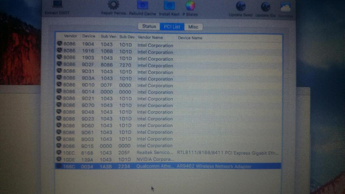

Jolly Posted February 6, 2017 Share Posted February 6, 2017 Intanto fai quel dpcimanager. Non mettere assieme quei due kext. O uno o l'altro. Avevi messo l'ultimo dsdt? Ma nelle istruzioni non c'è niente che riguardi il trackpad? Link to comment https://www.insanelymac.com/forum/topic/320802-primi-problemi-su-asus-k501ux/page/9/#findComment-2363724 Share on other sites More sharing options...
RichieKotzen Posted February 6, 2017 Author Share Posted February 6, 2017 Intanto fai quel dpcimanager. Non mettere assieme quei due kext. O uno o l'altro. Avevi messo l'ultimo dsdt? Ma nelle istruzioni non c'è niente che riguardi il trackpad? ecco.......bhaaaa Link to comment https://www.insanelymac.com/forum/topic/320802-primi-problemi-su-asus-k501ux/page/9/#findComment-2363754 Share on other sites More sharing options...

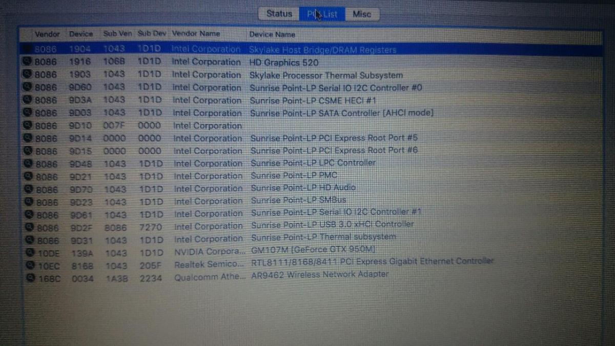

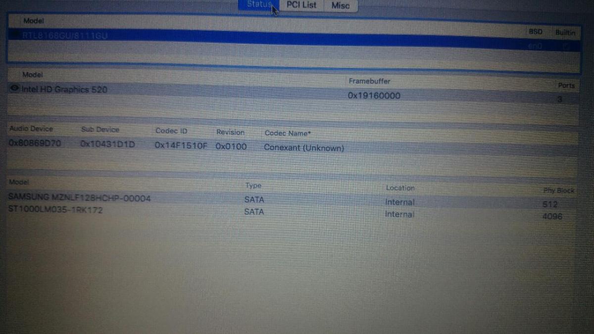

Jolly Posted February 6, 2017 Share Posted February 6, 2017 Devi cliccare su update seed e update id, e posta immagine anche di status Link to comment https://www.insanelymac.com/forum/topic/320802-primi-problemi-su-asus-k501ux/page/9/#findComment-2363804 Share on other sites More sharing options...
RichieKotzen Posted February 6, 2017 Author Share Posted February 6, 2017 ecco Link to comment https://www.insanelymac.com/forum/topic/320802-primi-problemi-su-asus-k501ux/page/9/#findComment-2363808 Share on other sites More sharing options...
Jolly Posted February 6, 2017 Share Posted February 6, 2017 Con l'ultimo DSDT e il solo ApplePS2SmartTouchPad.kext hai provato? Link to comment https://www.insanelymac.com/forum/topic/320802-primi-problemi-su-asus-k501ux/page/9/#findComment-2363811 Share on other sites More sharing options...
RichieKotzen Posted February 6, 2017 Author Share Posted February 6, 2017 Si non va Link to comment https://www.insanelymac.com/forum/topic/320802-primi-problemi-su-asus-k501ux/page/9/#findComment-2363894 Share on other sites More sharing options...
