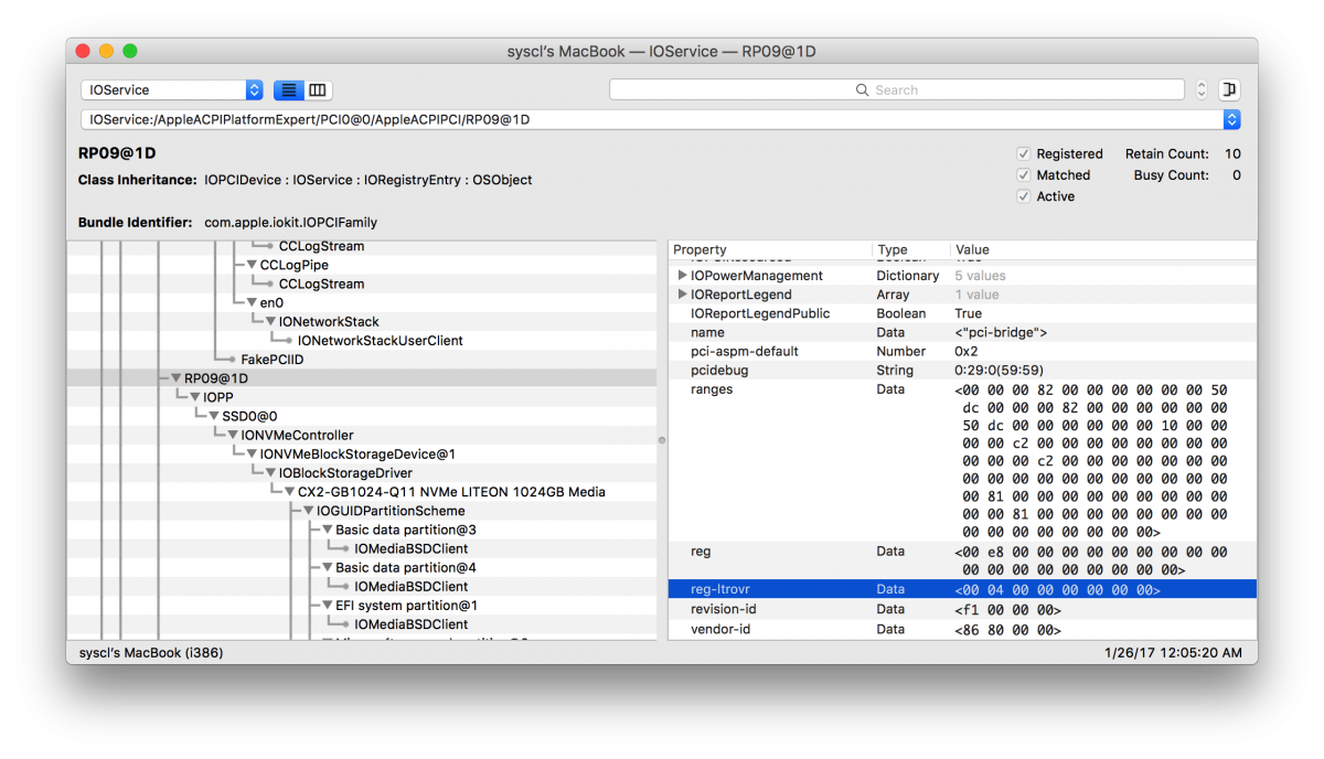

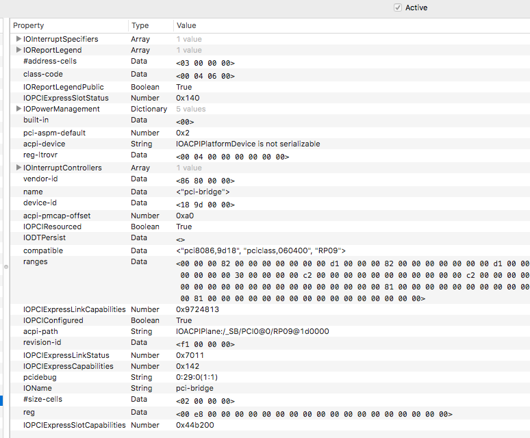

syscl Posted January 26, 2017 Share Posted January 26, 2017 Hello, recently I am trying to figure out what cause the data lose during sleep on XPS 13 9350. Thus a lot friends help me and they lent their new MacBookPro for me to dump some information from their laptops.By comparing the ioreg from their laptops, I found some properties that we miss to inject for our computers. One property I noticed is reg-ltrovr.This property lies in Device(RP01), Device(RP02), Device(RP03), Device(RP04), ... Device(RP13), ... When we inject "reg-ltrovr" as _DSM method, IOPCIFamily.kext will set latency tolerance offset for each of the latency tolerance devices. This could fix some potential issues(still need to explore more evidence).Here's the patch I wrote for my XPS 13 9350, you can tune it if you have more than 13 RP0X devices #Created by syscl #syscl_ltrovr #Inject reg-ltrovr for IOPCIFamily::setLatencyTolerance setting ltrOffset for PCI devices successfully (c) syscl #Tune it if you need #RP01 #Remove _DSM just in case into method label _DSM parent_adr 0x001C0000 remove_entry; into method label XDSM parent_adr 0x001C0000 remove_entry; #Now inject property: setLantencyTolerance for RP01 credit syscl into device name_adr 0x001C0000 insert begin Method (_DSM, 4, NotSerialized)\n {\n If (LEqual (Arg2, Zero))\n {\n Return (Buffer (One)\n {\n 0x03\n })\n }\n Return (Package (0x02)\n {\n "reg-ltrovr", \n Buffer (0x08)\n {\n 0x00, 0x04, 0x00, 0x00, 0x00, 0x00, 0x00, 0x00\n }\n })\n }\n end; #RP02 into method label _DSM parent_adr 0x001C0001 remove_entry; into method label XDSM parent_adr 0x001C0001 remove_entry; #Now inject property: setLantencyTolerance for RP02 credit syscl into device name_adr 0x001C0001 insert begin Method (_DSM, 4, NotSerialized)\n {\n If (LEqual (Arg2, Zero))\n {\n Return (Buffer (One)\n {\n 0x03\n })\n }\n Return (Package (0x02)\n {\n "reg-ltrovr", \n Buffer (0x08)\n {\n 0x00, 0x04, 0x00, 0x00, 0x00, 0x00, 0x00, 0x00\n }\n })\n }\n end; #RP03 into method label _DSM parent_adr 0x001C0002 remove_entry; into method label XDSM parent_adr 0x001C0002 remove_entry; #Now inject property: setLantencyTolerance for RP03 credit syscl into device name_adr 0x001C0002 insert begin Method (_DSM, 4, NotSerialized)\n {\n If (LEqual (Arg2, Zero))\n {\n Return (Buffer (One)\n {\n 0x03\n })\n }\n Return (Package (0x02)\n {\n "reg-ltrovr", \n Buffer (0x08)\n {\n 0x00, 0x04, 0x00, 0x00, 0x00, 0x00, 0x00, 0x00\n }\n })\n }\n end; #RP04 into method label _DSM parent_adr 0x001C0003 remove_entry; into method label XDSM parent_adr 0x001C0003 remove_entry; #Now inject property: setLantencyTolerance for RP04 credit syscl into device name_adr 0x001C0003 insert begin Method (_DSM, 4, NotSerialized)\n {\n If (LEqual (Arg2, Zero))\n {\n Return (Buffer (One)\n {\n 0x03\n })\n }\n Return (Package (0x02)\n {\n "reg-ltrovr", \n Buffer (0x08)\n {\n 0x00, 0x04, 0x00, 0x00, 0x00, 0x00, 0x00, 0x00\n }\n })\n }\n end; #RP05 into method label _DSM parent_adr 0x001C0004 remove_entry; into method label XDSM parent_adr 0x001C0004 remove_entry; #Now inject property: setLantencyTolerance for RP05 credit syscl into device name_adr 0x001C0004 insert begin Method (_DSM, 4, NotSerialized)\n {\n If (LEqual (Arg2, Zero))\n {\n Return (Buffer (One)\n {\n 0x03\n })\n }\n Return (Package (0x02)\n {\n "reg-ltrovr", \n Buffer (0x08)\n {\n 0x00, 0x04, 0x00, 0x00, 0x00, 0x00, 0x00, 0x00\n }\n })\n }\n end; #RP06 into method label _DSM parent_adr 0x001C0005 remove_entry; into method label XDSM parent_adr 0x001C0005 remove_entry; #Now inject property: setLantencyTolerance for RP06 credit syscl into device name_adr 0x001C0005 insert begin Method (_DSM, 4, NotSerialized)\n {\n If (LEqual (Arg2, Zero))\n {\n Return (Buffer (One)\n {\n 0x03\n })\n }\n Return (Package (0x02)\n {\n "reg-ltrovr", \n Buffer (0x08)\n {\n 0x00, 0x04, 0x00, 0x00, 0x00, 0x00, 0x00, 0x00\n }\n })\n }\n end; #RP07 into method label _DSM parent_adr 0x001C0006 remove_entry; into method label XDSM parent_adr 0x001C0006 remove_entry; #Now inject property: setLantencyTolerance for RP07 credit syscl into device name_adr 0x001C0006 insert begin Method (_DSM, 4, NotSerialized)\n {\n If (LEqual (Arg2, Zero))\n {\n Return (Buffer (One)\n {\n 0x03\n })\n }\n Return (Package (0x02)\n {\n "reg-ltrovr", \n Buffer (0x08)\n {\n 0x00, 0x04, 0x00, 0x00, 0x00, 0x00, 0x00, 0x00\n }\n })\n }\n end; #RP08 into method label _DSM parent_adr 0x001C0007 remove_entry; into method label XDSM parent_adr 0x001C0007 remove_entry; #Now inject property: setLantencyTolerance for RP08 credit syscl into device name_adr 0x001C0007 insert begin Method (_DSM, 4, NotSerialized)\n {\n If (LEqual (Arg2, Zero))\n {\n Return (Buffer (One)\n {\n 0x03\n })\n }\n Return (Package (0x02)\n {\n "reg-ltrovr", \n Buffer (0x08)\n {\n 0x00, 0x04, 0x00, 0x00, 0x00, 0x00, 0x00, 0x00\n }\n })\n }\n end; #RP09 into method label _DSM parent_adr 0x001D0000 remove_entry; into method label XDSM parent_adr 0x001D0000 remove_entry; #Now inject property: setLantencyTolerance for RP09 credit syscl into device name_adr 0x001D0000 insert begin Method (_DSM, 4, NotSerialized)\n {\n If (LEqual (Arg2, Zero))\n {\n Return (Buffer (One)\n {\n 0x03\n })\n }\n Return (Package (0x02)\n {\n "reg-ltrovr", \n Buffer (0x08)\n {\n 0x00, 0x04, 0x00, 0x00, 0x00, 0x00, 0x00, 0x00\n }\n })\n }\n end; #RP10 into method label _DSM parent_adr 0x001D0001 remove_entry; into method label XDSM parent_adr 0x001D0001 remove_entry; #Now inject property: setLantencyTolerance for RP10 credit syscl into device name_adr 0x001D0001 insert begin Method (_DSM, 4, NotSerialized)\n {\n If (LEqual (Arg2, Zero))\n {\n Return (Buffer (One)\n {\n 0x03\n })\n }\n Return (Package (0x02)\n {\n "reg-ltrovr", \n Buffer (0x08)\n {\n 0x00, 0x04, 0x00, 0x00, 0x00, 0x00, 0x00, 0x00\n }\n })\n }\n end; #RP11 into method label _DSM parent_adr 0x001D0002 remove_entry; into method label XDSM parent_adr 0x001D0002 remove_entry; #Now inject property: setLantencyTolerance for RP11 credit syscl into device name_adr 0x001D0002 insert begin Method (_DSM, 4, NotSerialized)\n {\n If (LEqual (Arg2, Zero))\n {\n Return (Buffer (One)\n {\n 0x03\n })\n }\n Return (Package (0x02)\n {\n "reg-ltrovr", \n Buffer (0x08)\n {\n 0x00, 0x04, 0x00, 0x00, 0x00, 0x00, 0x00, 0x00\n }\n })\n }\n end; #RP12 into method label _DSM parent_adr 0x001D0003 remove_entry; into method label XDSM parent_adr 0x001D0003 remove_entry; #Now inject property: setLantencyTolerance for RP12 credit syscl into device name_adr 0x001D0003 insert begin Method (_DSM, 4, NotSerialized)\n {\n If (LEqual (Arg2, Zero))\n {\n Return (Buffer (One)\n {\n 0x03\n })\n }\n Return (Package (0x02)\n {\n "reg-ltrovr", \n Buffer (0x08)\n {\n 0x00, 0x04, 0x00, 0x00, 0x00, 0x00, 0x00, 0x00\n }\n })\n }\n end; #RP13 into method label _DSM parent_adr 0x001D0004 remove_entry; into method label XDSM parent_adr 0x001D0004 remove_entry; #Now inject property: setLantencyTolerance for RP13 credit syscl into device name_adr 0x001D0004 insert begin Method (_DSM, 4, NotSerialized)\n {\n If (LEqual (Arg2, Zero))\n {\n Return (Buffer (One)\n {\n 0x03\n })\n }\n Return (Package (0x02)\n {\n "reg-ltrovr", \n Buffer (0x08)\n {\n 0x00, 0x04, 0x00, 0x00, 0x00, 0x00, 0x00, 0x00\n }\n })\n }\n end; Once you finished inject this property successfully, ioreg will give the following resultGood luck,syscl 5 Link to comment https://www.insanelymac.com/forum/topic/320561-enable-iopcifamily-to-set-tolerance-latency-for-pci-devices/ Share on other sites More sharing options...

syscl Posted January 26, 2017 Author Share Posted January 26, 2017 This patch it's only for new Hardware? E.g: Skylake and above? I have only 8 RP0x entries... Hi @Allan, this patch can be applied to other platform as well. I saw MacBookAir6,2 has this property as well[see evidence here]. 8 RP0x is OK, I just added more RP0X devices for more general cases. You can just apply it and see if this patch work or not. Thank you, syscl 1 Link to comment https://www.insanelymac.com/forum/topic/320561-enable-iopcifamily-to-set-tolerance-latency-for-pci-devices/#findComment-2357556 Share on other sites More sharing options...
Sherlocks Posted February 2, 2017 Share Posted February 2, 2017 good i checked skylake mbp13,1's ioreg like you said, there is reg-ltrovr i applied this in my laptop thank you add. i remove "reg-ltrovr" because after wakeup, wifi device load is slow. also cause system unstable. i exprienced force reboot. 1 Link to comment https://www.insanelymac.com/forum/topic/320561-enable-iopcifamily-to-set-tolerance-latency-for-pci-devices/#findComment-2361236 Share on other sites More sharing options...
syscl Posted February 3, 2017 Author Share Posted February 3, 2017 good i checked skylake mbp13,1's ioreg like you said, there is reg-ltrovr i applied this in my laptop 스크린샷 2017-02-02 오후 3.51.34.png thank you add. i remove "reg-ltrovr" because after wakeup, wifi device load is slow. also cause system unstable. i exprienced force reboot. Thank you @Sherlock, thank you for your report about this important issue. Actually not only MBP13,1 has reg-ltrovr, but also MacBookAir6,2 has. Thus, I think this property must be included early than we imagine. I will test this property on Dell Precision M3800 as well. Thank you, syscl Link to comment https://www.insanelymac.com/forum/topic/320561-enable-iopcifamily-to-set-tolerance-latency-for-pci-devices/#findComment-2362131 Share on other sites More sharing options...
Bungo Posted April 2, 2017 Share Posted April 2, 2017 Thank you @Sherlock, thank you for your report about this important issue. Actually not only MBP13,1 has reg-ltrovr, but also MacBookAir6,2 has. Thus, I think this property must be included early than we imagine. I will test this property on Dell Precision M3800 as well. Thank you, syscl Hi, Why not to use original code?: /*** Our _DSM if exists ***/ Method (_DSM, 4, NotSerialized) { Store (Package (0x04) /* increased by 2 */ { "built-in", Buffer (One) { Zero }, /* * * *********** new code *********/ "reg-ltrovr", Buffer (0x08) { /* 0000 */ 0x00, 0x04, 0x00, 0x00, 0x00, 0x00, 0x00, 0x00 } /*****************************/ }, Local0) DTGP (Arg0, Arg1, Arg2, Arg3, RefOf (Local0)) Return (Local0) } Older systems (chipsets) may not support Latency Tolerance Reporting (LTR) mechanism. Ref. e.g. IOPCIFamily-196.3, 5-chipset-3400-chipset-datasheet, 200-series-chipset-pch-datasheet-vol-1 and 200-series-chipset-pch-datasheet-vol-2. 1 Link to comment https://www.insanelymac.com/forum/topic/320561-enable-iopcifamily-to-set-tolerance-latency-for-pci-devices/#findComment-2397054 Share on other sites More sharing options...
syscl Posted April 3, 2017 Author Share Posted April 3, 2017 Hi, Why not to use original code?: /*** Our _DSM if exists ***/ Method (_DSM, 4, NotSerialized) { Store (Package (0x04) /* increased by 2 */ { "built-in", Buffer (One) { Zero }, /* * * *********** new code *********/ "reg-ltrovr", Buffer (0x08) { /* 0000 */ 0x00, 0x04, 0x00, 0x00, 0x00, 0x00, 0x00, 0x00 } /*****************************/ }, Local0) DTGP (Arg0, Arg1, Arg2, Arg3, RefOf (Local0)) Return (Local0) } Older systems (chipsets) may not support Latency Tolerance Reporting (LTR) mechanism. Ref. e.g. IOPCIFamily-196.3, 5-chipset-3400-chipset-datasheet, 200-series-chipset-pch-datasheet-vol-1 and 200-series-chipset-pch-datasheet-vol-2. Thank you, Do you mean use original DTGP method? syscl Link to comment https://www.insanelymac.com/forum/topic/320561-enable-iopcifamily-to-set-tolerance-latency-for-pci-devices/#findComment-2397693 Share on other sites More sharing options...
