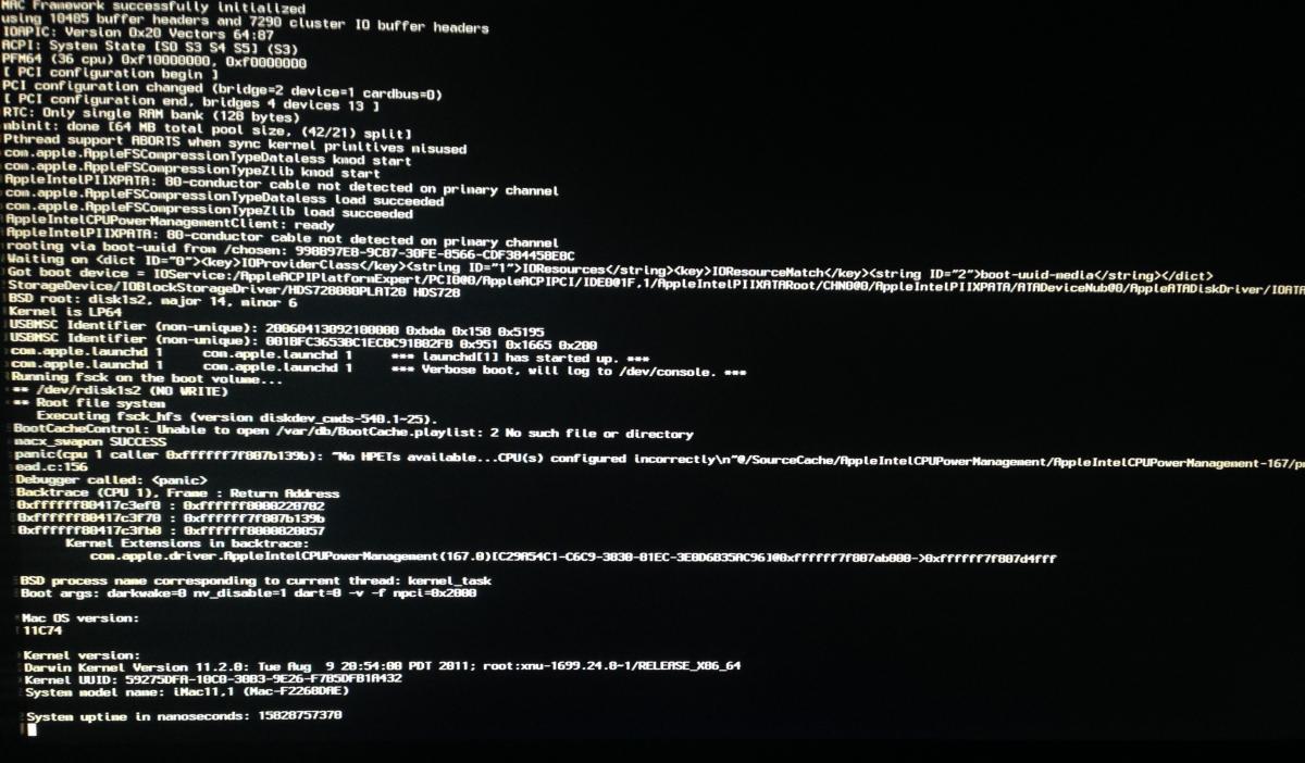

melamangiata Posted January 22, 2017 Share Posted January 22, 2017 Hello everyone i'm trying to install osx Lion on my old pc, this are the specs: ASUS P5LD2 rev 2.01G CPU Intel Core2Duo E6700 2 GB RAM DDR2 80GB IDE HDD ATI 5450 I have created the usb stick with pandora's box and i choosed enoch bootloader. i had successfully installed Lion, but now i can't boot up the system, i'm stuck in this error. Can anyone help me? Thank you guys. Link to comment https://www.insanelymac.com/forum/topic/320405-osx-installation-on-asus-p5ld2/ Share on other sites More sharing options...
MaLd0n Posted January 22, 2017 Share Posted January 22, 2017 use it NullCPUPowerManagement.kext.zip use fakesmc too after instal, send me ur dsdt. Link to comment https://www.insanelymac.com/forum/topic/320405-osx-installation-on-asus-p5ld2/#findComment-2354697 Share on other sites More sharing options...
melamangiata Posted January 22, 2017 Author Share Posted January 22, 2017 Thankyou for your quick replay. I have copied your kext in my usb installer. I don't use DSDT at the moment. I have no idea what kind of dsdt i can use. Do you have any suggestion? Link to comment https://www.insanelymac.com/forum/topic/320405-osx-installation-on-asus-p5ld2/#findComment-2354715 Share on other sites More sharing options...

melamangiata Posted January 23, 2017 Author Share Posted January 23, 2017 I'm trying with attached dsdt found in the third post of http://www.insanelymac.com/forum/topic/271857-p5ld2-no-vm-or-se/ but no luck, i have pci config error. I copied dsdt in extra folder of usb EFI partition. if i remove the dsdt i come back with the first error, something related of cpu power menagment dsdt.aml.zip Link to comment https://www.insanelymac.com/forum/topic/320405-osx-installation-on-asus-p5ld2/#findComment-2355599 Share on other sites More sharing options...
MaLd0n Posted January 23, 2017 Share Posted January 23, 2017 the topic is same mobo? same bios version? not a good idea. Remove dsdt, reboot and extract original. Lion have a old bug with arch-i386 try bootsystem in 64 bit Link to comment https://www.insanelymac.com/forum/topic/320405-osx-installation-on-asus-p5ld2/#findComment-2355633 Share on other sites More sharing options...

MaLd0n Posted January 25, 2017 Share Posted January 25, 2017 i only use clover now, amazin' bootloader, but if u use clover in lion use disabler.kext inside clover kext folder Link to comment https://www.insanelymac.com/forum/topic/320405-osx-installation-on-asus-p5ld2/#findComment-2356914 Share on other sites More sharing options...
