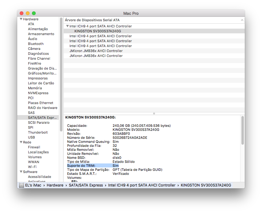

MaLd0n Posted December 20, 2016 Share Posted December 20, 2016 remove all and use only one use Clover Configurator Work fine Name IOAHCIBlockStorage Find 4150504C452053534400 Replace 00000000000000000000 Comment TRIM function for non-Apple SSDs 1 Link to comment Share on other sites More sharing options...

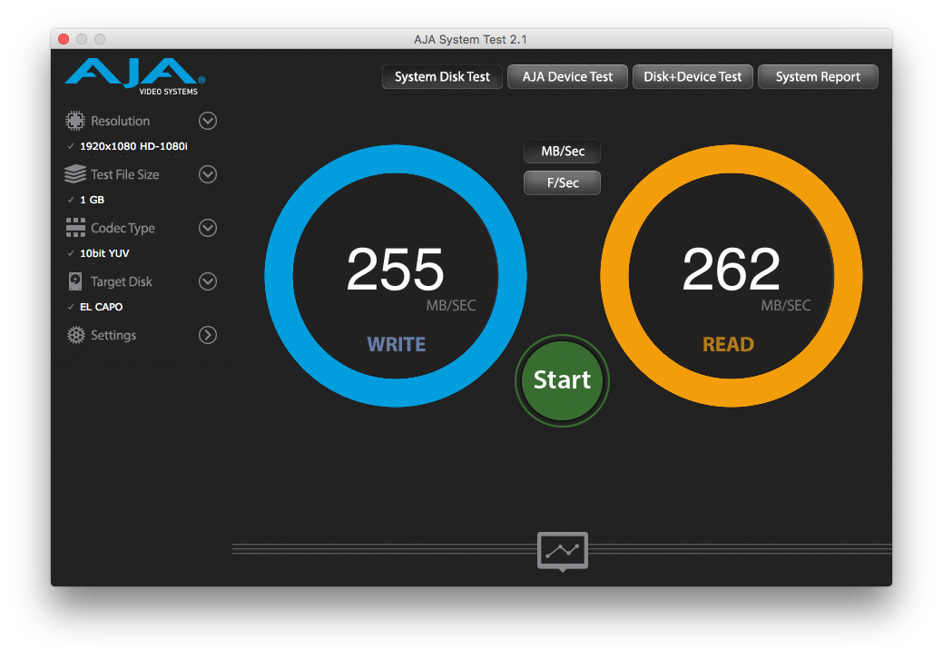

MaLd0n Posted December 20, 2016 Share Posted December 20, 2016 Yes, but is great too. My SATA 3 HD in SATA 3 port write 109 MB/SEC. My SSD in SATA 2 port... amazing as usual 1 Link to comment Share on other sites More sharing options...
