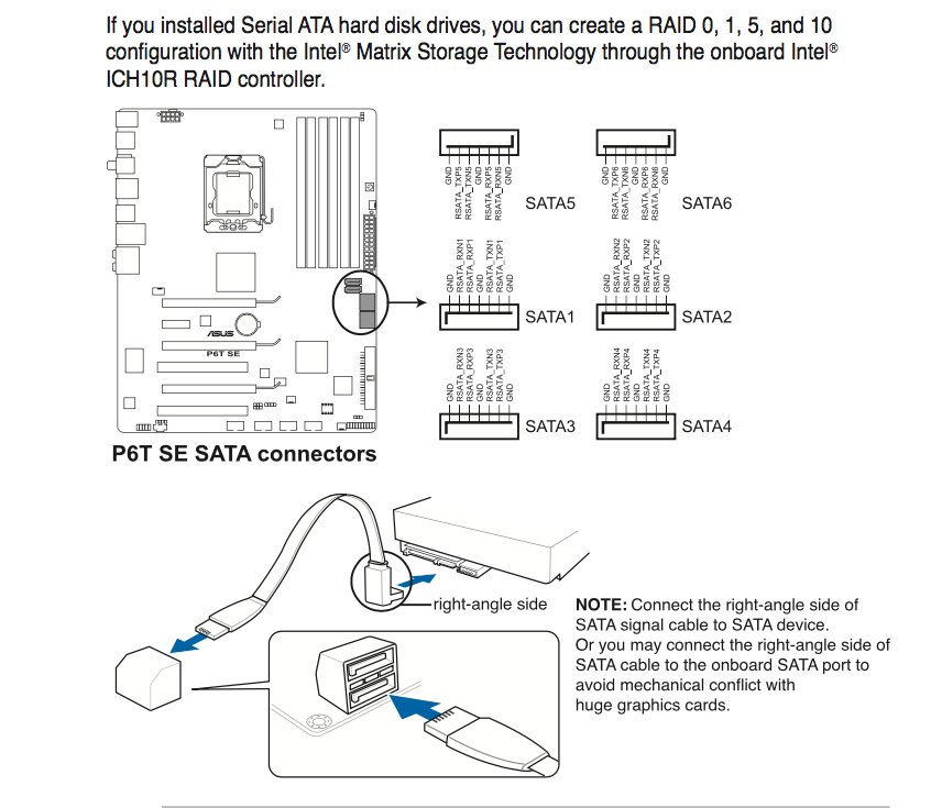

Jolly Posted October 31, 2016 Share Posted October 31, 2016 Ti ho chiesto su quali porte sono collegati gli HDD e non mi hai risposto. Guarda l'immagine tratta dal manuale della tua MB e sappimi dire. Poi prova anche a cambiare connettore. HDD OSX mettilo sempre sulla 1 Link to comment https://www.insanelymac.com/forum/topic/317409-clover-e-windows/page/2/#findComment-2311468 Share on other sites More sharing options...
guitar1966 Posted October 31, 2016 Author Share Posted October 31, 2016 al post 24 ti ho risposto , non mancherei mai di rispetto a chi aiuta gli altri. Link to comment https://www.insanelymac.com/forum/topic/317409-clover-e-windows/page/2/#findComment-2311483 Share on other sites More sharing options...
Jolly Posted October 31, 2016 Share Posted October 31, 2016 Prova mettere osx sul primo e win sul secondo, tutto il resto staccato Link to comment https://www.insanelymac.com/forum/topic/317409-clover-e-windows/page/2/#findComment-2311486 Share on other sites More sharing options...
