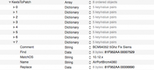

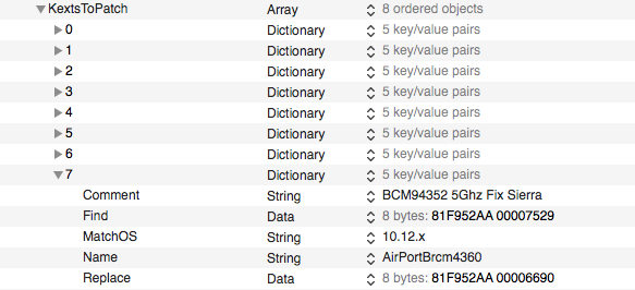

krbuck Posted October 11, 2016 Author Share Posted October 11, 2016 That was very helpful. Thanks. Does this look ok? Is it as simple as dropping this updated config.plist into EFI/Clover, crossing my fingers and rebooting? Thanks! Link to comment https://www.insanelymac.com/forum/topic/316633-broadcom-bcm94352hmb-kext-newbie-needs-some-help/#findComment-2297718 Share on other sites More sharing options...
artur_pt Posted October 11, 2016 Share Posted October 11, 2016 hello i think so remember disable sip and restart several times .. to update the cache .. the patch only be apply if ur kext are in cache or term sudo touch /System/Library/Extensions maybe u need also FakePCIID_Broadcom_WiFi.kext (formerly FakePCIID_BCM94352Z_as_BCM94360CS2.kext) https://bitbucket.org/RehabMan/os-x-fake-pci-id good hack 1 Link to comment https://www.insanelymac.com/forum/topic/316633-broadcom-bcm94352hmb-kext-newbie-needs-some-help/#findComment-2297745 Share on other sites More sharing options...
