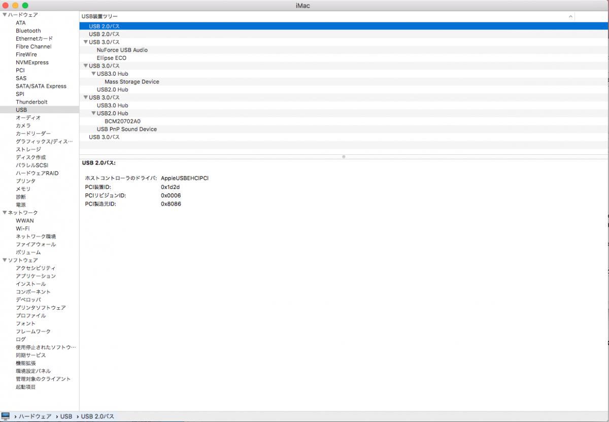

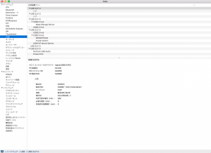

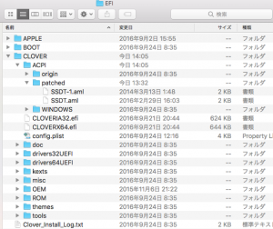

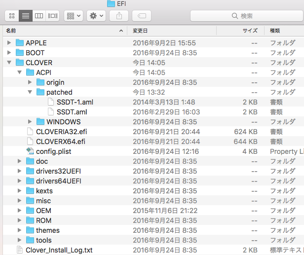

HackerKitty Posted September 30, 2016 Author Share Posted September 30, 2016 I finally solved it! One forum member kindly pointed out a file from this site: http://www.rampagedev.com/?page_id=48 I found SSDT.aml files for ASUS P9X79 WS and Core i7 4930K there. All I did was just copy those 2 files under CLOVER/ACPI/patched That was it! There is still no DSDT.aml there. Just those 2 files (SSDT.aml, SSDT-1.aml) Now all my onboard USB ports (2.0/3.0) are working as well as external PCIe USB 3.0. I now have over 20 USB ports - perhaps a little too much but much better than not enough 2 Link to comment https://www.insanelymac.com/forum/topic/316168-help-i-lost-my-appleusbxhcipcikext-and-all-usb-2-ports/#findComment-2289583 Share on other sites More sharing options...
