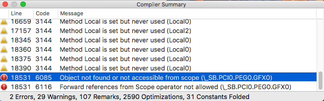

SavageAUS Posted November 5, 2016 Share Posted November 5, 2016 How did you solve the error with your dsdt when renaming GFX0 -> IGPU? Can you please extract tables with linux? Guide taken from HERE Credit @RehabMan Extracting with Linux:In Linux, the native ACPI files are available directly from the file system. You can find them at /sys/firmware/acpi/tables and /sys/firmware/acpi/tables/dynamic. It is possible to copy the entire set with a single command in Terminal.It is not necessary to install Linux. Simply run it from USB: http://www.ubuntu.com/download/desktop/create-a-usb-stick-on-windows.In Linux Terminal: Code (Text): # substitute DEST with the mountpoint of a FAT32 formatted USB sticksudo cp -R /sys/firmware/acpi/tables DEST You should copy the files to a FAT32 formatted USB. Using FAT32 avoids permissions issues as FAT32 has no file permissions. The value of DEST for an auto-mounted USB will depend on the version of Linux you're using and how you booted it. You can see the mount-point by typing 'mount' in Terminal, or hover your mouse over the volume name in the Linux file explorer. Link to comment https://www.insanelymac.com/forum/topic/315721-please-help-with-install-el-capitan-asus-k53e-laptop/page/2/#findComment-2314138 Share on other sites More sharing options...

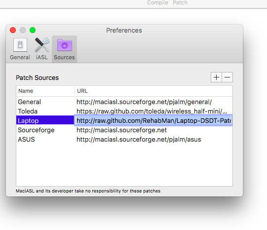

makk Posted November 5, 2016 Author Share Posted November 5, 2016 How did you solve the error with your dsdt when renaming GFX0 -> IGPU? Can you please extract tables with linux? Guide taken from HERE Credit @RehabMan Extracting with Linux: In Linux, the native ACPI files are available directly from the file system. You can find them at /sys/firmware/acpi/tables and /sys/firmware/acpi/tables/dynamic. It is possible to copy the entire set with a single command in Terminal. It is not necessary to install Linux. Simply run it from USB: http://www.ubuntu.com/download/desktop/create-a-usb-stick-on-windows. In Linux Terminal: Code (Text): # substitute DEST with the mountpoint of a FAT32 formatted USB stick sudo cp -R /sys/firmware/acpi/tables DEST You should copy the files to a FAT32 formatted USB. Using FAT32 avoids permissions issues as FAT32 has no file permissions. The value of DEST for an auto-mounted USB will depend on the version of Linux you're using and how you booted it. You can see the mount-point by typing 'mount' in Terminal, or hover your mouse over the volume name in the Linux file explorer. I use the Rename Patch from the repository a Rehabmans. http://raw.github.com/RehabMan/Laptop-DSDT-Patch/master. copy this into your MacIASL preferences. the rename is there GFX0 to IGPU Mak Link to comment https://www.insanelymac.com/forum/topic/315721-please-help-with-install-el-capitan-asus-k53e-laptop/page/2/#findComment-2314162 Share on other sites More sharing options...
SavageAUS Posted November 5, 2016 Share Posted November 5, 2016 I use the Rename Patch from the repository a Rehabmans. http://raw.github.com/RehabMan/Laptop-DSDT-Patch/master. copy this into your MacIASL preferences. the rename is there GFX0 to IGPU Mak Yeah I did the rename but it creates errors. Sent from my SM-G930F using Tapatalk Link to comment https://www.insanelymac.com/forum/topic/315721-please-help-with-install-el-capitan-asus-k53e-laptop/page/2/#findComment-2314174 Share on other sites More sharing options...
