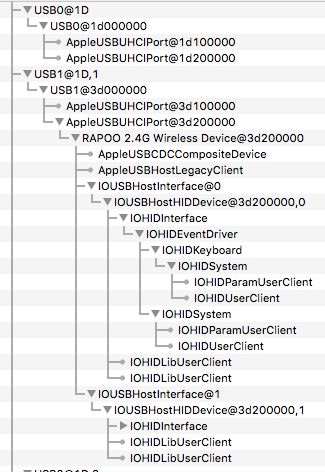

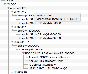

Javmain Posted September 11, 2016 Share Posted September 11, 2016 This is ausu F83vf dsdt, and install os x 11.10.the usb is not work.please help me. thanks. I had read this article http://www.insanelymac.com/forum/topic/306777-guide-usb-fix-el-capitan-1011/ and try to fix my error, but i can't find EHC1 and EHC2 in my dsdt file. I'm so confused. Please help me. this is my usb; and this is my extracted linux dsdt file LinuxDSDT.zip and this is my rename aml file: acpi.zip and executed command (iasl -da -dl *.aml) and I get those files; dsl.zip Quote Link to comment https://www.insanelymac.com/forum/topic/315114-im-a-newer-someone-can-help-me-fix-my-dsdt-for-usb20thinks/ Share on other sites More sharing options...

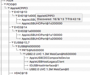

Javmain Posted September 13, 2016 Author Share Posted September 13, 2016 Hi ,Hervé. I have used the modify file.I'm sorry. It does't work. and i find this. I am not sure it work. 1. DTGP Method 2. EHCI1/2 Devices Device (EHC1) { Name (_ADR, 0x001D0007) // _ADR: Address Name (_PRW, Package (0x02) { // _PRW: Power Resources for Wake 0x0D, 0x03 }) Method (_DSM, 4, NotSerialized) { // _DSM: Device-Specific Method Store (Package (0x04) { "device-id", Buffer (0x04) { 0x3C, 0x3A, 0x00, 0x00 /* <:.. */ }, "AAPL,clock-id", Buffer (One) { 0x01 /* . */ } }, Local0) DTGP (Arg0, Arg1, Arg2, Arg3, RefOf (Local0)) Return (Local0) } } Device (EHC2) { Name (_ADR, 0x001A0007) // _ADR: Address Name (_PRW, Package (0x02) { // _PRW: Power Resources for Wake 0x0D, 0x03 }) Method (_DSM, 4, NotSerialized) { // _DSM: Device-Specific Method Store (Package (0x04) { "device-id", Buffer (0x04) { 0x3C, 0x3A, 0x00, 0x00 /* <:.. */ }, "AAPL,clock-id", Buffer (One) { 0x01 /* . */ } }, Local0) DTGP (Arg0, Arg1, Arg2, Arg3, RefOf (Local0)) Return (Local0) } } and "0x001A0007" is point to EHC2. Quote Link to comment https://www.insanelymac.com/forum/topic/315114-im-a-newer-someone-can-help-me-fix-my-dsdt-for-usb20thinks/#findComment-2277589 Share on other sites More sharing options...

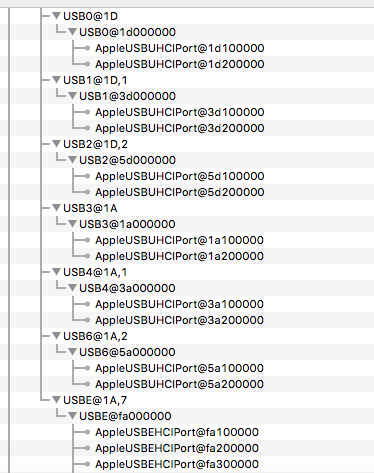

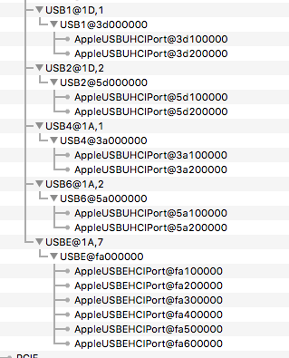

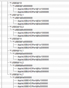

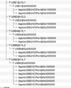

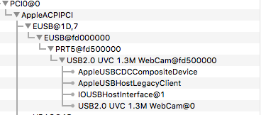

Javmain Posted September 13, 2016 Author Share Posted September 13, 2016 I use IORegistryExplorer and get those files. 1. no dsdt, it's like this. No DSDT IOService.zip 2.use your dsdt, it's like this. Use DSDT.zip Quote Link to comment https://www.insanelymac.com/forum/topic/315114-im-a-newer-someone-can-help-me-fix-my-dsdt-for-usb20thinks/#findComment-2277711 Share on other sites More sharing options...

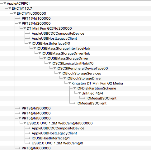

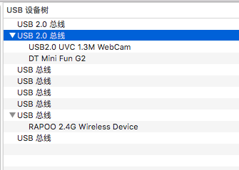

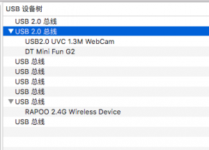

Javmain Posted September 15, 2016 Author Share Posted September 15, 2016 Hi,Hervé.I have fix this problem use DSDT. 1. I add this patche 'EHCI ownership' 2. I rename this 'EUSB' to EHC1 and 'USBE' to 'EHC2' EHCI ownership.txt now, all usb work well. DSDT.aml.zip Thank you very much.I'm so lucky. My IORegistry.zip Quote Link to comment https://www.insanelymac.com/forum/topic/315114-im-a-newer-someone-can-help-me-fix-my-dsdt-for-usb20thinks/#findComment-2278983 Share on other sites More sharing options...
