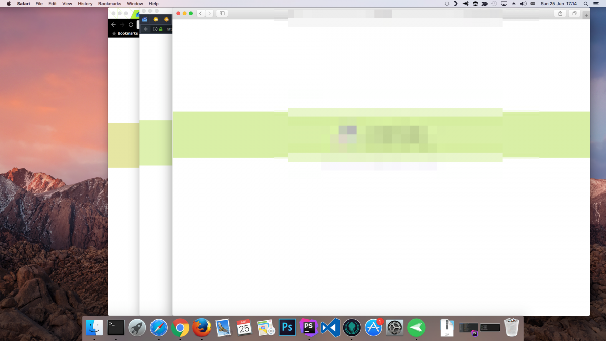

bwydoogh Posted June 24, 2017 Share Posted June 24, 2017 (edited) Another update: I took your clover.plist file and reinstalled macOS and now I have HDMI output. Great But now the next issue: no dual monitor (the internal one stays blank). So, what's next ? How can I get my internal monitor up-and-running again? EDIT : rebooting and now I have dual monitor set-up. Great ! EDIT2 : everything working now, also audio and brightness. Really great, and I love the macOS experience. Thanks for your guide! Edited June 24, 2017 by bwydoogh Link to comment https://www.insanelymac.com/forum/topic/314477-guide-dell-inspiron-15r-se-7520-with-macos-sierra/page/2/#findComment-2450523 Share on other sites More sharing options...
bwydoogh Posted June 24, 2017 Share Posted June 24, 2017 One more question : which display profile are you using for the built-in display? I was used to use a calibrated one (https://www.notebookcheck.net/uploads/tx_nbc2/Inspiron_15R_SE.icc (posted in the review https://www.notebookcheck.net/Review-Dell-Inspiron-15R-Special-Edition-Notebook.78323.0.html)) on Windows 10 and Ubuntu. I also want to use that one as the colors are too blue (when using the default "Display"). The only thing I am seeing now is that Google Chrome (Firefox not, Safari not) also seems to apply this profile, making the colors on some websites looking too yellow. So just wondering: what is your display set-up? Thanks in advance! Link to comment https://www.insanelymac.com/forum/topic/314477-guide-dell-inspiron-15r-se-7520-with-macos-sierra/page/2/#findComment-2450721 Share on other sites More sharing options...
doixanh Posted June 25, 2017 Author Share Posted June 25, 2017 Congratulate on your success. I manually calibrated myself, as each screen is different. I have my LVDS laptop screen and a Dell U2414h with HDMI connection. Link to comment https://www.insanelymac.com/forum/topic/314477-guide-dell-inspiron-15r-se-7520-with-macos-sierra/page/2/#findComment-2450945 Share on other sites More sharing options...
bwydoogh Posted June 25, 2017 Share Posted June 25, 2017 Congratulate on your success. I manually calibrated myself, as each screen is different. I have my LVDS laptop screen and a Dell U2414h with HDMI connection. The thing is: I never had such difference between browsers in Ubuntu 16.04 and Windows 10, using exact the same profile for my built-in display. See attached screenshot how things look like (and notice the color difference) -- from left to right: Google Chrome (too yellow), Firefox and Safari. On my smartphone, I see the same color as Firefox and Safari shows me in macOS. And Google Chrome is my favorite browser, so quite frustrating I have this issue. Any help, and clue? May I ask which browser you are using? Link to comment https://www.insanelymac.com/forum/topic/314477-guide-dell-inspiron-15r-se-7520-with-macos-sierra/page/2/#findComment-2451194 Share on other sites More sharing options...
doixanh Posted June 29, 2017 Author Share Posted June 29, 2017 I always use safari, so far so good to me. Link to comment https://www.insanelymac.com/forum/topic/314477-guide-dell-inspiron-15r-se-7520-with-macos-sierra/page/2/#findComment-2453201 Share on other sites More sharing options...

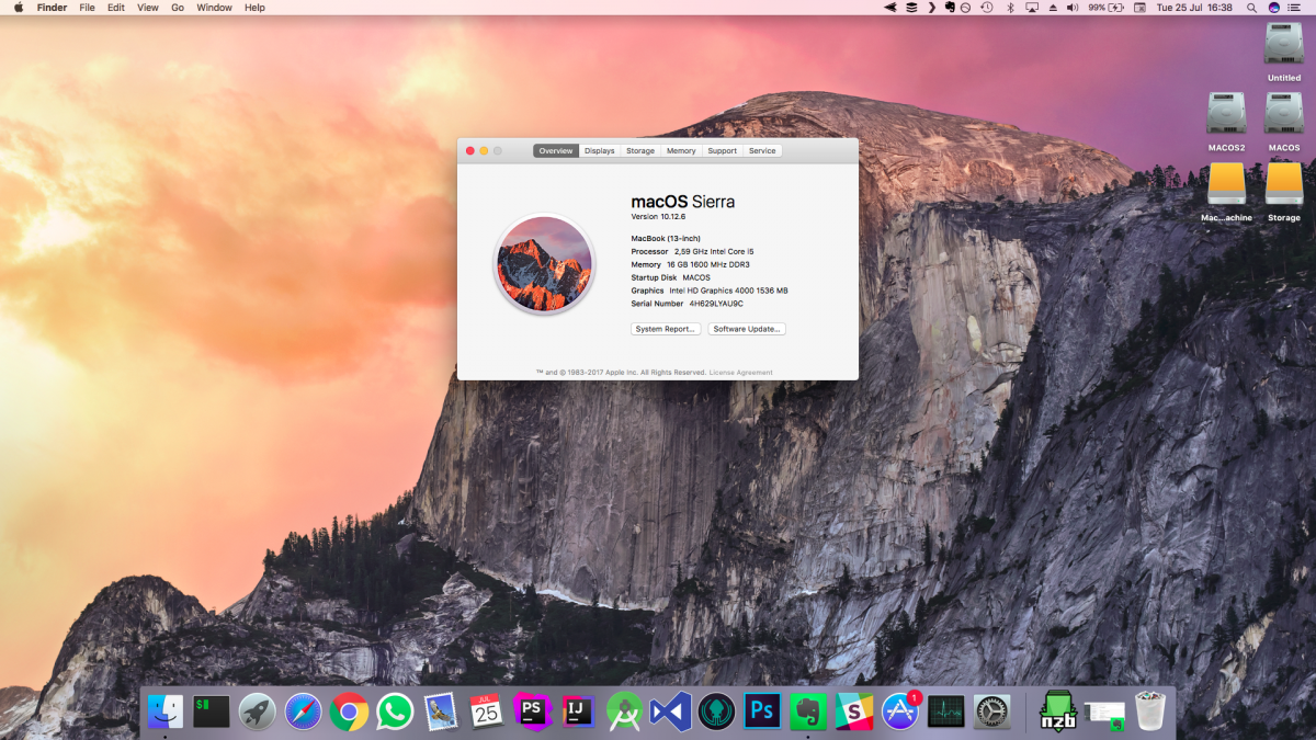

bwydoogh Posted July 20, 2017 Share Posted July 20, 2017 Safe to update to Sierra 10.12.6? BTW: still a pleasure to work with my "Mac". So glad I found this post. Verstuurd vanaf mijn XT1092 met Tapatalk Link to comment https://www.insanelymac.com/forum/topic/314477-guide-dell-inspiron-15r-se-7520-with-macos-sierra/page/2/#findComment-2466269 Share on other sites More sharing options...
doixanh Posted July 24, 2017 Author Share Posted July 24, 2017 No idea, I havent updated to 10.12.6 yet /edit: just updated and found no serious problem, except to remove AppleHDA.kext 1 Link to comment https://www.insanelymac.com/forum/topic/314477-guide-dell-inspiron-15r-se-7520-with-macos-sierra/page/2/#findComment-2468236 Share on other sites More sharing options...
bwydoogh Posted July 25, 2017 Share Posted July 25, 2017 No idea, I havent updated to 10.12.6 yet /edit: just updated and found no serious problem, except to remove AppleHDA.kext I launched the upgrade from 10.12 (yes, 10.12; had not made the upgrade to 10.12.5 yet) to 10.12.6 and everything worked fine (even brightness, even HDMI out, ethernet ... ) (and I did not replace AppleHDA.kext... audio still working). Great . I did not expect that an upgrade on a hackintosh would be so smooth. Link to comment https://www.insanelymac.com/forum/topic/314477-guide-dell-inspiron-15r-se-7520-with-macos-sierra/page/2/#findComment-2468989 Share on other sites More sharing options...

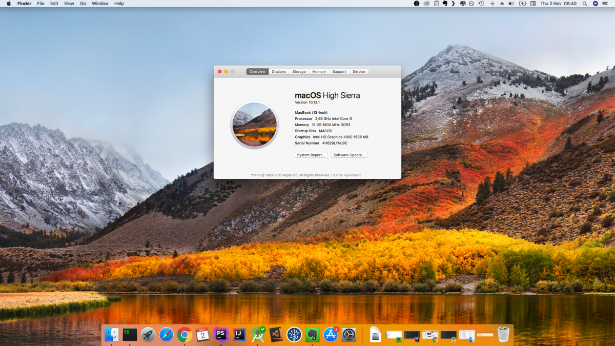

bwydoogh Posted November 2, 2017 Share Posted November 2, 2017 Had no luck when upgrading to High Sierra (but luckily I had cloned my MacOS partition before - successfully restored afterwards): black screen during update, nothing happening. Anyone had more luck? Great Got the High Sierra 10.13.1 update working on my Inspiron 7520. I don't know why it works now: it may be because I skipped the HFS+ to APFS conversion as I ran the upgrade as follows, or because there were some fixes in the 10.13.1 update: /Applications/"Install macOS High Sierra.app"/Contents/Resources/startosinstall --converttoapfs NO --agreetolicense Everything working fine... no need to do anything special. Link to comment https://www.insanelymac.com/forum/topic/314477-guide-dell-inspiron-15r-se-7520-with-macos-sierra/page/2/#findComment-2527292 Share on other sites More sharing options...
doixanh Posted December 25, 2017 Author Share Posted December 25, 2017 Ok I'm back I got a refreshed 10.12 just now. I had to use Capri 04 to boot the 10.12 installer with LVDS, install as normal. After installation, I had to copy FakeSMC FakePCIID and FakePCIID_XHCIMux to boot. VoodooHDA is required for sound, and AppleHDA needs to be removed. I had to copy 10.12.6 Capri over for my binary patch to work. Everything in my previous clover EFI partition still works as expected. I struggled to boot the 10.13 installer for several months already. Always got black screen. I tried both MacPwn and Un1b3ast, none was able to make a bootable USB installer for me. @bwydoogh: how did you make your 10.13 installer bootable? or was it only a direct App Store upgrade? Link to comment https://www.insanelymac.com/forum/topic/314477-guide-dell-inspiron-15r-se-7520-with-macos-sierra/page/2/#findComment-2556413 Share on other sites More sharing options...
bwydoogh Posted December 25, 2017 Share Posted December 25, 2017 @bwydoogh: how did you make your 10.13 installer bootable? or was it only a direct App Store upgrade? Hi. Yes, it was a direct upgrade from the App Store. No issues so far, but as I said... did not convert from HFS+ to APFS. Link to comment https://www.insanelymac.com/forum/topic/314477-guide-dell-inspiron-15r-se-7520-with-macos-sierra/page/2/#findComment-2556418 Share on other sites More sharing options...
