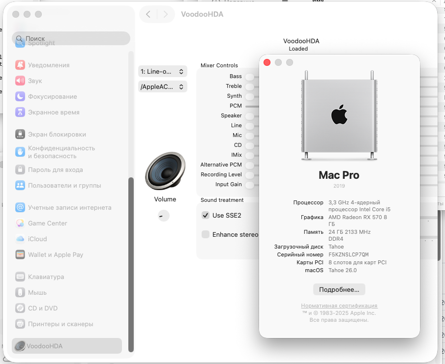

Slice Posted October 10, 2025 Author Share Posted October 10, 2025 On 10/9/2025 at 7:40 AM, verdazil said: You are wrong because "prevents VoodooHDA to tune it properly" just points out the problems and shortcomings of the VoodooHDA driver. Also, this does not mean in any way that AudioDxe is somehow dependent on VoodooHDA. Anyway this is the known problem. 1 Link to comment https://www.insanelymac.com/forum/topic/314406-voodoohda-312/page/33/#findComment-2842062 Share on other sites More sharing options...

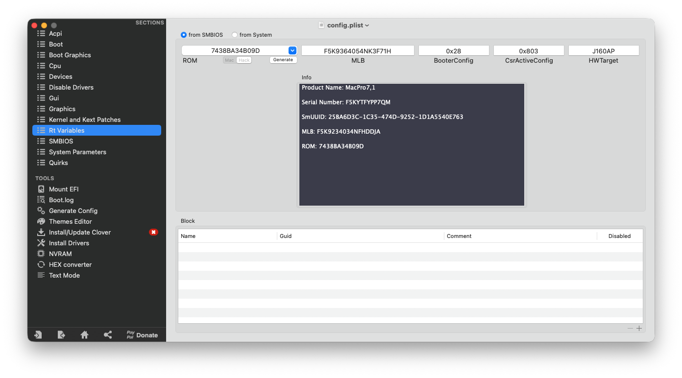

Max.1974 Posted October 14, 2025 Share Posted October 14, 2025 1 hour ago, BuXb said: @deeveedee for compatibility with several apps (incl. XtraFinder) across several versions of macOS I use <850A0000> which also breaks macOS incremental updates + full (bootable) system backups, therefore the additional ESP Optional you can use 0x803 works fine to me Lenovo T14 If you will use Clover 2 Link to comment https://www.insanelymac.com/forum/topic/314406-voodoohda-312/page/33/#findComment-2842236 Share on other sites More sharing options...
deeveedee Posted October 15, 2025 Share Posted October 15, 2025 19 minutes ago, Max.1974 said: Optional you can use 0x803 works fine to me Lenovo T14 If you will use Clover Open Core's <03080000> is the same as Clover's 0x803. Open Core config.plist specifies CsrActiveConfig as little endian. 1 1 Link to comment https://www.insanelymac.com/forum/topic/314406-voodoohda-312/page/33/#findComment-2842237 Share on other sites More sharing options...

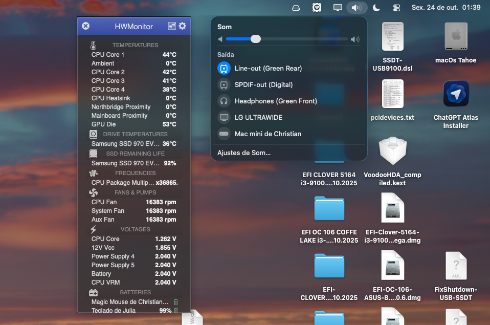

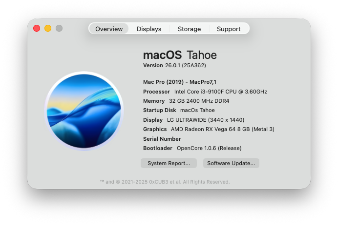

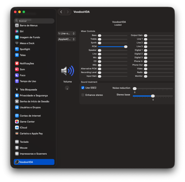

Max.1974 Posted October 24, 2025 Share Posted October 24, 2025 @Slice Thank you for version 3.0.3, I compiled it in Xcode 16.4 with Tahoe 26.0.1 on my i3-9100F ASUS Desktop with an RX 64 Vega, and the sound works perfectly. ALC887 Layout 2. And I used chris1111’s package to install it. Wonderful. Csr-Active-Config 0xA85 3 Link to comment https://www.insanelymac.com/forum/topic/314406-voodoohda-312/page/33/#findComment-2842726 Share on other sites More sharing options...
