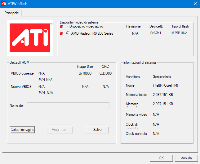

Swear Posted August 19, 2016 Author Share Posted August 19, 2016 The switch is located on the edge of the card. On your card it should be a button! Yes, there it is. I see there is a GUI exe in the ATI Winflash folder. Can I use that or I must use the prompt thing? Quote Link to comment https://www.insanelymac.com/forum/topic/314209-macos-sierra-r9-290-sapphire-vapor-x-problem/page/2/#findComment-2267604 Share on other sites More sharing options...
ombra88 Posted August 20, 2016 Share Posted August 20, 2016 Thank you for your reply. Personally, I am a bit noob about this. Could you please guide us through? Again, thank for making something finally clear ahaha ehm it would be helpful for me too cuze i'm super noob at it, btw i will try to use mac pro 6,1 and i will update if it work or not, the problem of some people here is that they don't have to do that, it's all about if they want or not help and put the hackintosh world, community ecc in the next level. Before here, i was using tony.. and i wrote an entire guide about my config...but none is equal. Boot to windows. Download atiwinflash & 290X bios for your card https://www.techpowerup.com/vgabios/?architecture=&manufacturer=Sapphire&model=R9+290X&interface=&memType=&memSize= Flip the switch on the card? Run command prompt as admin, atiwinflash -f -p 0 thebiosfileyoudownloaded.rom You'll get black screen until the os is loaded, so you better setup clover to boot Sierra automatically. hi i'm ombra thank you a lot for your help!!! if you can help, for me that i have the msi r9 290x with tri-x flashed bios, what should i do? cuze everytime i try to boot, i experience just a no signal screen. Quote Link to comment https://www.insanelymac.com/forum/topic/314209-macos-sierra-r9-290-sapphire-vapor-x-problem/page/2/#findComment-2268051 Share on other sites More sharing options...

okrasit Posted September 17, 2016 Share Posted September 17, 2016 It seems you haven't set fakeid in Clover. There's no matching driver for 1002 67b1 in osx. For now, boot blind or not at all. Quote Link to comment https://www.insanelymac.com/forum/topic/314209-macos-sierra-r9-290-sapphire-vapor-x-problem/page/2/#findComment-2279851 Share on other sites More sharing options...
