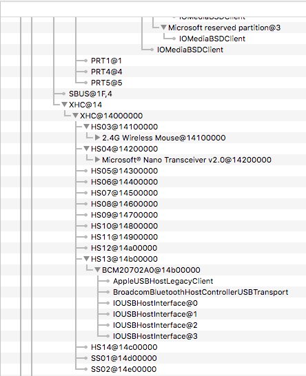

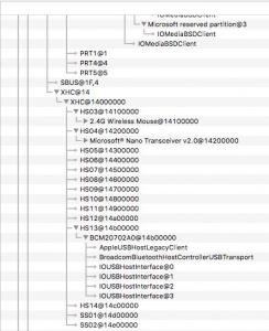

Denicio Posted June 16, 2016 Share Posted June 16, 2016 All my USB ports work fine. What kind of problem are we talking about? And how can I begin to debug this? Well, open IORegistryExplorer.app and find your "XHC" label on this tree list. Take a screenshot with it expanded and post it here. I'll be able to tell you if you're OK or you need to do some work. Link to comment https://www.insanelymac.com/forum/topic/312589-bcm94352hmb-bluetooth-wifi-speed-problems/#findComment-2243754 Share on other sites More sharing options...

Denicio Posted June 16, 2016 Share Posted June 16, 2016 Both, the Wifi and the Bluetooth signals interfere with each other due their frequencies. There are Router/AP's out there mostly with a dd-wrt based firmware which has a special "bluetooth compatibility mode" for such dual chipped cards with one antenna. Are u sure that these issues are not happen on Windows/Linux too? Your card is connected via mPCIe, therefore this has nothing todo with USB... You last sentence contains false information. Mini PCIe cards like Wifi+BT use the USB Bus to communicate with the rest of the components. Take a look at "HS13" on the attached photo. Link to comment https://www.insanelymac.com/forum/topic/312589-bcm94352hmb-bluetooth-wifi-speed-problems/#findComment-2243794 Share on other sites More sharing options...
