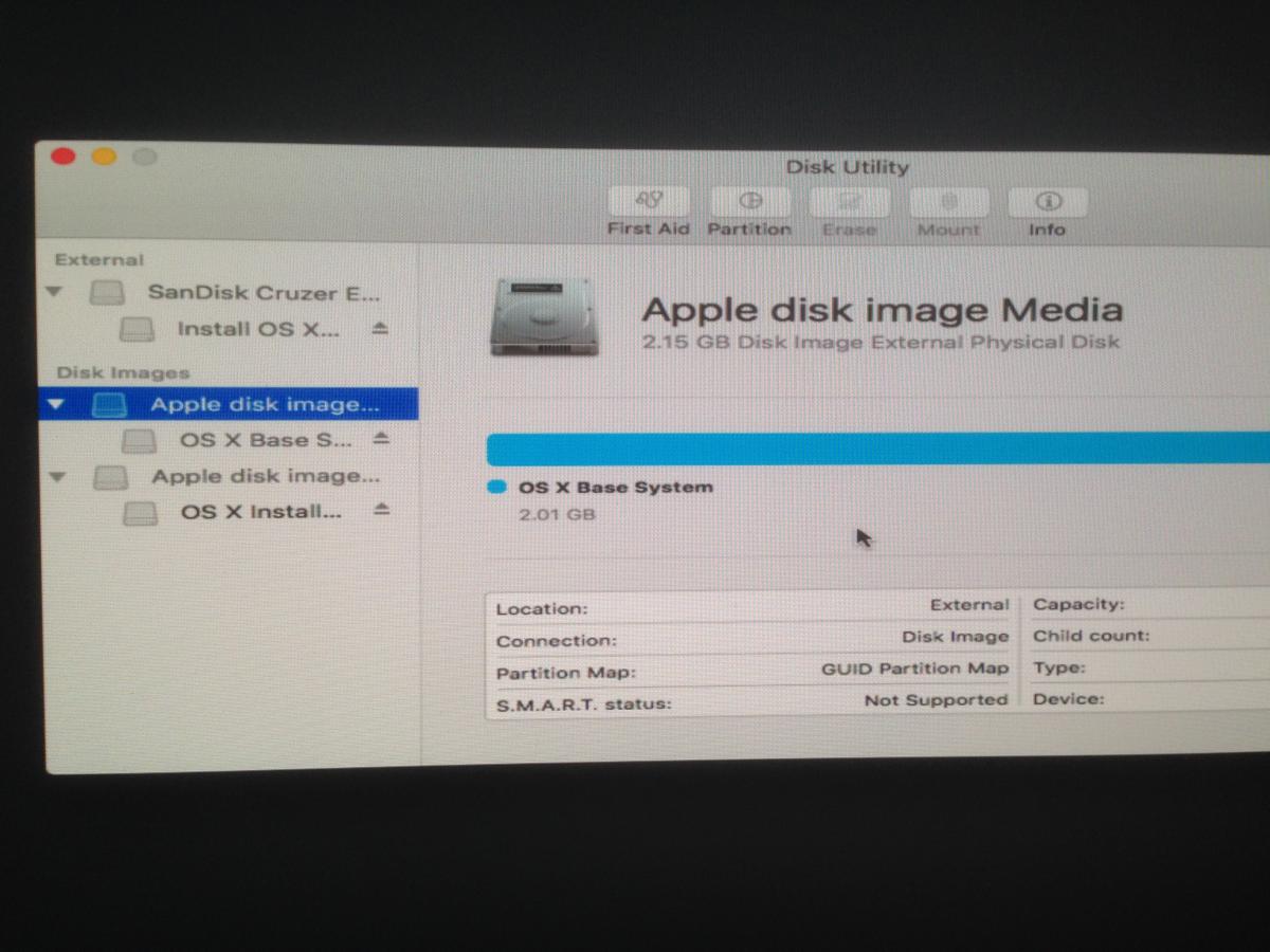

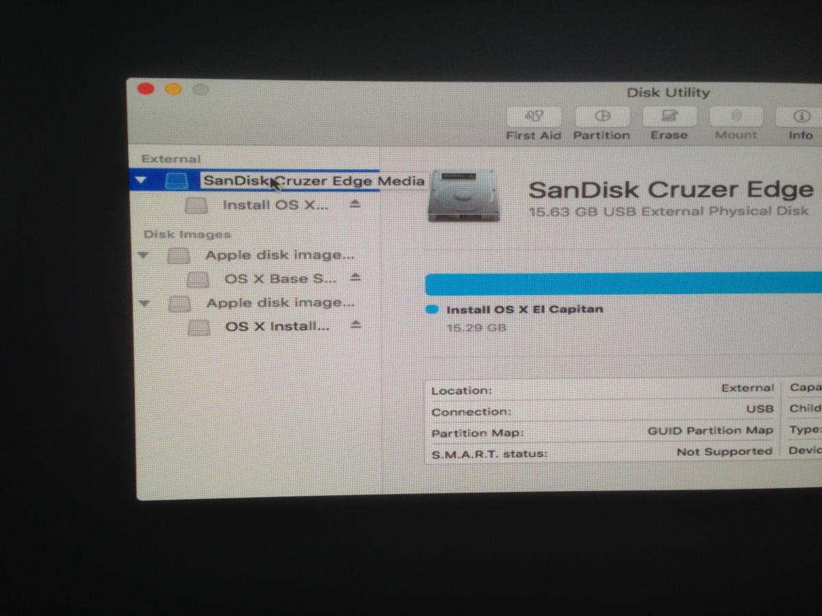

Wanderer3 Posted June 9, 2016 Share Posted June 9, 2016 I need assistance, I have created a bootable usb with El Capitan 10.11.5 and Clover for UEFI boot only, installing the recommended defaults, i.e Install for uefi booting, Install Clover in the ESP, and Following another tutorial I also installed several kexts (FakeSMC, ApplePS2Controller, AppleACPIPS2Nub, NullCPUPowerManagement ) in EFI/Clover/kexts/10.1. directory. I have two SSD's installed, 1 has a windows 7 installation, and the other, the target drive for os x install. The os x install drive is pre formatted os x extended, journaled, GUID. The USB boots into the clover menu, and the target SSD is not visible, although the SSD with win 7 is. Booting from usb goes through all the way to the install El Capitan menu, but when I open disk utility to format the target drive, the drive is still not visible, only the boot USB shows and it is listed as an internal drive. There are two other entries listed on the disk utility screen, I have included pictures to illustrate. The bios version is f5. I have tried various settings in the bios and even tried reflashing it, but still no progress. My previous build was a core i7 sandy bridge on ga Z79x ud3P legacy f7 bios, running Mavericks, and it was rock solid, until it's sad demise, which drove me to try a newer build. Any advice on where I may have gone wrong would be very welcome. Quote Link to comment https://www.insanelymac.com/forum/topic/312471-clover-uefi-usb-boots-to-el-capitan-install-screen-but-target-ssd-not-showing-in-disk-utility/ Share on other sites More sharing options...
Allan Posted June 10, 2016 Share Posted June 10, 2016 Make sure that in BIOS, you have AHCI enabled. With Clover you can dispense some kexts, like NullCPU, and use AICPMpatch. And if you want, in this case that is just for install OS X, isn't necessary use the last OS X version (10.11.5), you can have better results using the first version - 10.11.0 Quote Link to comment https://www.insanelymac.com/forum/topic/312471-clover-uefi-usb-boots-to-el-capitan-install-screen-but-target-ssd-not-showing-in-disk-utility/#findComment-2242015 Share on other sites More sharing options...
