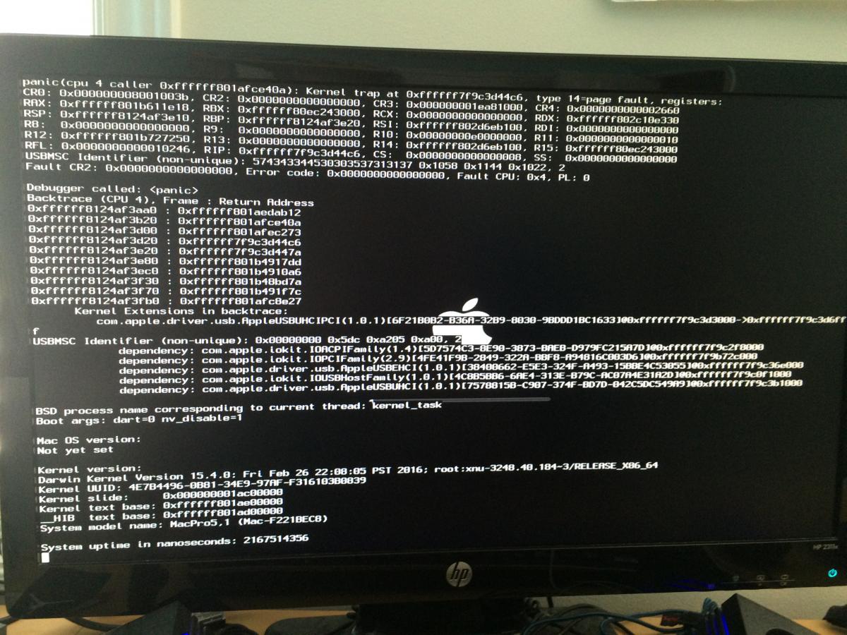

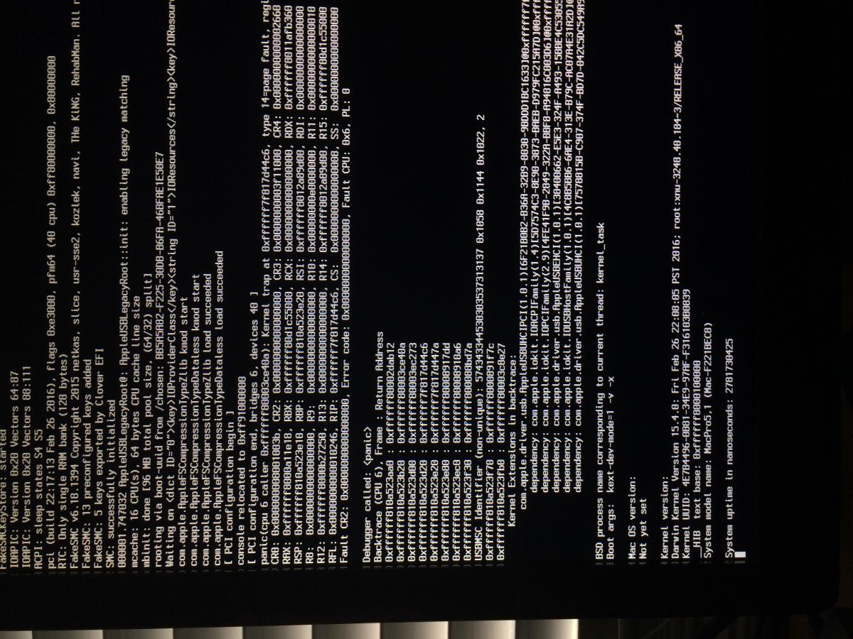

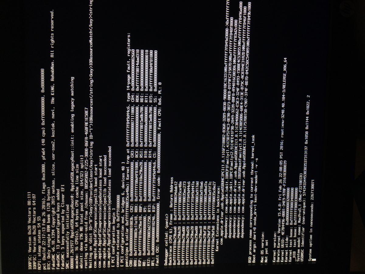

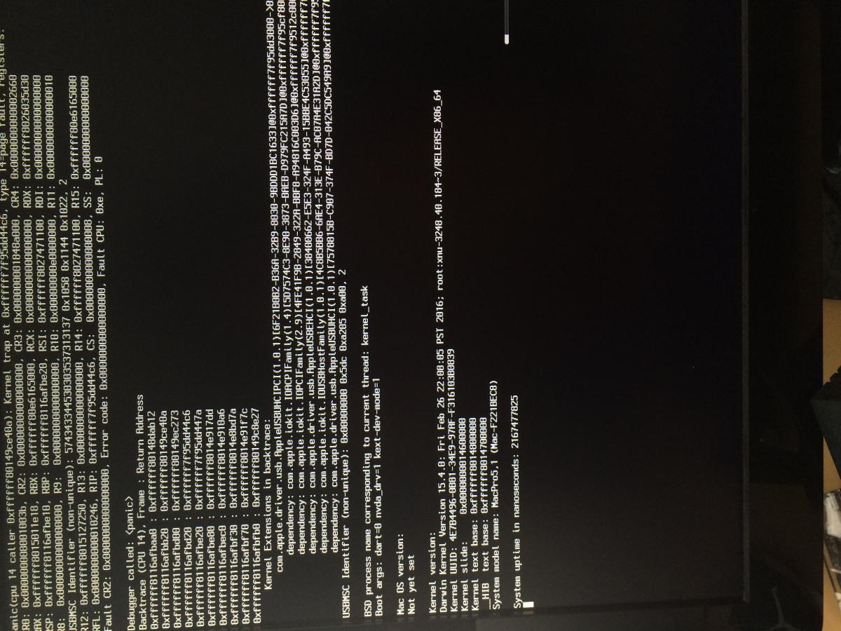

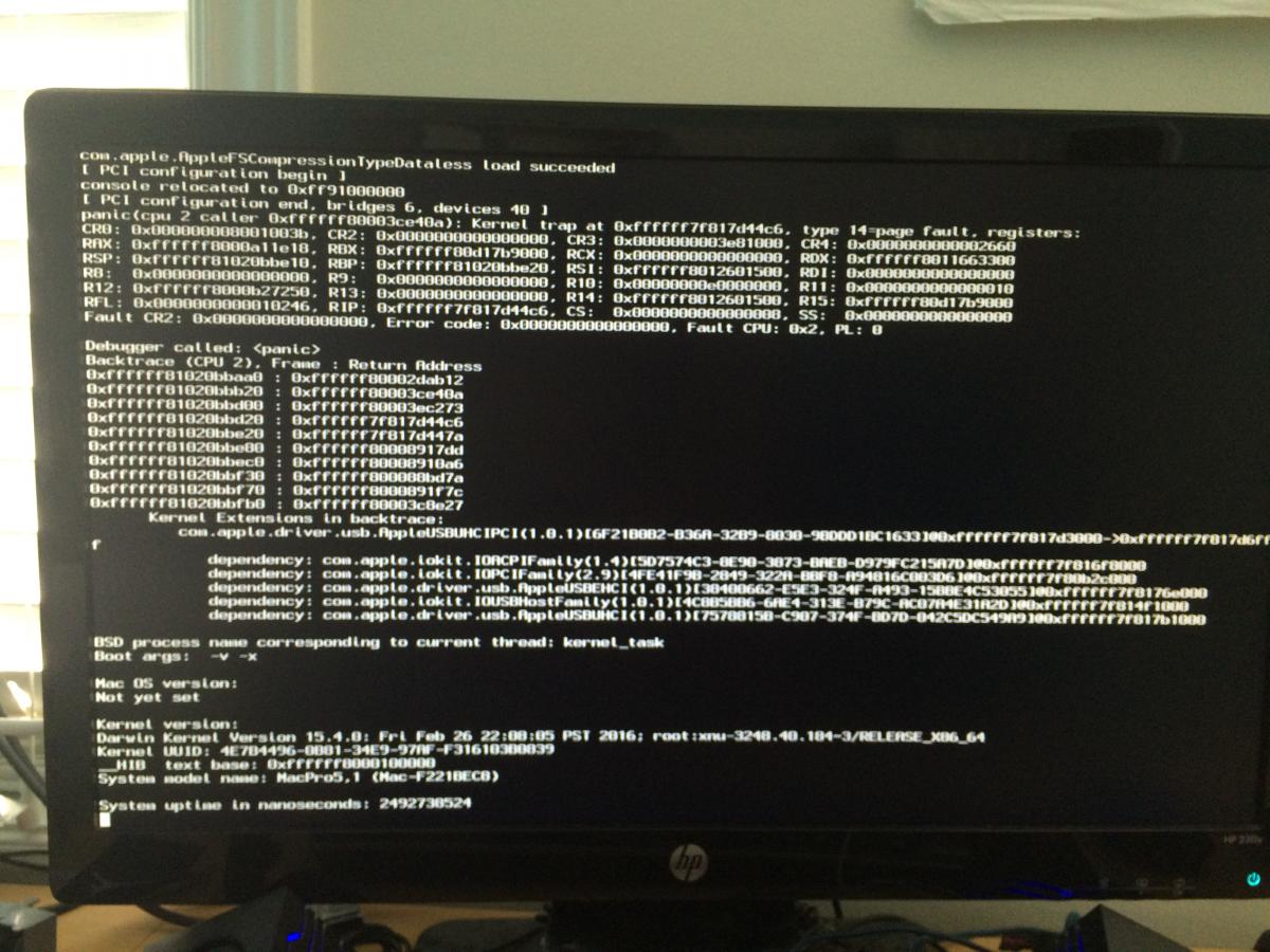

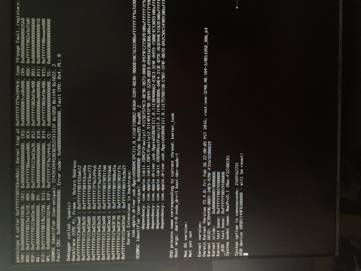

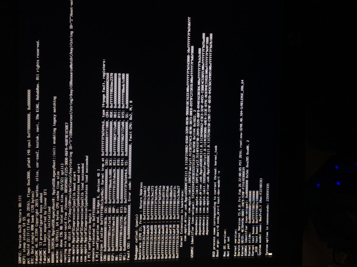

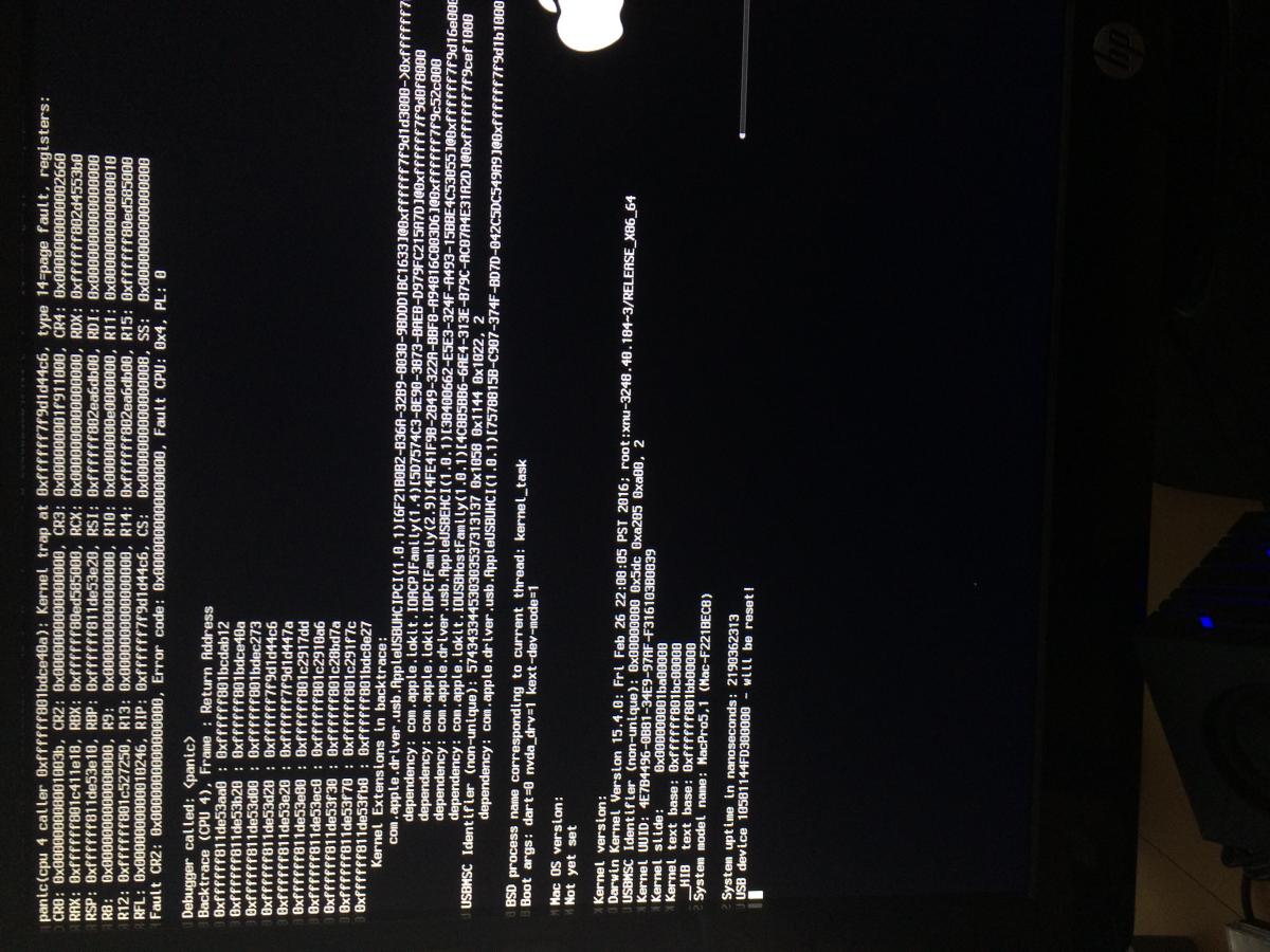

fchung0712 Posted May 14, 2016 Share Posted May 14, 2016 Good Morning (or afternoon, or Evening) I have already installed OS X El Capitan actually, however this is the first time I attempted booting from my Hackintosh Build, so it is as good as not installed yet. I installed on my iMac first, and installed the Nvidia Web Drivers, so that my GPU would work in case you are wondering. My build consists of: Motherboard: SuperMicro X8DTi-F GPU: Zotac AMP! 4GB GTX 960 CPU(s): 2x Xeon X5570 RAM: 8GB Hynix HMT31GR7BFR4C-H9 (ECC Registered) Not sure why the photos are sideways, they appear fine on my Mac, so my apologies. Update: I just tried reposting with the photos rotated, but they showed up the way I edited them. Sideways. Here is the Boot with just nvda_drv=1 dart=0 and kext-dev-mode=1 This one is Single user This is Verbose And lastly, safe mode Thanks for any help you give me! Link to comment https://www.insanelymac.com/forum/topic/312205-system-uptime-in-nanoseconds-yet-again/ Share on other sites More sharing options...
Fljagd Posted May 14, 2016 Share Posted May 14, 2016 you definitely need to put this kext to manage CPUs, in EFI/CLOVER/KEXT/... VoodooTSCSync.kext.zip 1 Link to comment https://www.insanelymac.com/forum/topic/312205-system-uptime-in-nanoseconds-yet-again/#findComment-2238003 Share on other sites More sharing options...
fchung0712 Posted May 14, 2016 Author Share Posted May 14, 2016 Thanks for your help! Sadly, it still stops at the same error Link to comment https://www.insanelymac.com/forum/topic/312205-system-uptime-in-nanoseconds-yet-again/#findComment-2238009 Share on other sites More sharing options...

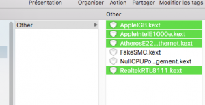

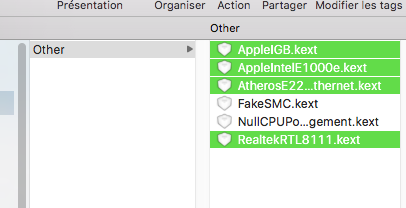

Fljagd Posted May 14, 2016 Share Posted May 14, 2016 in a first step, removing kexts highlighted and restart it detects 8 cores try this kext VoodooTSCSync.kext.zip Link to comment https://www.insanelymac.com/forum/topic/312205-system-uptime-in-nanoseconds-yet-again/#findComment-2238027 Share on other sites More sharing options...

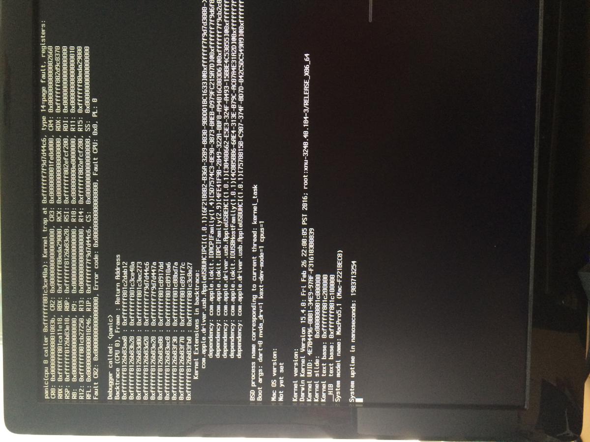

Fljagd Posted May 14, 2016 Share Posted May 14, 2016 i think (4 cores 8 threads) *2 I propose a test startup under a different single cpu boot arg cpus = 1 I seek the right configuration kext Link to comment https://www.insanelymac.com/forum/topic/312205-system-uptime-in-nanoseconds-yet-again/#findComment-2238037 Share on other sites More sharing options...
fchung0712 Posted May 14, 2016 Author Share Posted May 14, 2016 Still ends in System uptime in nanoseconds Link to comment https://www.insanelymac.com/forum/topic/312205-system-uptime-in-nanoseconds-yet-again/#findComment-2238040 Share on other sites More sharing options...

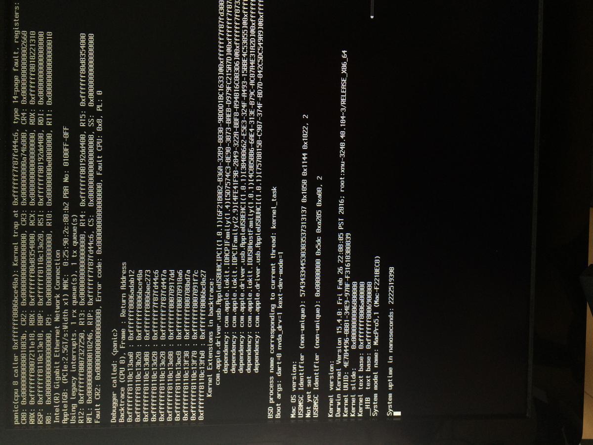

fchung0712 Posted May 14, 2016 Author Share Posted May 14, 2016 Try other usb ports. Try to remove all usb injection on config.plist Tried it, sadly, it still isn't working... I re-did my EFI folder, to see if I made a mistake, and now the cpu that is receiving errors has changed Thank you both by the way! Link to comment https://www.insanelymac.com/forum/topic/312205-system-uptime-in-nanoseconds-yet-again/#findComment-2238045 Share on other sites More sharing options...

Needy Posted May 15, 2016 Share Posted May 15, 2016 Just out of curiosity, would it be possibly easier to use Chameleon instead of Clover? My motherboard already lacks the support for EFI Booting (My copy of Clover is for Legacy computers) Hello there, I reduced your clover folder to minimum, there will be errors, but we need to understand the root of your problem. In addition, because I'm not allowed to share HFSPlus.efi, search for it and put it in drivers64 and drivers64UEFI. Report results here. Best of luck. CLOVER.zip Link to comment https://www.insanelymac.com/forum/topic/312205-system-uptime-in-nanoseconds-yet-again/#findComment-2238104 Share on other sites More sharing options...
fchung0712 Posted May 15, 2016 Author Share Posted May 15, 2016 Thanks for your help! Here are the results: Standard Boot: Safe Mode: Just a thought, however, I don't think my machine would boot Mac at all with nvda_disable=1, as my GTX 960 is not natively supported. Please correct me if I am wrong, as I this is my first desktop hackintosh Link to comment https://www.insanelymac.com/forum/topic/312205-system-uptime-in-nanoseconds-yet-again/#findComment-2238142 Share on other sites More sharing options...
