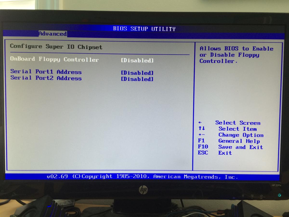

fchung0712 Posted May 15, 2016 Author Share Posted May 15, 2016 I am assuming that the setting for the Serial Port setting, you mean this one: After I changed all of them to disabled (previously the onboard floppy controller setting was already disabled), these are the results: Link to comment https://www.insanelymac.com/forum/topic/312205-system-uptime-in-nanoseconds-yet-again/page/2/#findComment-2238162 Share on other sites More sharing options...

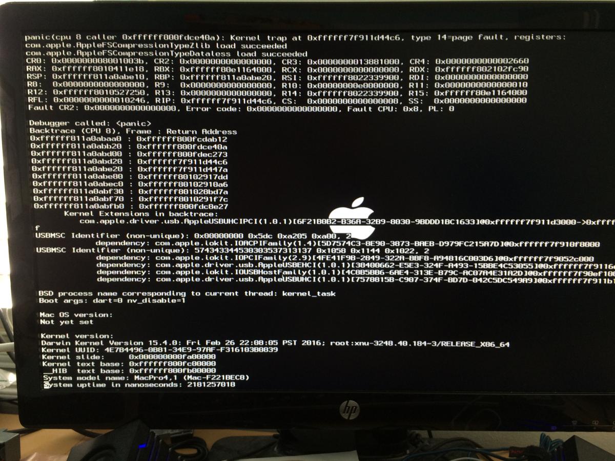

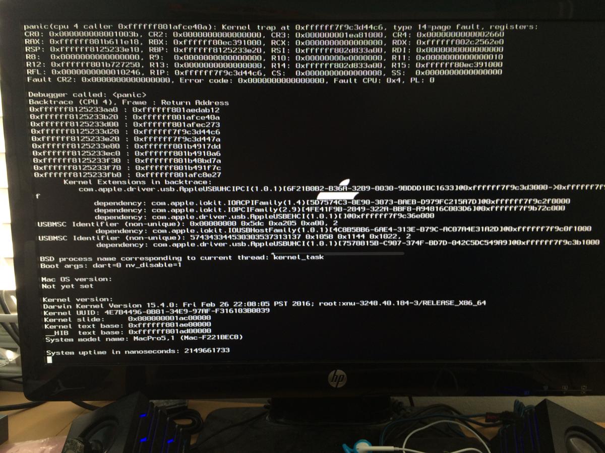

fchung0712 Posted May 15, 2016 Author Share Posted May 15, 2016 Error still seems pretty similar Tried it with the old Clover folder, and the new one that Needy sent me, and both seemed very similar. Here is a picture of the error: Link to comment https://www.insanelymac.com/forum/topic/312205-system-uptime-in-nanoseconds-yet-again/page/2/#findComment-2238188 Share on other sites More sharing options...

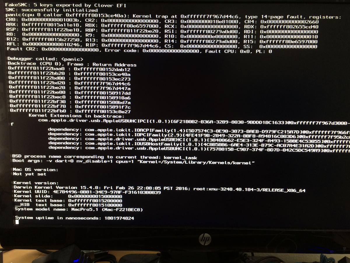

Needy Posted May 15, 2016 Share Posted May 15, 2016 Error still seems pretty similar Tried it with the old Clover folder, and the new one that Needy sent me, and both seemed very similar. Here is a picture of the error: IMG_0983.JPG Try to disable USB controller in BIOS. Never mind, you won't be able start clover. New config. Report results. Best of luck. config.plist.zip Link to comment https://www.insanelymac.com/forum/topic/312205-system-uptime-in-nanoseconds-yet-again/page/2/#findComment-2238200 Share on other sites More sharing options...

fchung0712 Posted May 15, 2016 Author Share Posted May 15, 2016 It certainly looked like it did a lot more than before! This is what it ends with however: Link to comment https://www.insanelymac.com/forum/topic/312205-system-uptime-in-nanoseconds-yet-again/page/2/#findComment-2238218 Share on other sites More sharing options...
Needy Posted May 15, 2016 Share Posted May 15, 2016 It certainly looked like it did a lot more than before! This is what it ends with however: IMG_0994.PG I have enabled the debug messages that's why. Since you can boot that drive from your mac, boot it, install nvidia web driver and use the below config. In addition, try to find the kext that is causing kernel panic and remove it. Best of luck. config.plist.zip Link to comment https://www.insanelymac.com/forum/topic/312205-system-uptime-in-nanoseconds-yet-again/page/2/#findComment-2238221 Share on other sites More sharing options...
Fljagd Posted May 15, 2016 Share Posted May 15, 2016 try to delete AppleUSBHCIPI.Kext in S/L/E/IOUSBHostFamily.kext/contents/plugins Link to comment https://www.insanelymac.com/forum/topic/312205-system-uptime-in-nanoseconds-yet-again/page/2/#findComment-2238238 Share on other sites More sharing options...
Micky1979 Posted May 15, 2016 Share Posted May 15, 2016 ****USB port restriction**** is a common problem in El Capitan Link to comment https://www.insanelymac.com/forum/topic/312205-system-uptime-in-nanoseconds-yet-again/page/2/#findComment-2238245 Share on other sites More sharing options...
