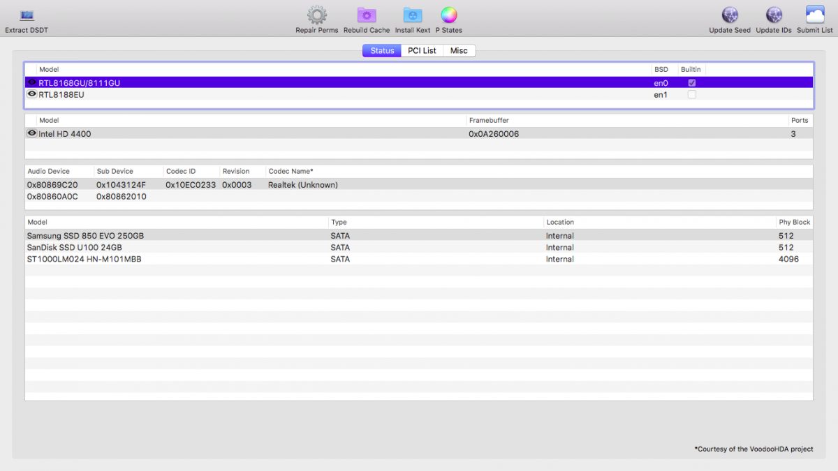

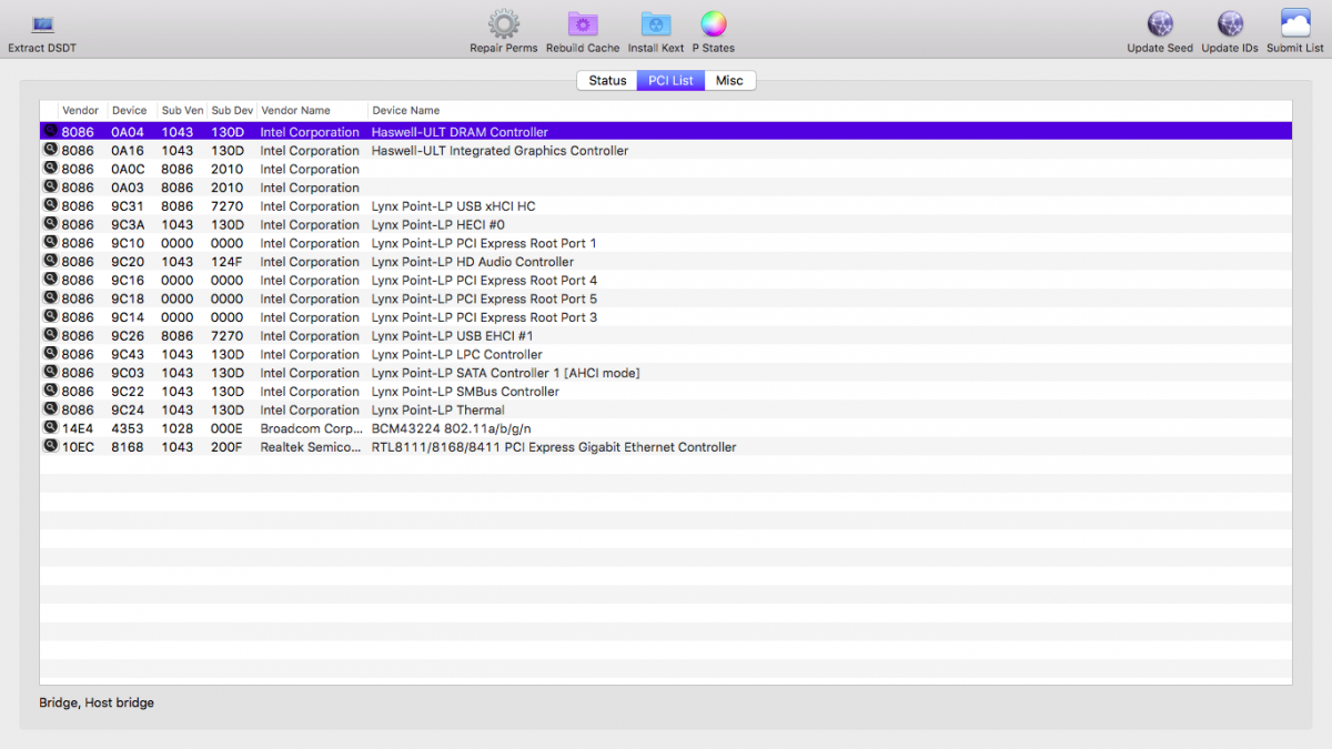

Jolly Posted May 12, 2016 Share Posted May 12, 2016 Scaricati e lancia DPCIManager e posta le schermate Status e PCI List Link to comment https://www.insanelymac.com/forum/topic/312176-dell-dw1520-su-el-capitan/#findComment-2237575 Share on other sites More sharing options...
Paolo7297 Posted May 12, 2016 Author Share Posted May 12, 2016 Da qua viene riconosciuta.. eccoli Link to comment https://www.insanelymac.com/forum/topic/312176-dell-dw1520-su-el-capitan/#findComment-2237590 Share on other sites More sharing options...
