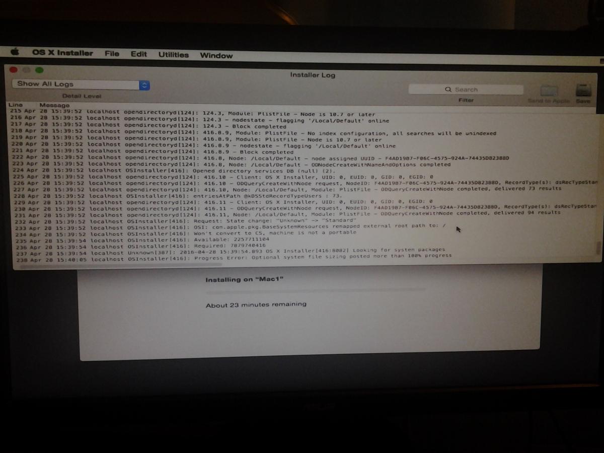

ahn.2001 Posted April 27, 2016 Author Share Posted April 27, 2016 Thanks! I installed osx using your advice with no problems. However now when I try to boot from the partition I installed osx on, I get : [ IOBluetoothHCIController][searchForTransportEventTimeOutHandler] -- Missing Bluetooth Controller Transport! So looks like I am 1 kink away from enjoying both the goodness of Windows and Mac together Quote Link to comment https://www.insanelymac.com/forum/topic/311984-clover-doesnt-boot-to-osx-installer-keeps-loading-into-itself-please-read/#findComment-2234875 Share on other sites More sharing options...
Allan Posted April 27, 2016 Share Posted April 27, 2016 Try boot with this same boot-args that i've send to you. When you get in OS X, install Nvidia Web Drivers, and change the boot-arg for nvda_drv=1 Quote Link to comment https://www.insanelymac.com/forum/topic/311984-clover-doesnt-boot-to-osx-installer-keeps-loading-into-itself-please-read/#findComment-2234883 Share on other sites More sharing options...
ahn.2001 Posted April 27, 2016 Author Share Posted April 27, 2016 Unfortunately even when booting with the -v nv_disable=1 flags I get the same error... Reinstalling now Strange that your method worked to reach the installer but doesn't work to actually boot osx Everything I've tried failed too. Anything else to try? Once again thank you Quote Link to comment https://www.insanelymac.com/forum/topic/311984-clover-doesnt-boot-to-osx-installer-keeps-loading-into-itself-please-read/#findComment-2234898 Share on other sites More sharing options...

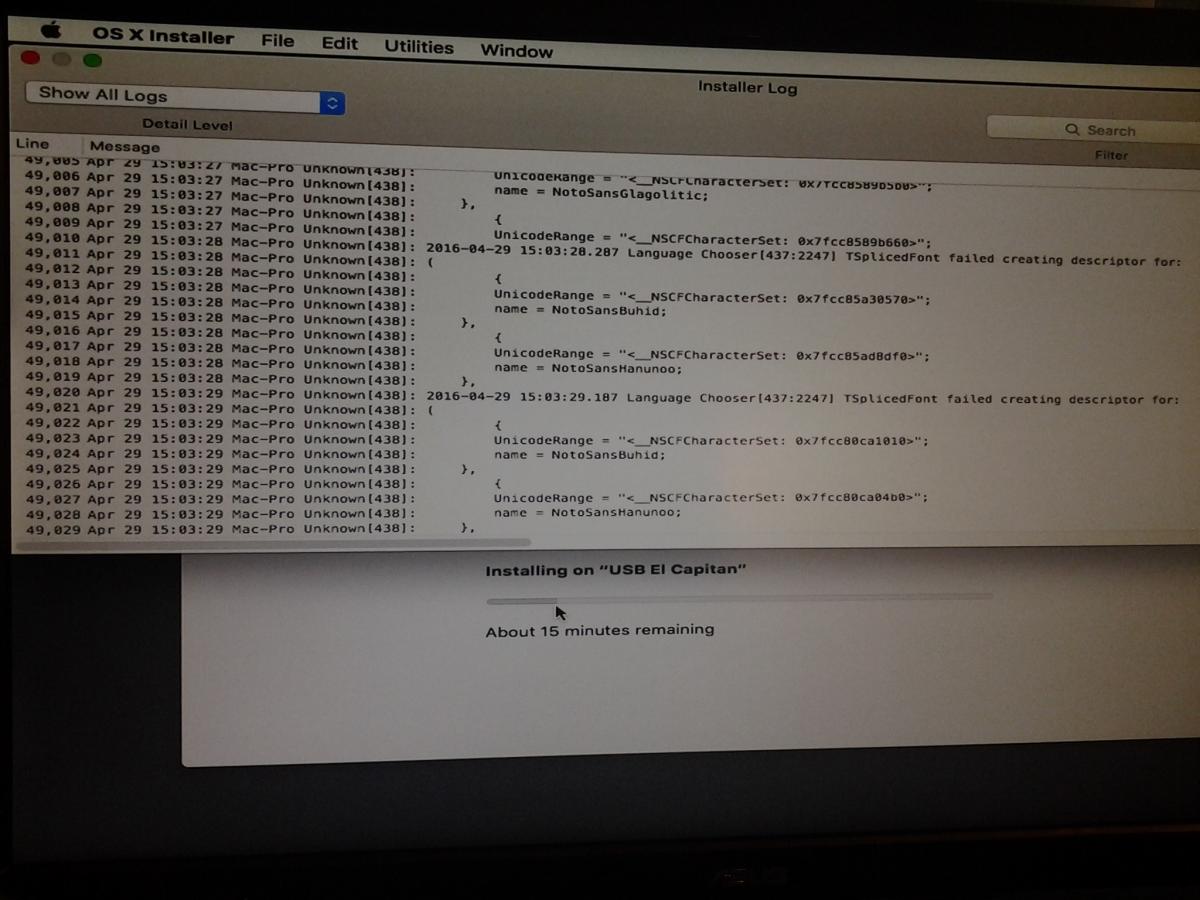

ahn.2001 Posted April 29, 2016 Author Share Posted April 29, 2016 Wow, olarila USB got me to the El Capitan installer after I set up the BIOS to use the Intel HD to power my monitor and not the Nvidia. Later this can be fixed with some drivers I'm sure. However when I try to install I get a GUID partition error. Looking online I found the thread saying I need this patch. How do I go about installing a patch? For some reason I can't paste links into this box www.osx86.net/files/file/4257-yosemite-mbr-patch/ Thank you so much Quote Link to comment https://www.insanelymac.com/forum/topic/311984-clover-doesnt-boot-to-osx-installer-keeps-loading-into-itself-please-read/#findComment-2235281 Share on other sites More sharing options...
ahn.2001 Posted April 29, 2016 Author Share Posted April 29, 2016 Oh and I have made the partition 14GB now Quote Link to comment https://www.insanelymac.com/forum/topic/311984-clover-doesnt-boot-to-osx-installer-keeps-loading-into-itself-please-read/#findComment-2235293 Share on other sites More sharing options...
Allan Posted April 29, 2016 Share Posted April 29, 2016 Hmm, that's the problem. You are trying install OS X in Legacy Way, for your Hardware the best mode is UEFI. Look: UEFI multi boot with Clover Quote Link to comment https://www.insanelymac.com/forum/topic/311984-clover-doesnt-boot-to-osx-installer-keeps-loading-into-itself-please-read/#findComment-2235307 Share on other sites More sharing options...

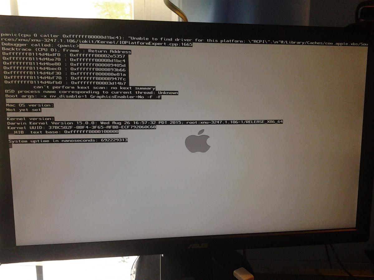

ahn.2001 Posted April 30, 2016 Author Share Posted April 30, 2016 Finally el Capitan installed, went to boot and...damn! Either I get the system uptime in nanoseconds or dreaded Bluetooth errors, even though I'm using the Intel HD to power the monitor and using correct boot flags. Quote Link to comment https://www.insanelymac.com/forum/topic/311984-clover-doesnt-boot-to-osx-installer-keeps-loading-into-itself-please-read/#findComment-2235395 Share on other sites More sharing options...
