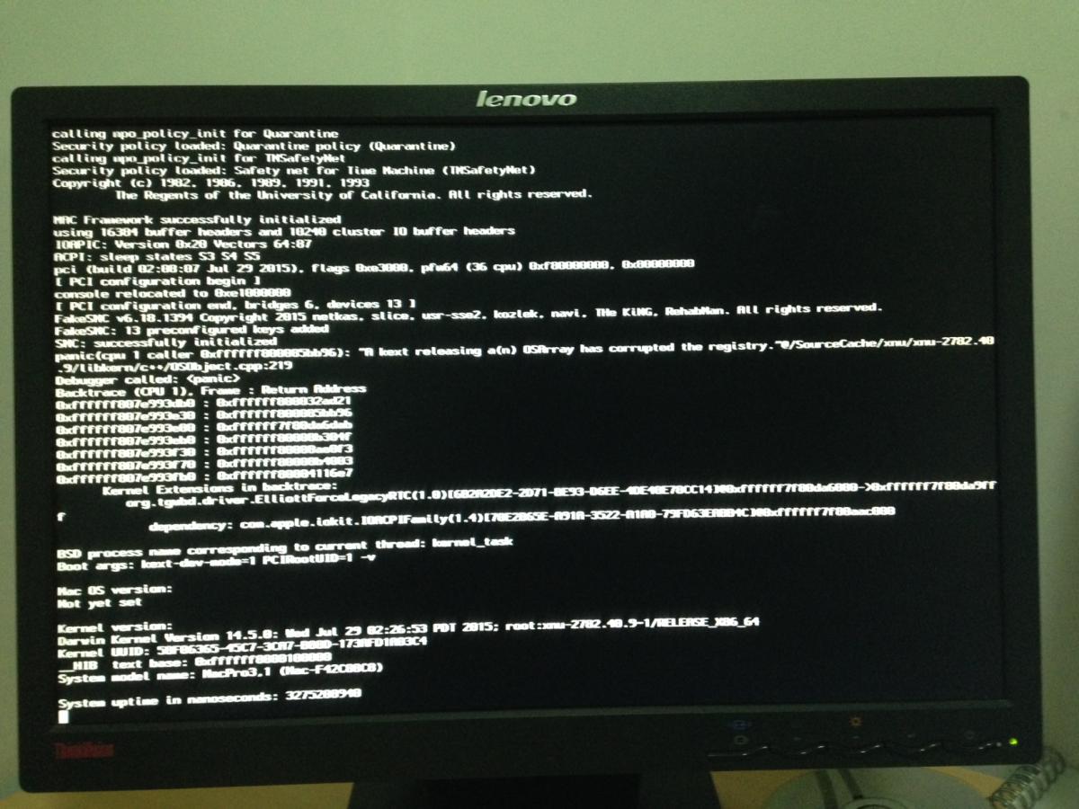

maxfaria Posted April 16, 2016 Share Posted April 16, 2016 Hi friends, My name is Max. I have a problem and would like your help.I have a computer with following settings:- MotherBoard Intel D945CGNL - 4GB Ram- Processadort Intel Core 2 LGA775- Nvidia 9500, Lan Realtek 8169 - Multimedia Intel HDA ALC888 - Realtek RTL8111BI installed the Yosemite on my PC, the installation was successful. After installed the ##### for Yosemite, i choose #####. Then, all right, i reboot. After boot i keep getting a kernel panic (attachment). I searched on Google and find out that the problem was ElliottForceLegacyRTC.knext. For to solve the problem i boot again with and removed the file ElliottForceLegacyRTC.knext.After this my Hack boot and no Kernel Panic, but after Apple logo appears a White Screen. Well, i boot with following parameters: boot: -x -v GraphicsEnabler=Yes, PCIRootUID=1, npci=0x2000. Then my Hack back, but only option -x.Installed again the ##### and again i have a kernel panic (attachment).Does anyone have an idea? How can i solve this problem? Is there any PATCH for this file? How to install Multicast without this problem with ElliottForceLegacyRTC?Thanks Max, Link to comment https://www.insanelymac.com/forum/topic/311850-elliottforcelegacyrtc-kernel-panic-in-yosemite/ Share on other sites More sharing options...
LockDown Posted April 16, 2016 Share Posted April 16, 2016 remove elliot. enable RTC in clover's config.plist <key>KernelAndKextPatches</key> <dict> <key>AppleRTC</key> <true/> </dict> Link to comment https://www.insanelymac.com/forum/topic/311850-elliottforcelegacyrtc-kernel-panic-in-yosemite/#findComment-2232609 Share on other sites More sharing options...
