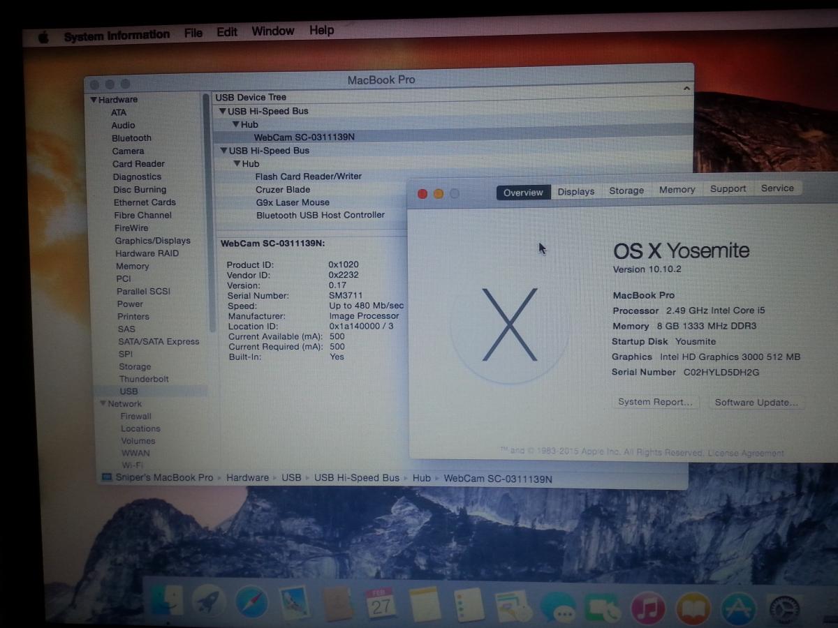

I managed to boot into yousmite finally ... had to put more kexts in 10.10 folder and used more boot arguments from clover configurator app (kext dev mode 1 and usb fix on )
So far so good
Now the other dellima : yousmite can see my camera and bluetooth , elcapitan dont
What should i do ?
you need to compare the IOReg data from both systems and see the differences using IORegisryExolorer or IOJones, El Capitan uses a completely different addressing for USB devices and you might need to add some DSDT patches for renaming the resources used by El Capitan.

USB fix is now ok on elcapitan , all usb devices working
Solution : eh01 and eh02 patches in config.plist and use usbinjectall.kext from rehabman
Bluetooth and camera working now on elcapitan
