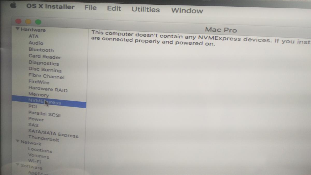

my usb installer (clover etc.) doesnt see my Samsung SSD SM951-NVMe drive - m.2 slot on asrock x99m extreme4 with newest bios 3.0 (which sees the m2 ssd as nvme in bios)

that does not work so far,
what i've done:
I've used the latest 10.11.5 from appstore,
created the usb installer with my hackintosh 10.10.5 (signature), installed the latest clover v2.3 r3526,
used your config but with nv_disable=1 and verbose information (gtx 970 on the x99 build),
and just the latest fakesmc.kext in 10.10, 10.11. and /other,
why kext in 10.10 for el capitan? because I'm not sure which kext is loaded since the newest clover version has this information in configuration boot up: "Set OS Version if not: 10.10.10", if i dont tell clover to use 10.11.5 it does not boot up

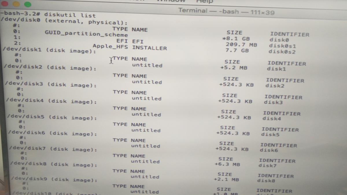

1st try: installer boots up with fakesmc.kext and your config.plist and my additions, i dont see the NVME drive:
and diskutil (with or without ssd from win 10 - same result):

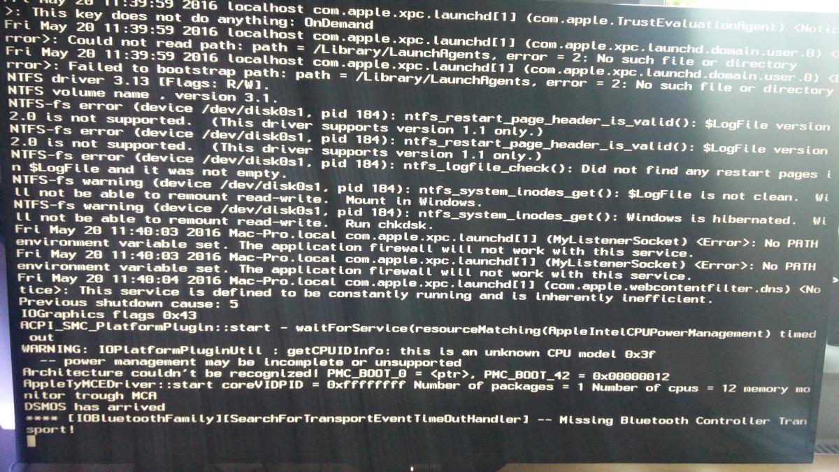

2nd try: like 1st but with NVMeGenerics.kext, no boot up, it holds at

hey moviemakergr, i would have guessed that you are using the xhci version of the m2 ssd ... I'm up and running with my x99m extreme4 on my normal ssd connected to icha sata3 port, with genericnvme.kext i can access my nvme ssd as external drive but no boot up etc.
