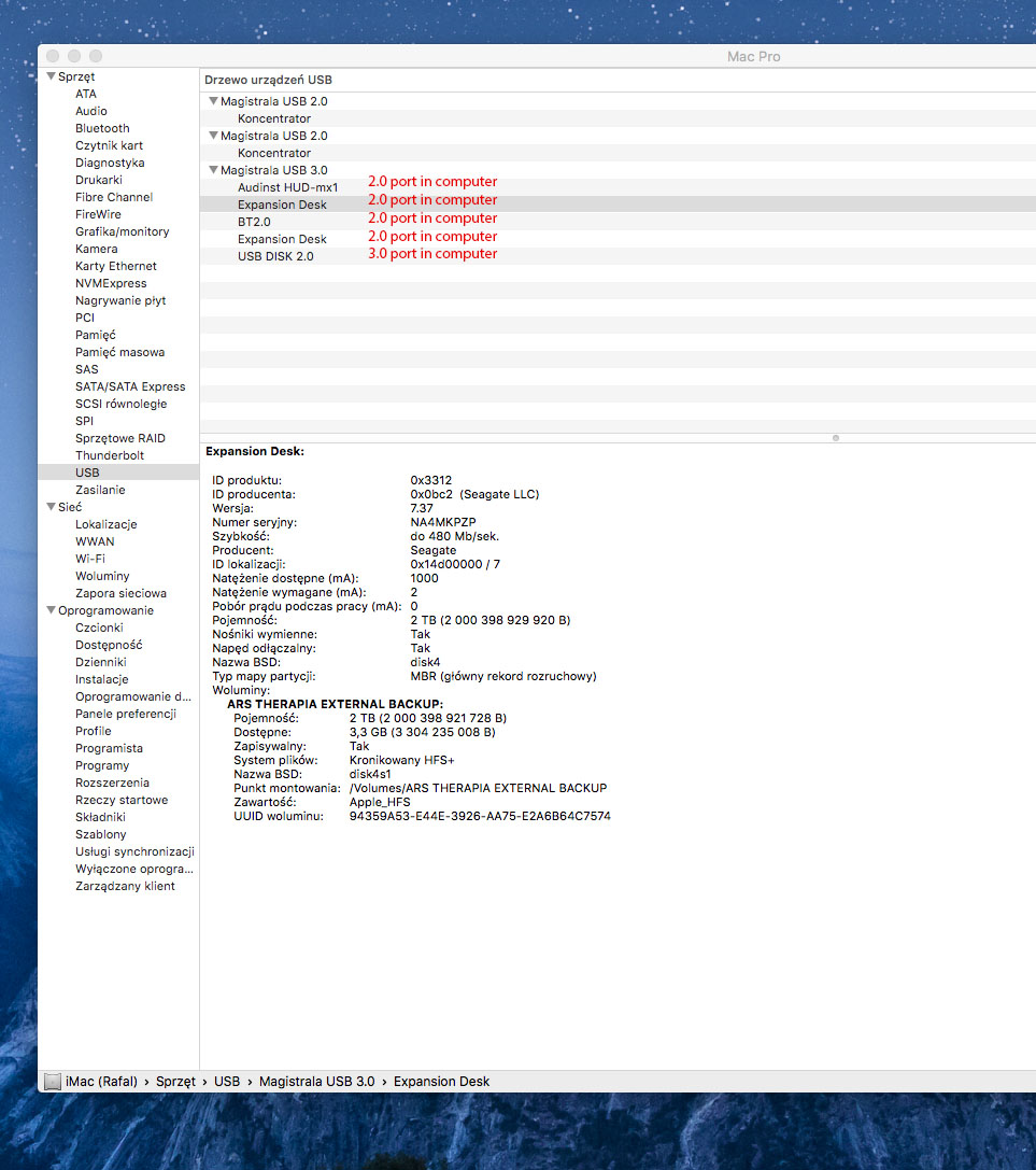

arstherapia Posted January 24, 2016 Author Share Posted January 24, 2016 That's strange. I have only 2 external drives via USB 3.0, which I can employ to test the ports, and they don't mount when plugged in usb 3.0 port. They mount though when plugged into usb 2.0. In system report there is a total mes... I connected 5 things, 4 of which are plugged in usb 2.0 port at the back of the computer, but computer tells me it is usb 3.0 ... wtf ? Link to comment Share on other sites More sharing options...
arstherapia Posted January 24, 2016 Author Share Posted January 24, 2016 Anyone? Please. Give me a hint. Now I have become disoriented. Maybe I have usb 3.0 ports working, it's just the seagate external drives causing problems ? Link to comment Share on other sites More sharing options...
