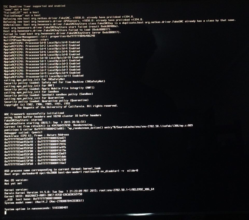

mclbautista Posted December 26, 2015 Share Posted December 26, 2015 Hi guys, this is my first post here. Thankfully because of this forum and many other resources online, I was able to build my second hackintosh. I used these parts: Asus x99-Pro/U3.1 i7-5820K 32GB DDR4 Ram GTX Titan Black Yosemite 10.10.5 I use this rig primarily for video stuff, ie. editing,grading, vfx Last night, I downloaded Xcode (so i could change the Clover theme), and the Pro Video Apps update (for FCP7 etc). After that the machine prompted a restart, so I did. It wouldn't boot afterwards. I'll attach a picture of the verbose boot screen when it hangs. I also can't post a config.plist as I brought my rig to my parent's house for Christmas and I don't have any available boot USBs to get inside my OSX install. But if it helps, I can try later on. I hope you guys can help me figure this out, I really need to work on something here over the holidays. pretty stupid of me not to backup first. Let me know if there's more information I can supply. Cheers Link to comment https://www.insanelymac.com/forum/topic/310048-system-uptime-in-nanoseconds-hang-after-xcode-download-and-update-of-pro-apps-osx-10105/ Share on other sites More sharing options...

spakk Posted December 26, 2015 Share Posted December 26, 2015 Hi guys, this is my first post here. Thankfully because of this forum and many other resources online, I was able to build my second hackintosh. I used these parts: Asus x99-Pro/U3.1 i7-5820K 32GB DDR4 Ram GTX Titan Black Yosemite 10.10.5 I use this rig primarily for video stuff, ie. editing,grading, vfx Last night, I downloaded Xcode (so i could change the Clover theme), and the Pro Video Apps update (for FCP7 etc). After that the machine prompted a restart, so I did. It wouldn't boot afterwards. I'll attach a picture of the verbose boot screen when it hangs. I also can't post a config.plist as I brought my rig to my parent's house for Christmas and I don't have any available boot USBs to get inside my OSX install. But if it helps, I can try later on. I hope you guys can help me figure this out, I really need to work on something here over the holidays. pretty stupid of me not to backup first. Let me know if there's more information I can supply. Cheers install the latest NVIDIA WebDriver for Yosemite 10.10.5, after the installation then boot your system with: kext-dev-mode=1 -v -f nvda_drv=1 ...there may also be a cache problem? I'm not a programmer but .. mp_rendezvous_action () .... with mp.c and tsc.c ??? Link to comment https://www.insanelymac.com/forum/topic/310048-system-uptime-in-nanoseconds-hang-after-xcode-download-and-update-of-pro-apps-osx-10105/#findComment-2200457 Share on other sites More sharing options...
mclbautista Posted December 27, 2015 Author Share Posted December 27, 2015 Fixed! The update made my Nvidia Web Drivers incompatible, so my monitor would lose signal after loading OSX. Used a Linux USB to change my config.plist to boot with nv_disable=1, and was able to get in and update the drivers. Link to comment https://www.insanelymac.com/forum/topic/310048-system-uptime-in-nanoseconds-hang-after-xcode-download-and-update-of-pro-apps-osx-10105/#findComment-2200720 Share on other sites More sharing options...
