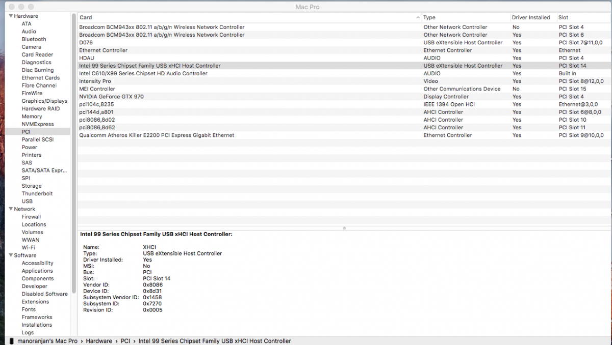

nmano Posted May 20, 2016 Author Share Posted May 20, 2016 All slot worked without "AAPL,slot-name", Name (_SUN, 0x06) // _SUN: Slot User Number\n then 7,8,9, 0xA, 0xB... for each interesting DeviceDSDT patch for X99 All in oneGet tool MaciASL Set ACPI Specification 5.1 with patchBefore apply this patch you have to change devices name.(Set ACPI Specification 4.0)# 1. Under Device BR3A - Verify IOReg/H000# 2. Rename device H000 to device IGPU# 3. Rename device H001 to device HDA1 (Nvidia/AMD HDMI audio)# 4. Enter Compile # 5. Look Compile summary just click each red line and Insert IGPU and HDA1.# I Run this patch for X99-Gaming G1 WIFI without any Errors.(Set ACPI Specification 5.1)0 Errors 0 WarningsDSDT credit to RehabMan, PJALM,PikeRAlpha,Slice,Toleda and other developer patches XHCI for USB 3DTGPHDEFHDAUHID/CIDEHC1EHC2HPETRTCIRQsRENAMED DEVICESSMBUSSHUTDOWNREMOVED DEVICESLPCFIX WARNINGS All.txt 1 Link to comment https://www.insanelymac.com/forum/topic/310006-x99-gigabyte-dsdt-patches/#findComment-2239363 Share on other sites More sharing options...
