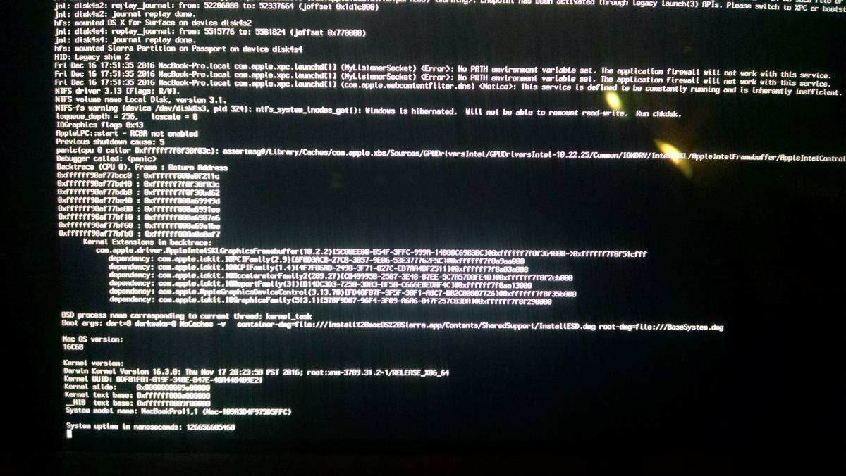

liuq Posted December 12, 2016 Share Posted December 12, 2016 wonder if you have any success with sierra, had kernel panic during usb booting on HD 520. ok. So far my Surface 4 Pro with El Captain works well. Now next step is to update to Sierra and do not have a big crash. All needed data is backed up BTW: Time Machine was slow as hell so I used my own logic to back up all important data. If the the problem with type cover and wake up still extsist on Sierra I will write a little software to wake up the driver. I have installed a similar for audio and it works great. So if you know the kexts that control the type cover, please let me know. I want to start a branch to try to port the linux Touch driver to mac. It looks not impossible so far. If someone already started it, please let me know. Iam willing to join. I have some good experience in Mac development. Just check: www.ifoerster.com Link to comment https://www.insanelymac.com/forum/topic/309890-guide-1011-el-capitan-on-the-surface-pro-4/page/9/#findComment-2332935 Share on other sites More sharing options...

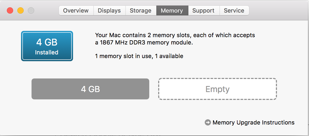

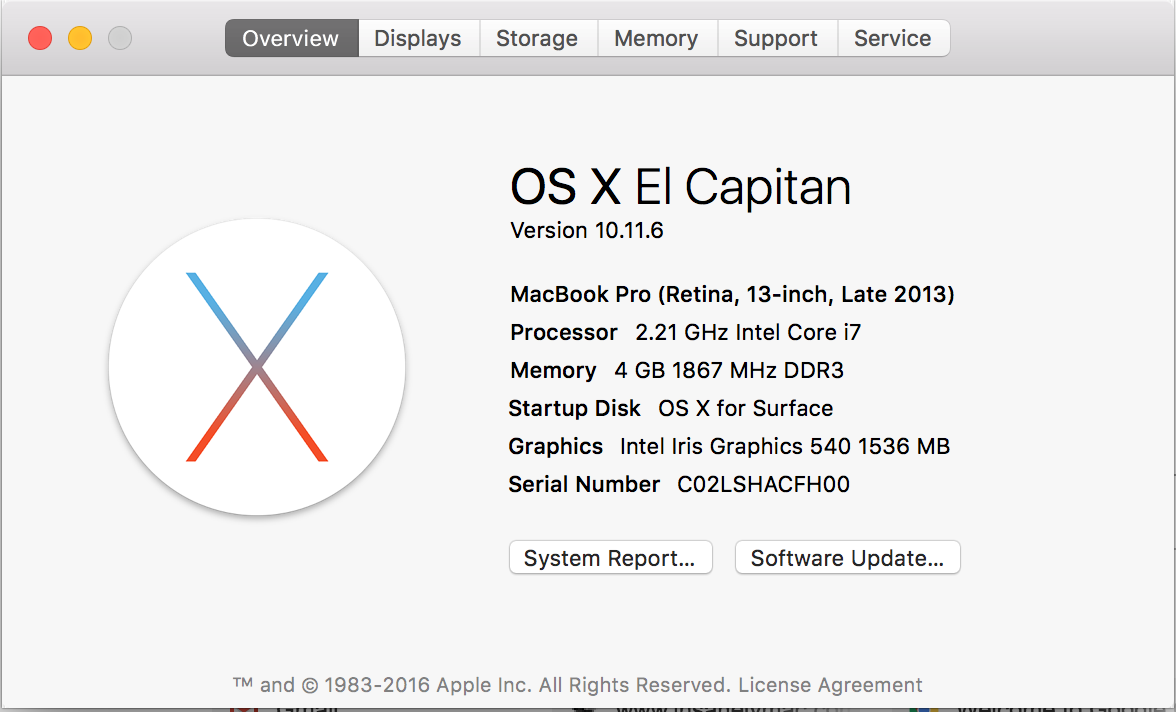

mehoo462 Posted December 17, 2016 Share Posted December 17, 2016 I'm grateful for all the activity on this thread. My SP4 finally arrived (i7 / 8GB RAM / 256GB HD). I've been looking forward to jumping into this given all the information here. Since my specs are the same as Kaiou's I was planning to follow his build as close as possible. I didn't have access to a Sierra installer so my first step was to see if I could install El Capitan to an External Drive. I was successful in booting El Capitan, but unsuccessful in installing Sierra. Here's what happened, in case it's helpful to others. Problem is at the bottom, in case anyone can help. Thanks! Set Up USB Stick On another Mac I used the command from the original post to copy El Capitan 10.11.6 installer to my USB stick. Installed Clover with the custom options in this guide: https://eladnava.com/install-os-x-10-11-el-capitan-on-hackintosh-vanilla/ (dunno how much of this mattered) Deleted the Clover folder from the EFI partition of the USB stick. replaced it with Kaiou's Clover folder from post #178 copied the contents of kexts\10.12 to kexts\10.11 (dunno how much of this mattered) Set Up SP4 Disabled bitlocker and set up SP4 EFI per instructions in the original post Booted to USB stick. Booted El Capitan Installer Install El Capitan (USB stick and 1TB WD Passport plugged into a USB Hub) The installer loaded without issue. Took a few minutes. El Capitan Installed and booted without Issue. Results Overall, I'm quite pleased. I can corroborate some of the issues others report: no onboard sound (have not tried ifoerster's fix) no onboard wifi (success with USB Wifi TP-Link Archer T2U after installing software utility from manufacturers site) no touchscreen no multitouch on the track pad (usb mouse works fine) system does not wake up after hibernation upon closing the type cover. Kaiou's battery monitor works on El Capitan. The system properly detects Iris 540 Graphics in El Capitan. Issues Some other weird things I noticed. I'm wondering how much of this is because Kaiou configured his EFI folder for Sierra: The big one is that the system only detects 4gb of RAM. Can anybody advise on what's causing that? (see pics attached) Also, there are some very minor graphics artifacts around the menu bar at the top. This only appears with the menu bar. Applications and media all look great. (see pics attached) With El Capitan installed I was able to download a Sierra Installer from the Appstore. I wasn't expecting any problems here because now I would be copying Kaiou's install exactly. Sadly no luck. Using Kaiou's Clover folder to install Sierra on an i7/8GB/256 I get a kernel panic while waiting for the installer to load. (see pics attached) Would be nice to install Sierra. And will probably try installing El Capitan on the local disk at some point. The menu bar artifacts are easy to ignore. But the biggest thing right now is probably the 4GB memory. If anybody can offer something to try, I'd love to get that sorted out. Thanks again for all the work people have done on this. I'm glad to be able to run my Mac Apps on my Surface! Link to comment https://www.insanelymac.com/forum/topic/309890-guide-1011-el-capitan-on-the-surface-pro-4/page/9/#findComment-2335611 Share on other sites More sharing options...

mehoo462 Posted January 15, 2017 Share Posted January 15, 2017 Here's my EFI. Installs smoothly on i7 / Intel Iris 540. Based on Kaiou's from post #178. Differences: I wasn't able to get it to install to the local SSD. So I edited Kaiou's config.plist to remove entries pertaining to ionvme, and used hackrnvme.kext generated by rehabman's script. Then it installed to SSD without a problem. I edited the SMBIOS in config.plist to show 8GB of memory. Dunno if it makes a performance difference, but it makes me feel better. I had the best luck with this one of all the EFI's on this thread. YMMV on other processors, but if you're on an i7 give this a shot, and let me know. https://drive.google.com/drive/folders/0B4hZVohgqEw6TXJGR1hmcVFjSnc?usp=sharing (i guess google drive might block the download because it detects a virus. there's no virus. see iofoerster's post #174 for help) Thanks again for all the valuable contributions in this thread. I decided to purchase my SP4 based on the information here that suggested this was possible. I'm extremely pleased with the result. 2 Link to comment https://www.insanelymac.com/forum/topic/309890-guide-1011-el-capitan-on-the-surface-pro-4/page/9/#findComment-2349440 Share on other sites More sharing options...

mssmison Posted February 1, 2017 Share Posted February 1, 2017 To boot the Sierra installer change your platform id to 0x12345678. I'm going to work on putting together a folder with all the files/bits I've used this weekend which should help. 1 Link to comment https://www.insanelymac.com/forum/topic/309890-guide-1011-el-capitan-on-the-surface-pro-4/page/9/#findComment-2361087 Share on other sites More sharing options...
