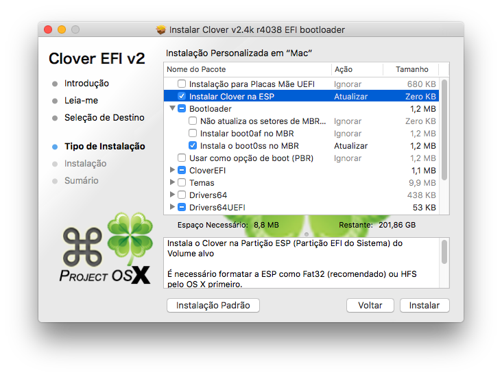

MaLd0n Posted March 15, 2017 Share Posted March 15, 2017 Create ur usb stick with it http://www.insanelymac.com/forum/files/file/559-flash-drive-maker/ Install Clover in USB stick with option put files in correct folder CLOVER.zip Enable USB support in bios Link to comment https://www.insanelymac.com/forum/topic/309787-elcapitan-10112-on-ga-945gcm-s2c/#findComment-2385209 Share on other sites More sharing options...
SLEV7N Posted March 15, 2017 Share Posted March 15, 2017 Create ur usb stick with it http://www.insanelymac.com/forum/files/file/559-flash-drive-maker/ Install Clover in USB stick with option 01.png put files in correct folder CLOVER.zip Enable USB support in bios i managed to boot the install with enoch, but i get a kernel panic from intelpowermanager, i guess is not loading the nullpowermanagement kext , i will re-download sierra app and try your method and report back Link to comment https://www.insanelymac.com/forum/topic/309787-elcapitan-10112-on-ga-945gcm-s2c/#findComment-2385212 Share on other sites More sharing options...

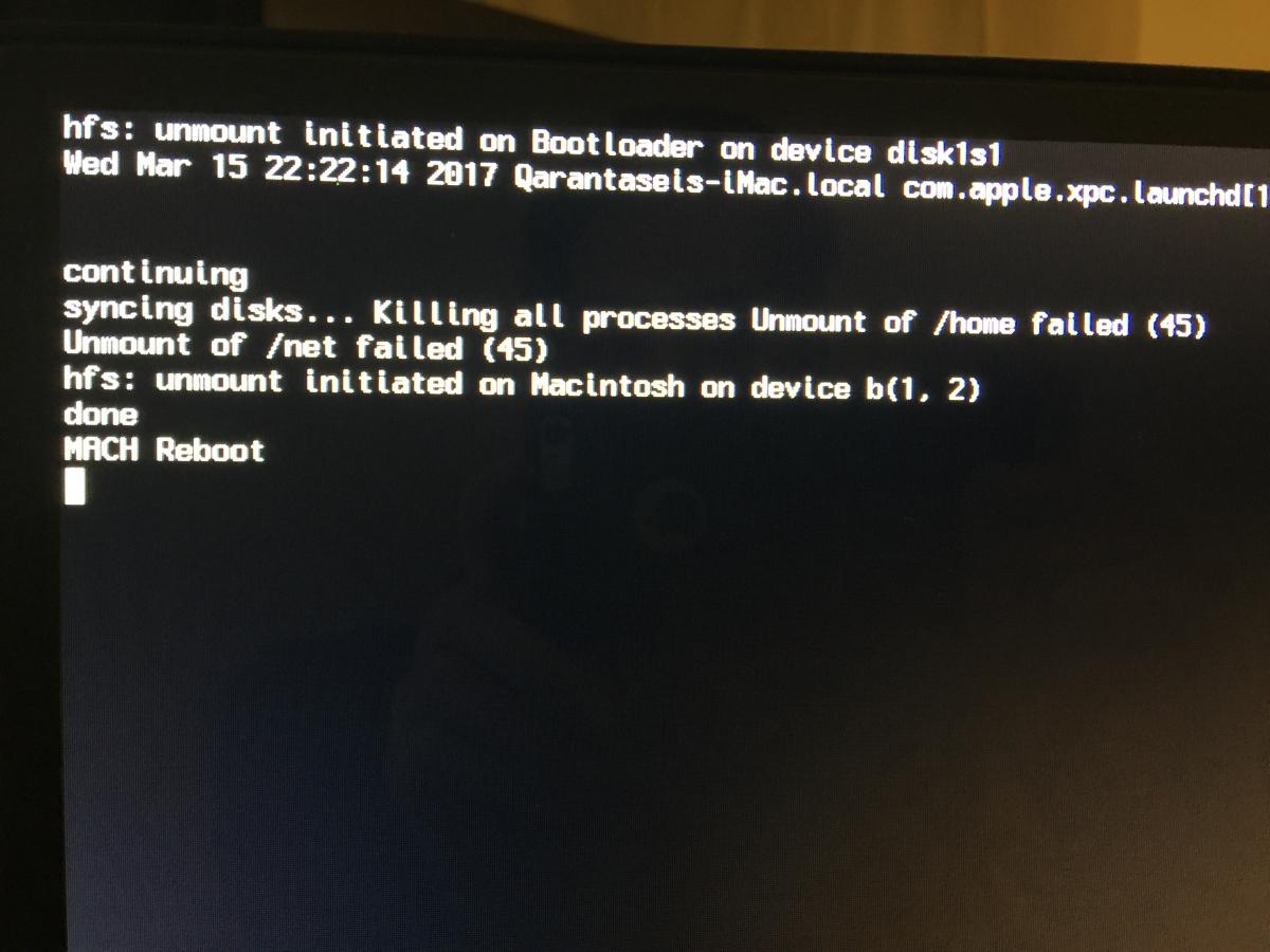

SLEV7N Posted March 16, 2017 Share Posted March 16, 2017 Replace full folder CLOVER.zip Reboot after reboot Post Ioreg http://www.insanelymac.com/forum/index.php?app=core&module=attach§ion=attach&attach_id=222606 i get an instant reboot after verbose and when i get to boot i get artifacts the a reboot Edit: reinstalled[the system but when i erase the clover folder and put your in i get this (image) edit2: i used the clover folder from the usb installer and added the rtl8111 kext. but no internet still , vodoo kext gives kernel panic and i think i don't need it cause i use usb mouse and keyboard (the problem is during clover, i cant use usb mouse or keyboard to select volume to boot) Link to comment https://www.insanelymac.com/forum/topic/309787-elcapitan-10112-on-ga-945gcm-s2c/#findComment-2385290 Share on other sites More sharing options...
MaLd0n Posted March 16, 2017 Share Posted March 16, 2017 The image is in shutdown process? What u use in GPU? DVI or VGA? after install follow it http://www.insanelymac.com/forum/topic/309787-elcapitan-10112-on-ga-945gcm-s2c/?p=2385209 and put kexts, config.plist and DSDT dont replace full folder, try it Link to comment https://www.insanelymac.com/forum/topic/309787-elcapitan-10112-on-ga-945gcm-s2c/#findComment-2385398 Share on other sites More sharing options...

SLEV7N Posted March 16, 2017 Share Posted March 16, 2017 yep with custom dsdt i get MACH reboot 1 Link to comment https://www.insanelymac.com/forum/topic/309787-elcapitan-10112-on-ga-945gcm-s2c/#findComment-2385576 Share on other sites More sharing options...
MaLd0n Posted March 16, 2017 Share Posted March 16, 2017 TRY DSDT.aml.zip AppleALC.kext.zip 1 Link to comment https://www.insanelymac.com/forum/topic/309787-elcapitan-10112-on-ga-945gcm-s2c/#findComment-2385582 Share on other sites More sharing options...
SLEV7N Posted March 16, 2017 Share Posted March 16, 2017 TRY DSDT.aml.zip AppleALC.kext.zip TRY DSDT.aml.zip AppleALC.kext.zip is a no go on that dsdt either, i tried using bootflag cpus=1 but i still get stuck in MACH reboot Link to comment https://www.insanelymac.com/forum/topic/309787-elcapitan-10112-on-ga-945gcm-s2c/#findComment-2385615 Share on other sites More sharing options...
MaLd0n Posted March 16, 2017 Share Posted March 16, 2017 very strange try with npci=0x2000 i have gt220 and work only with flag in my Ga 945 and work only in vga, dvi dont work 1 Link to comment https://www.insanelymac.com/forum/topic/309787-elcapitan-10112-on-ga-945gcm-s2c/#findComment-2385639 Share on other sites More sharing options...
