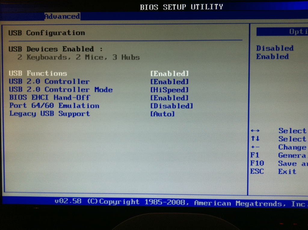

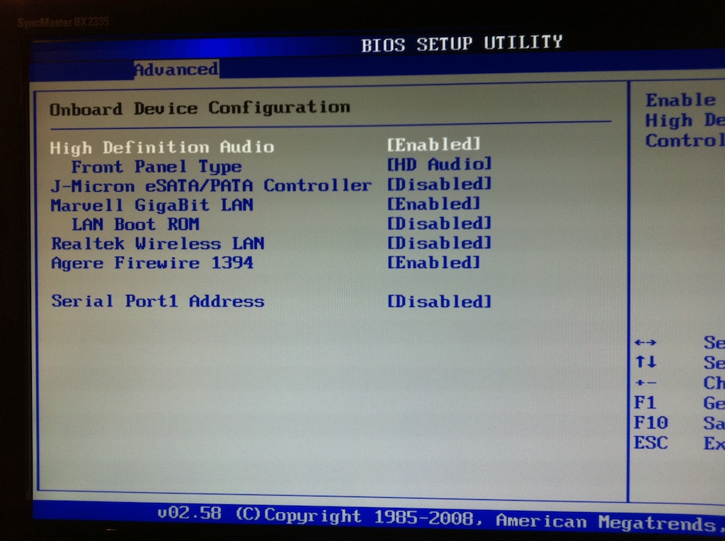

Jolly Posted November 22, 2015 Share Posted November 22, 2015 Controlliamo il Bios. Ti metto due immagini che dovrebbero essere similari. Prima controlla USB e vedi se i setting sono uguali, se sono uguali passa allo "step 2", altrimenti cambiali come da immagine, salva, riavvia e vedi se funziona lo sleep. Step 2: disabilitiamo il Jmicron, come da immagine allegata. Vediamo se il problema è questo Link to comment https://www.insanelymac.com/forum/topic/309362-premendo-stop-si-risveglia-immediatamente/page/3/#findComment-2190850 Share on other sites More sharing options...
voodo1 Posted November 22, 2015 Author Share Posted November 22, 2015 niente da fare Link to comment https://www.insanelymac.com/forum/topic/309362-premendo-stop-si-risveglia-immediatamente/page/3/#findComment-2190871 Share on other sites More sharing options...

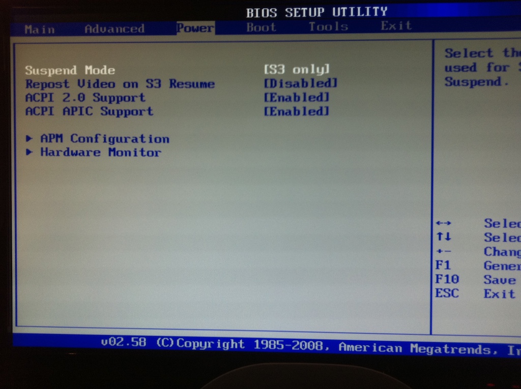

carbo178 Posted November 22, 2015 Share Posted November 22, 2015 Sempre nel bios, nella parte power (credo) dovrebbe esserci resume from sleep, da impostare su S3 only USB legacy da auto ad Enabled Link to comment https://www.insanelymac.com/forum/topic/309362-premendo-stop-si-risveglia-immediatamente/page/3/#findComment-2190873 Share on other sites More sharing options...
Jolly Posted November 22, 2015 Share Posted November 22, 2015 Quante cose da ricordare: 1 Link to comment https://www.insanelymac.com/forum/topic/309362-premendo-stop-si-risveglia-immediatamente/page/3/#findComment-2190875 Share on other sites More sharing options...
voodo1 Posted November 22, 2015 Author Share Posted November 22, 2015 ok lo impostate cosi ma sempre lo stesso. 2015-11-22 20:19:38 +0100Assertion status system-wide: BackgroundTask 0 ApplePushServiceTask 0 UserIsActive 0 PreventUserIdleDisplaySleep 0 PreventSystemSleep 0 ExternalMedia 0 PreventUserIdleSystemSleep 0 NetworkClientActive 0 InternalPreventSleep 1Listed by owning process: pid 49(powerd): [0x000002bc000d02e3] 00:00:22 InternalPreventSleep named: "com.apple.powermanagement.acwakelinger" Timeout will fire in 23 secs Action=TimeoutActionReleaseKernel Assertions: 0x4=USB id=508 level=255 0x4=USB mod=01/01/70, 01:00 description=com.apple.usb.externaldevice.1d100000 owner=USB Optical Mouse id=509 level=255 0x4=USB mod=01/01/70, 01:00 description=com.apple.usb.externaldevice.3d200000 owner=Logitech USB KeyboardIdle sleep preventers: IODisplayWrangler Link to comment https://www.insanelymac.com/forum/topic/309362-premendo-stop-si-risveglia-immediatamente/page/3/#findComment-2190879 Share on other sites More sharing options...
