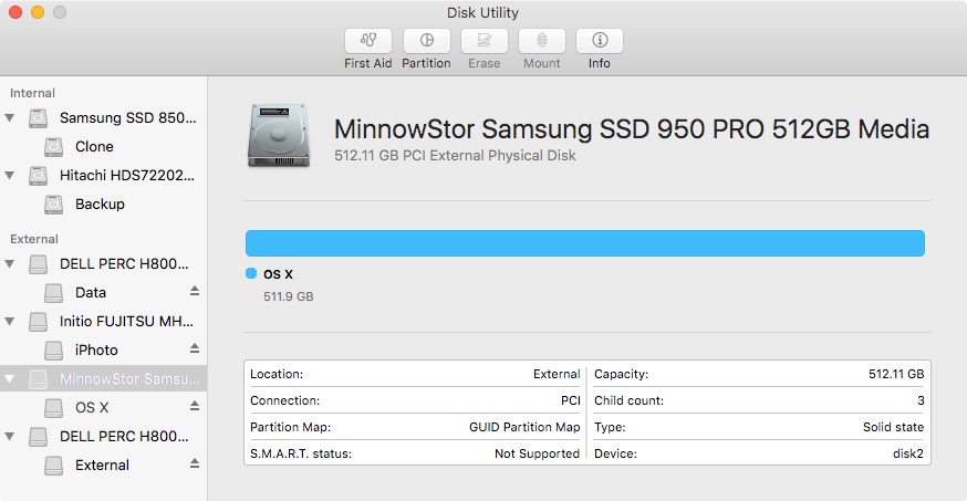

Brabbelbla Posted February 26, 2016 Share Posted February 26, 2016 Out of curiosity: does the NVMe drive show up as internal or external with those it works for? Link to comment https://www.insanelymac.com/forum/topic/309311-nvme-express-digging/page/5/#findComment-2218504 Share on other sites More sharing options...
AppleIIGuy Posted February 26, 2016 Share Posted February 26, 2016 External. Link to comment https://www.insanelymac.com/forum/topic/309311-nvme-express-digging/page/5/#findComment-2218543 Share on other sites More sharing options...

00angus Posted July 3, 2016 Share Posted July 3, 2016 I'm on a Intel NUC6i5syh booting from a NVME 950 PRO using Clover and NVMeGeneric driver Everything looks super, performance is fantastic ... but my disk is seen as an external one. My main concern is with TRIM for the NVME drive. Is it enabled, how can I check it out? 1) the NVME drive do not show up in System Information: a. it's not under "NVMExpress" listing ("This computer doesn't contain any NVME...") b. it's not under "PCI" listingc. it's not under "SATA/SATA Express" (one other drive, a 850 EVO shows up here)d. it does appear under "Storage" with Protocol: PCI 2) I've issued the command "trimforce enable" and the disk 850 EVO -- in point [c.] above -- appears with Trim!3) But for the NVME 950 PRO there is not report Should I be afraid of using my disk this way ? (because of trim) Thanks Link to comment https://www.insanelymac.com/forum/topic/309311-nvme-express-digging/page/5/#findComment-2247425 Share on other sites More sharing options...
