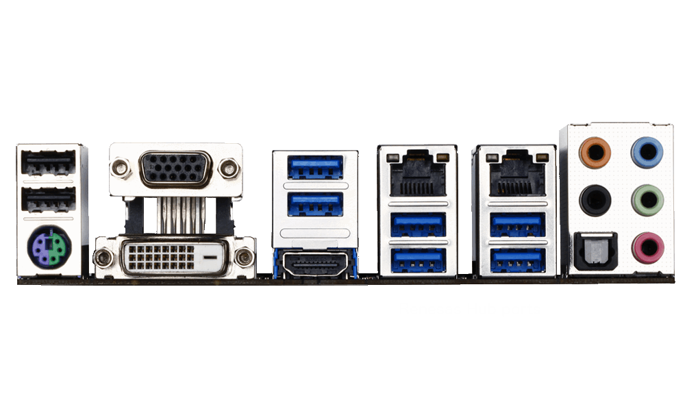

I dont have any USB3.0 enabling kexts installed.
System Specs:
i7-4790
GA-Z97X-UD5H
32 Gb Ram
GTX 970
Highpoint 644ls

So it seems to be working now.
I had to search for similar motherboard users on 10.11 to find the fix.
It involved a Clover Kext patch and some additional kexts installed in /L/E
http://www.tonymacx86.com/user-builds/175075-success-lewyss-build-el-capitan-ga-z97x-ud3h-i5-4690k-16gb-ram-hd-5770-256gb-ssd-bcm94360cd-wifi-bluetooth.html#post1142722
