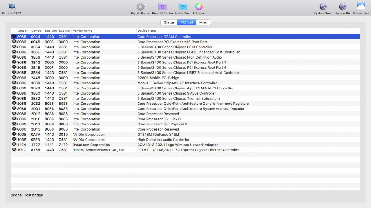

malmsteen74 Posted October 23, 2015 Author Share Posted October 23, 2015 ok postali entrambi per il touchpad prova voodooPS2 Ecco il necessario, grazie La penultima voce di PCI List indica la WiFi interna? Ho speranze di trovare i kext? DarwinDumper_2.9.9b13_Clover_X64_3270.zip DSDT origin.zip Link to comment https://www.insanelymac.com/forum/topic/308975-os-x-el-capitan-su-samsung-rv511/#findComment-2181409 Share on other sites More sharing options...
gengik84 Posted October 24, 2015 Share Posted October 24, 2015 Il Wifi non è compatibile, devi sostituirlo. Ti rimando a questo topic, post 19 vi è l'elenco di quelli compatibili http://www.insanelymac.com/forum/topic/307152-scheda-wifi-broadcom/ Link to comment https://www.insanelymac.com/forum/topic/308975-os-x-el-capitan-su-samsung-rv511/#findComment-2181496 Share on other sites More sharing options...
