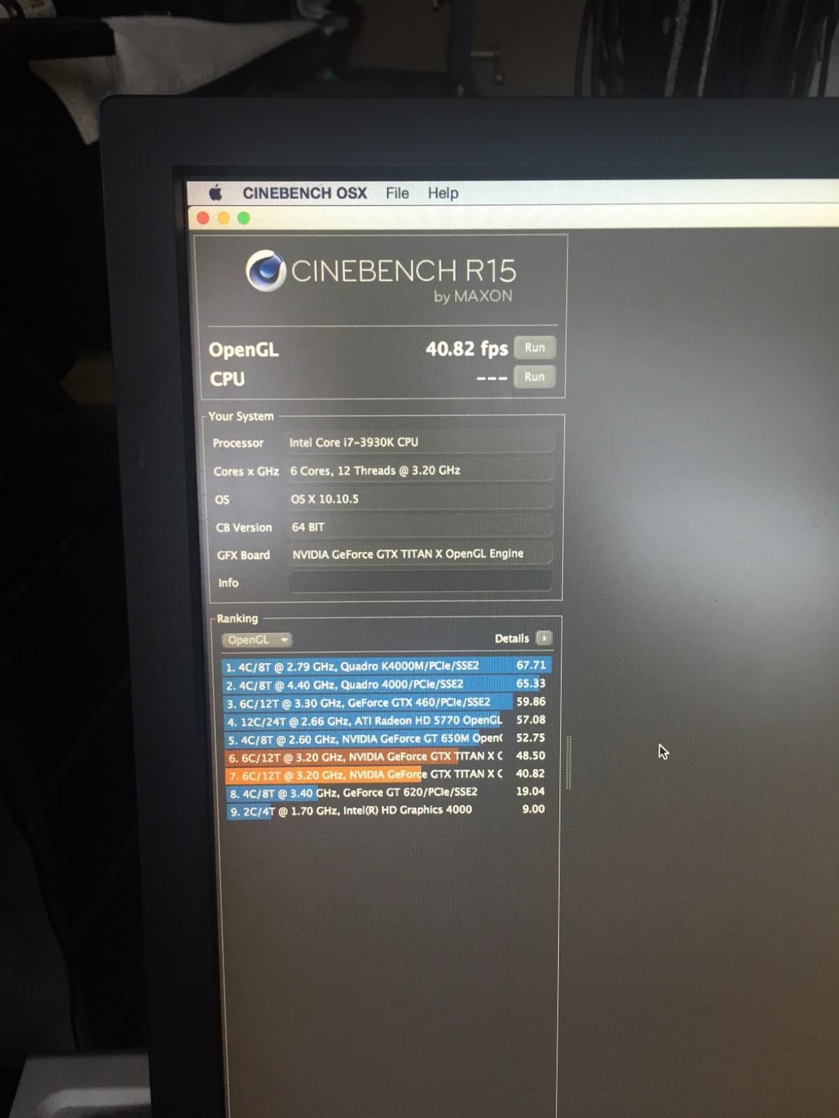

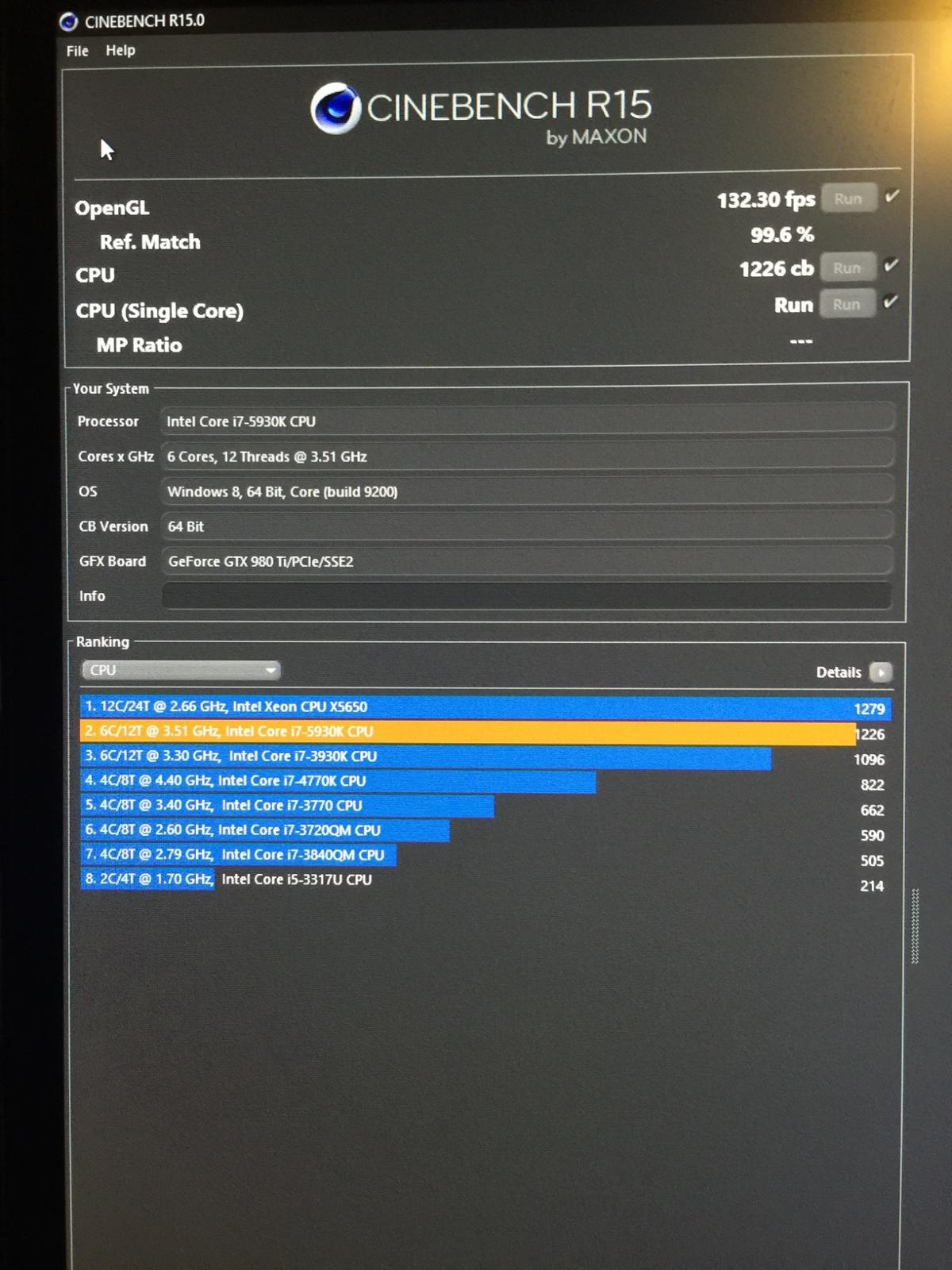

kobe80 Posted October 21, 2015 Share Posted October 21, 2015 Alright this is driving me nuts. I'm running Yosemite with Clover on a Rampage IV Extreme. everything works like a dream except I just put a Titan X in it & it's getting really low Cinebench scores. Im getting 40.82 fps in the last test i did. this other guy with the same setup is getting 132.3 fps. (screenshots attached) Latest nVidia web driver and CUDA drivers are installed. Video output looks clean & it shows resolutions up to 1920x1200 on a 23" lcd, so it *looks like* driver is loading properly. I'm not sure what i'm doing wrong & it's driving me nuts. any ideas? Config.plist and CineBench screenshot attached. if it makes it any easier i'll paste config text below as well. Specs: Rampage IV Extreme (X79) Titan X Yosemite Clover Config.plist text: <?xml version="1.0" encoding="UTF-8"?> <!DOCTYPE plist PUBLIC "-//Apple//DTD PLIST 1.0//EN" "http://www.apple.com/DTDs/PropertyList-1.0.dtd"> <plist version="1.0"> <dict> <key>ACPI</key> <dict> <key>DSDT</key> <dict> <key>Debug</key> <false/> <key>DropOEM_DSM</key> <dict> <key>ATI</key> <false/> <key>Firewire</key> <false/> <key>HDA</key> <false/> <key>HDMI</key> <false/> <key>IDE</key> <false/> <key>IntelGFX</key> <false/> <key>LAN</key> <false/> <key>LPC</key> <false/> <key>NVidia</key> <false/> <key>SATA</key> <false/> <key>SmBUS</key> <false/> <key>USB</key> <true/> <key>WIFI</key> <false/> </dict> <key>Fixes</key> <dict> <key>FixUSB_1000</key> <false/> </dict> <key>Name</key> <string>DSDT.aml</string> <key>ReuseFFFF</key> <false/> </dict> <key>SSDT</key> <dict> <key>DropOem</key> <false/> <key>Generate</key> <false/> </dict> </dict> <key>Boot</key> <dict> <key>Arguments</key> <string>dart=0 npci=0x2000 nvda_drv=1 kext-dev-mode=1 rootless=0 GUI=No</string> <key>Debug</key> <false/> <key>DefaultVolume</key> <string>LastBootedVolume</string> <key>Fast</key> <true/> <key>Legacy</key> <string>PBR</string> <key>Secure</key> <false/> <key>XMPDetection</key> <false/> </dict> <key>Devices</key> <dict> <key>Audio</key> <dict> <key>Inject</key> <string>1</string> </dict> <key>FakeID</key> <dict> <key>ATI</key> <string>0x0</string> <key>IMEI</key> <string>0x0</string> <key>IntelGFX</key> <string>0x0</string> <key>LAN</key> <string>0x0</string> <key>NVidia</key> <string>0x0</string> <key>SATA</key> <string>0x0</string> <key>WIFI</key> <string>0x0</string> <key>XHCI</key> <string>0x0</string> </dict> <key>USB</key> <dict> <key>AddClockID</key> <true/> <key>FixOwnership</key> <true/> <key>Inject</key> <true/> </dict> </dict> <key>DisableDrivers</key> <array> <string>Nothing</string> </array> <key>GUI</key> <dict> <key>Hide</key> <array> <string>\EFI\BOOT\BOOTX64.EFI</string> <string>Windows</string> </array> <key>Language</key> <string>en:0</string> <key>Mouse</key> <dict> <key>DoubleClick</key> <integer>500</integer> <key>Enabled</key> <true/> <key>Mirror</key> <false/> <key>Speed</key> <integer>8</integer> </dict> <key>Scan</key> <dict> <key>Entries</key> <true/> <key>Legacy</key> <false/> <key>Tool</key> <true/> </dict> <key>ScreenResolution</key> <string>2560x1600</string> </dict> <key>Graphics</key> <dict> <key>Inject</key> <dict> <key>ATI</key> <false/> <key>Intel</key> <true/> <key>NVidia</key> <false/> </dict> <key>NvidiaSingle</key> <false/> </dict> <key>KernelAndKextPatches</key> <dict> <key>AppleRTC</key> <true/> <key>AsusAICPUPM</key> <true/> <key>Debug</key> <false/> <key>KernelCpu</key> <false/> <key>KernelHaswellE</key> <false/> <key>KernelLapic</key> <false/> <key>KernelPm</key> <true/> <key>KextsToPatch</key> <array> <dict> <key>Comment</key> <string>External icons patch</string> <key>Find</key> <data> RXh0ZXJuYWw= </data> <key>Name</key> <string>AppleAHCIPort</string> <key>Replace</key> <data> SW50ZXJuYWw= </data> </dict> </array> </dict> <key>RtVariables</key> <dict> <key>BooterConfig</key> <string>0x28</string> <key>CsrActiveConfig</key> <string>0x3</string> </dict> <key>SMBIOS</key> <dict> <key>BiosReleaseDate</key> <string>10/07/10</string> <key>BiosVendor</key> <string>Apple Inc.</string> <key>BiosVersion</key> <string>MP51.88Z.007F.B03.1010071432</string> <key>Board-ID</key> <string>Mac-F221BEC8</string> <key>BoardManufacturer</key> <string>Apple Inc.</string> <key>BoardType</key> <integer>11</integer> <key>ChassisAssetTag</key> <string>Pro-Enclosure</string> <key>ChassisManufacturer</key> <string>Apple Inc.</string> <key>ChassisType</key> <string>06</string> <key>Family</key> <string>Mac Pro</string> <key>Manufacturer</key> <string>Apple Inc.</string> <key>Mobile</key> <false/> <key>ProductName</key> <string>MacPro5,1</string> <key>SerialNumber</key> <string>CK2355BZEUH</string> <key>Trust</key> <false/> <key>Version</key> <string>1.0</string> </dict> <key>SystemParameters</key> <dict> <key>InjectKexts</key> <string>Detect</string> <key>InjectSystemID</key> <true/> </dict> </dict> </plist> config.plist.zip Link to comment Share on other sites More sharing options...

bbeepp Posted November 10, 2015 Share Posted November 10, 2015 Kobe80, you are comparing Windows scores with osx scores which are always lower. Try running cinebench on Windows on your machine to compare the results. Try also to change platform from mac pro to iMac in clover config. Link to comment Share on other sites More sharing options...

delish Posted November 2, 2016 Share Posted November 2, 2016 With Cinebench on osx the GPU test is heavy dependent on both the CPU and memory speed. my old gtx 670 scored almost the same as my 980 ti, thou both beaten by a Radeon 7950. try running Heaven and Valley instead, if you want to test you GPU. Link to comment Share on other sites More sharing options...
