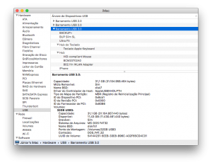

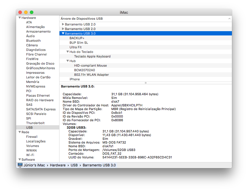

juniorporciuncula Posted October 3, 2015 Share Posted October 3, 2015 I have a Z97M-Plus and all my USB3 ports are working now after installing the "USB Injector for 9 Series kext" using EasyKext Utility Thanks, wegface Link to comment https://www.insanelymac.com/forum/topic/308385-1011-full-speed-usb-z97m-plus/ Share on other sites More sharing options...

juniorporciuncula Posted October 3, 2015 Author Share Posted October 3, 2015 OMG! why bother with a Injector if your gonna do something dum like use a kext installer to put it in SLE lol There is nothing wrong with putting a injector in the SLE. The problem is to modify a native kext in that folder. With a injector, the contents of the folder remains intact. Just confirming that all four rear and two front ports are working at 3.0. ASUS Z97M-PLUS 1 Link to comment https://www.insanelymac.com/forum/topic/308385-1011-full-speed-usb-z97m-plus/#findComment-2172836 Share on other sites More sharing options...
Gogeta5026 Posted October 3, 2015 Share Posted October 3, 2015 There is nothing wrong with putting a injector in the SLE. The problem is to modify a native kext in that folder. With a injector, the contents of the folder remains intact. Just confirming that all four rear and two front ports are working at 3.0. ASUS Z97M-PLUS What exactly did you do in order for your 4 ports in back to work? Would you be able to supply the file you put in SLE? You might be the answer to all my problems this past week! Link to comment https://www.insanelymac.com/forum/topic/308385-1011-full-speed-usb-z97m-plus/#findComment-2172848 Share on other sites More sharing options...
juniorporciuncula Posted October 3, 2015 Author Share Posted October 3, 2015 What exactly did you do in order for your 4 ports in back to work? Would you be able to supply the file you put in SLE? You might be the answer to all my problems this past week! Open EasyKext Utility, type your password, and drag the "USB_Series9_Injector.kext" on window. Restart. USB_Series9_Injector.kext.zip Easykext Utility v2.0.zip 1 Link to comment https://www.insanelymac.com/forum/topic/308385-1011-full-speed-usb-z97m-plus/#findComment-2172852 Share on other sites More sharing options...
