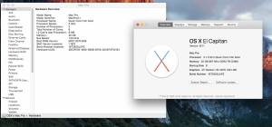

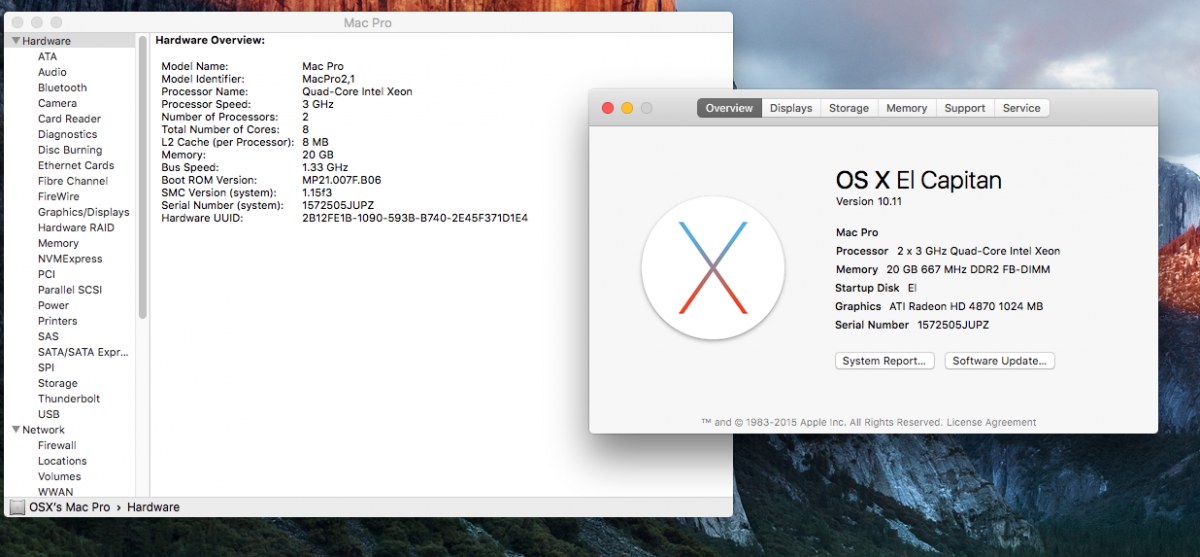

the7dials Posted October 1, 2015 Share Posted October 1, 2015 Hi again I read the latest on Piker Alpha's blog, went to the guide, then ended up running the Clover fix and used the DummyUSBEHCIPCI kext, then rebooted a couple of times and now I have USB. Not exactly sure what did it as I was multitasking. The front USB does not work, but I'll live with only back two ports. Not sure if this made any difference but I added my 2,1 to the list of personalities in the info.plist too. Now I have El Capitan on my 2,1 and peace and freedom is restored to the galaxy. Or at least my obsession for the moment until I feel ambitious to tackle the BT and Airport. Tremendous thanks to Piker Alpha (Very sorry to read about your sister--all the best to you and your family), pokenguyen, stinga111, VCH888 and all the rest for the fantastic work gone into this. Will now have time to send that donation in that I've been meaning to. Take a look at your handy work guys... and good luck. Link to comment https://www.insanelymac.com/forum/topic/308273-no-input-methods-working-when-booting-installer/#findComment-2172009 Share on other sites More sharing options...
