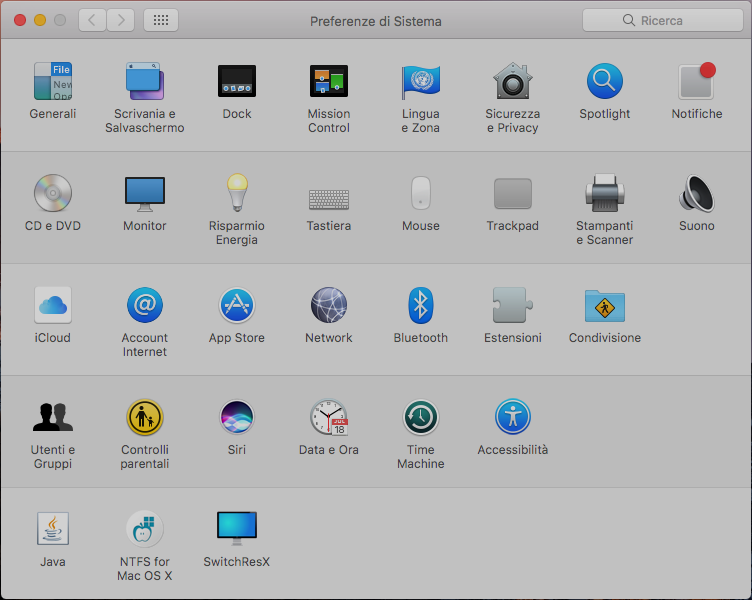

Iperzampem0 Posted February 26, 2017 Share Posted February 26, 2017 I really don't know why, but still in Yosemite the webcam and even the keyboard and touchpad (initially ok!) weren't working at all..... I'm really pissed and now I'm back into Windows 10 but I love MacOS and I'm feeling bad for this. I would really pay for having at least a 90% working Vaio, mostly having a fully recognised display with brightness (adjustable from the slider into Monitor preferences if not from the keyboard) and all the other things except for the Intel wireless (of course) and the SD card reader. EDIT: If it can be useful I've extracted the EDID of my display from Windows and, if I remember correctly, it differs from the one I was seeing into the DSDT on MacOS. This is it: 00 FF FF FF FF FF FF 00 3A C4 00 06 00 00 00 00 2D 0C 01 03 80 20 14 00 EA A8 E0 99 57 4B 92 25 1C 50 54 00 00 00 01 01 01 01 01 01 01 01 01 01 01 01 01 01 01 01 E8 1A 00 82 50 20 0F 30 15 20 44 00 42 C9 10 00 00 18 00 00 00 FC 00 4E 76 69 64 69 61 20 44 65 66 61 75 6C 00 00 00 FC 00 74 20 46 6C 61 74 20 50 61 6E 65 6C 00 00 00 00 FD 00 00 3D 1D 31 07 00 00 20 20 20 20 20 00 00 E0 Link to comment https://www.insanelymac.com/forum/topic/307915-sony-vaio-vgn-fz21m-qeci/page/3/#findComment-2374245 Share on other sites More sharing options...

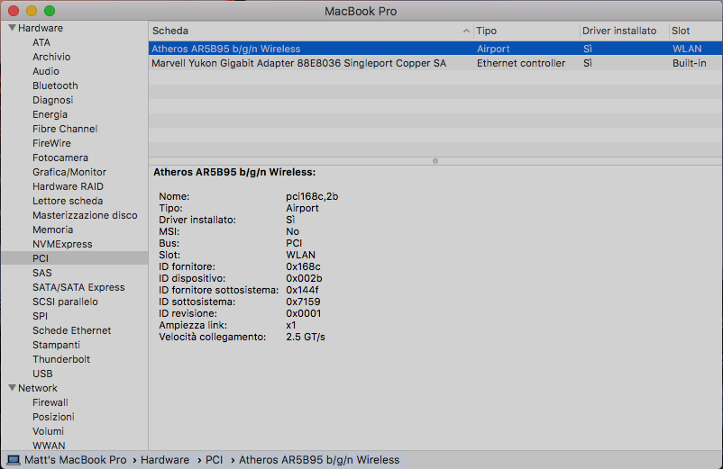

Iperzampem0 Posted March 2, 2017 Share Posted March 2, 2017 Hey guys, I'm back on Sierra after just ONE single attempt (had to rebuild the USB installer, etc.), and it's working generally well like before, but with the same issues. One thing though is that I've been able to configure the old wireless USB dongle that I had, the Sitecom WL-352 v1 (RTL8191S chipset), so I'm surfing the web with Safari and my iCloud account syncing perfectly. I still have to figure out the iMessage thing but right now I don't really care. @Hervé: this time I've used just the same FakeSMC kext as yours, and the USBInjectAll kext from RehabMan and it worked, but still the webcam isn't working and I really don't know why. What I care about though is... how can I make that damn Monitor panel to work? I've tried the "guide" from Tony's website (the one with Sierra's known issues) and I had modified my EDID (into DSDT) to reflect a 13" panel (as it was suggested) but it didn't work, so I tried also the VenID and DevID change directly but at the next reboot I had a completely white screen and to recover I had to load again the USB installer and copy back the unmodified DSDT from the USB to the Extra folder into the SSD. If you're wondering why I'm still asking about this, it's simply because I'd like to change the Monitor's Color Profiles to better reflect colors. Is there another way? One major findings that I want to share with you is that if you install from the Mac AppStore the free app "Brightness Slider" you'll have sort of a working brightness changing mechanism whereas you can also configure 2 buttons on the keyboard to increase and decrease brightness! EDIT: I've installed SwitchResX and now I have the possibility to also change color profiles to better reflect the color gamut. Nice! EDIT 2: well, now I have an Atheros AR9285 (I already had it hidden at home) installed right into the Vaio and fully working on Sierra after a small patch (and thanks to Hervé for the already present DSDT definition). UPDATE: it seems that after a "fresh" (cold) boot the Vaio started recognizing again the ALPS touchpad with the original kexts installed (AppleACPIPS2Nub and ApplePS2Controller) I have also patched the stock Trackpad prefpane (https://www.hackintosh.zone/file/997-correct-preference-pane-trackpad-macos-sierra/) so now it's working perfectly and I can also assign different actions to the touchpad, for example tap2click and even 2-fingers scrolling which is actually working! => One last question... how can I fix wake? Sleep works fine just by closing the lid, but wake screws completely the screen. It could be due to some USB ports not completely recognized and/or some sleep/wake arguments to add while booting!? 1 Link to comment https://www.insanelymac.com/forum/topic/307915-sony-vaio-vgn-fz21m-qeci/page/3/#findComment-2376219 Share on other sites More sharing options...
