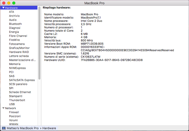

Iperzampem0 Posted February 22, 2017 Share Posted February 22, 2017 @Iperzampem0, SMBIOS of MBP4,1 is indeed closer in terms of specs but incompatible with Sierra. In addition, MBP4,1 SMBIOS does not support vanilla CPU SpeedStep. That's why you should use MBP7,1's. That'll work perfectly with the FakeSMC of the D630 pack (the kext was tuned with SMC keys of MBP7,1) and will be fully compatible with Sierra. Hello, thanks for answering. I've already tried that combination but maybe there was something wrong with other kexts. I will try again and report later. Link to comment https://www.insanelymac.com/forum/topic/307915-sony-vaio-vgn-fz21m-qeci/page/2/#findComment-2371203 Share on other sites More sharing options...

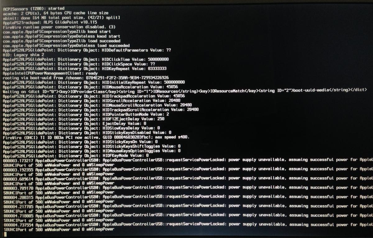

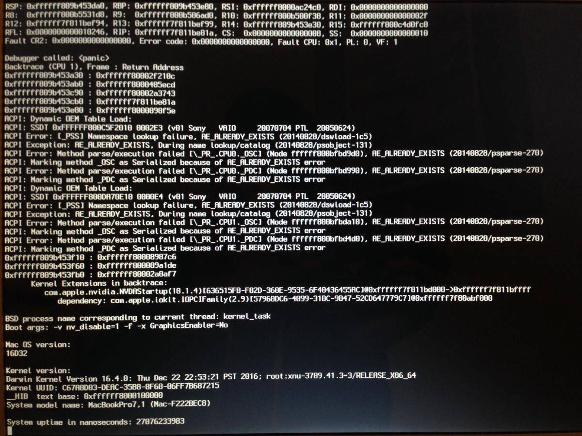

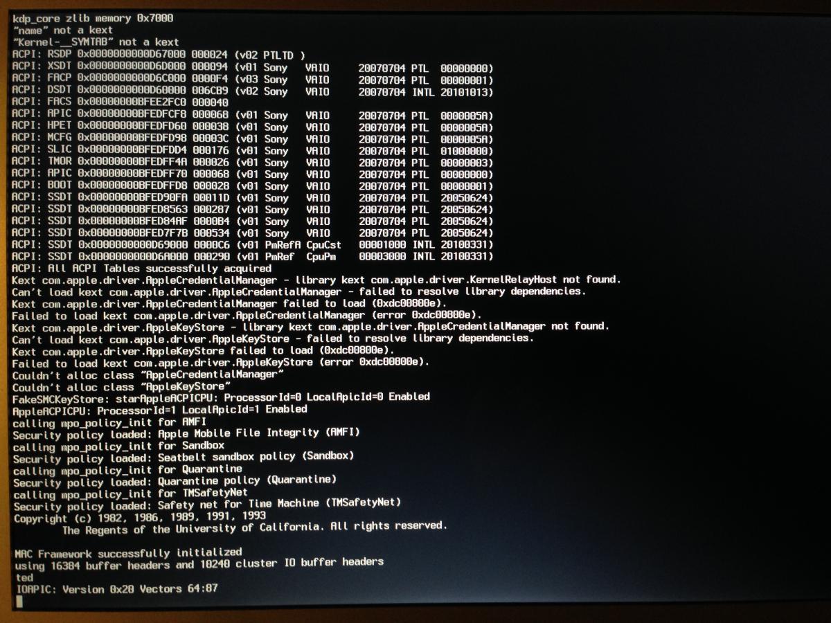

Iperzampem0 Posted February 22, 2017 Share Posted February 22, 2017 This is what I'm getting if I boot with "-v -f -x nv_disable=1 GraphicsEnabler=No". Yea, I know that GraphicsEnabler is not necessary (right?) if I'm using nv_disable=1 and given the fact that I didn't use it into the org.chameleon.boot.plist file. Furthermore I have used -x only to see if the error was the same, and it basically is. Any ideas? I think this is the last obstacle to see the installation screen.. Link to comment https://www.insanelymac.com/forum/topic/307915-sony-vaio-vgn-fz21m-qeci/page/2/#findComment-2371404 Share on other sites More sharing options...
Iperzampem0 Posted February 22, 2017 Share Posted February 22, 2017 No! I would not recommend you use the USB injector kext of my Dell since that was specifically manually prepared for that system. Check your IOReg before you use that as you'll probably need to adjust it for ports under each controller... You should boot with GraphicsEnabler=Yes if you hope to have your nVidia GPU detected and supported... Boot with KernelBooter_kexts=Yes -f -v GraphicsEnabler=Yes. Amazing!!! It actually booted and I'm installing Sierra!! Thanks a lot Hervé, what about after installation? N.B. It's worth noting that my SSD was completely erased before this process and formatted in HFS+ using GParted Live (MBR, not GPT). 1 Link to comment https://www.insanelymac.com/forum/topic/307915-sony-vaio-vgn-fz21m-qeci/page/2/#findComment-2371418 Share on other sites More sharing options...
Iperzampem0 Posted February 22, 2017 Share Posted February 22, 2017 After installation, make sure to: copy the Extra folder from your USB installer to your OS X installation. copy your add-on kexts to /L/E, to repair permissions and rebuild your cache. that way, you won't need KernelBooter_kexts=Yes (nor -f of course). If you play/experience with kexts, always do so in /L/E but always leave /E/E untouched (or only add kexts there once tested and proven). This way, you can always recover by booting with KernelBooter_kexts=Yes -f which injects kexts from /E/E but ignores /L/E. Thank You, I have seen that I need to boot with GraphicsEnabler=Yes and the bad thing is that I don't have neither the keyboard nor the trackpkad working and I just have an external mouse. Can I inject the proper kexts while booting or do I need to re-do the install process? EDIT: LOL if I say to you guys the crazy thing I did you'll laugh a lot I've installed the app Typeeto on the MacBook Air I'm actually typing from (and making all the stuff) which let me share the keyboard of my Mac via Bluetooth and BT is one of the few things working natively on the VAIO Practically I was able to finish the first setup! Just wow! EDIT2: I still have to copy kexts/folders because I'm trying to see what works and not. Basically the good thing is that the Nvidia 8400M GT is fully recognised and working, also the Intel Core 2 Duo at 2.5Ghz and the 4gb of RAM, along with the Bluetooth and all of the other USB ports and the CD/DVD/BD reader/writer. The other things like *mostly* the keyboard, ALPS touchpad, Sigmatel or IDT audio, Ricoh webcam, etc. are not working. Link to comment https://www.insanelymac.com/forum/topic/307915-sony-vaio-vgn-fz21m-qeci/page/2/#findComment-2371430 Share on other sites More sharing options...

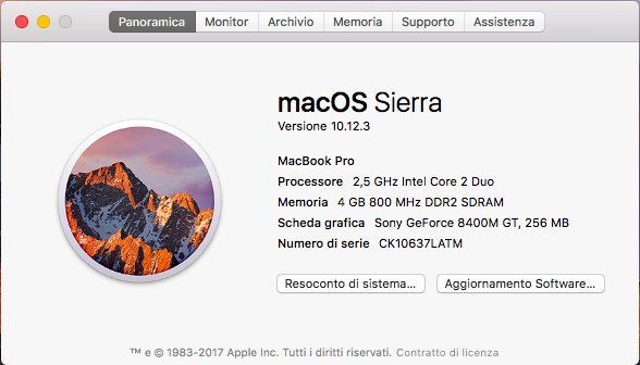

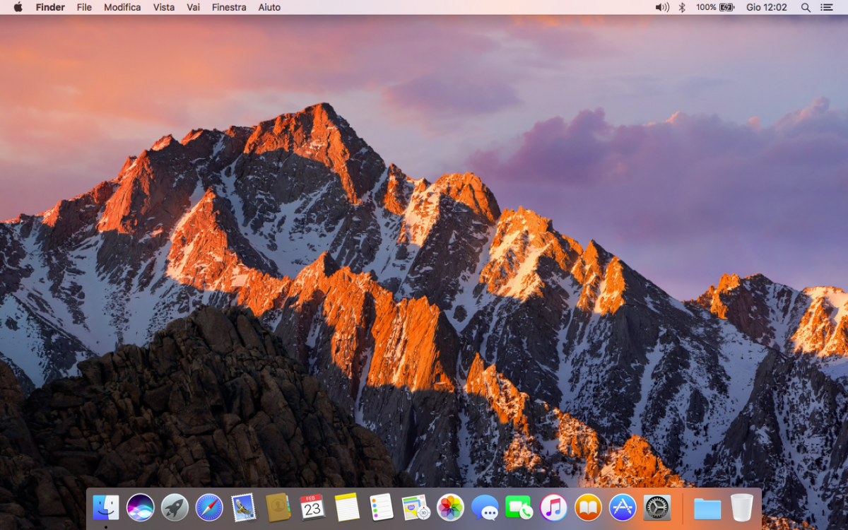

PippoX0 Posted February 22, 2017 Author Share Posted February 22, 2017 Well done. post a picture of installed macOS Sierra on Sony Vaio Link to comment https://www.insanelymac.com/forum/topic/307915-sony-vaio-vgn-fz21m-qeci/page/2/#findComment-2371451 Share on other sites More sharing options...

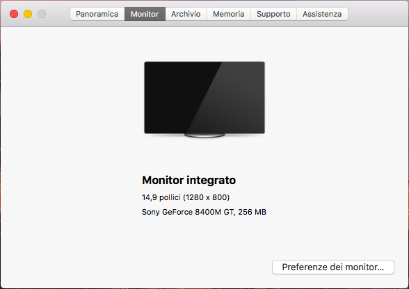

Iperzampem0 Posted February 23, 2017 Share Posted February 23, 2017 Hello again, I have to report a few more developments. --> I've installed Enoch 2848 into the internal SSD so I got rid of the external USB boot; --> I've copied all the necessary kexts into /Library/Extensions and rebuilt the cache (so now /Extra/Extensions is empty and KernelBooter_kexts=No); --> Now all these things are working: Audio, Keyboard, Touchpad (just the mouse pointer works, without the single tap to click and scrolling). So what, now? --> Even though the Nvidia 8400M GT is fully recognised I think that QE/CI is not enabled at all and also the Monitor tab inside the Settings is not accessible (and is registered as a 14,9" monitor instead of 15,6"); but above all I can't change the screen brightness neither from settings nor from the keyboard shortcuts (where just the audio disabling works). --> When booting, I always get this message from the bootloader after having chosen the disk: header read size 200 Incorrect image signature, expected version 10.7 What should I do? If I just press enter or any other key on the keyboard, it boots correctly. --> From "About this Mac" I have seen that the Samsung 830 SSD is correctly recognised but TRIM is disabled; --> Ethernet, Ricoh webcam, SD/MemoryStick reader, are still not working. Not to mention the Intel WiFi 4965agn which will probably never work. --> The bluetooth seems to work fine but I can't disable it from Settings (if I want to disable it, I just have to use the manual switch). I'm really open to further suggestions from all of you to further improve this awesome setup. Thanks again for your help! EDIT: I've also seen that the audio doesn't change automatically if, for example, I plug in the headphones. Always need to change the output source from the audio menu and/or from the Settings. Not a big deal, just reporting. I'm using the two kexts AppleHDADisabler and VoodooHDA. Also I can't use the volume and play/pause buttons on the Apple headphones. Link to comment https://www.insanelymac.com/forum/topic/307915-sony-vaio-vgn-fz21m-qeci/page/2/#findComment-2371742 Share on other sites More sharing options...

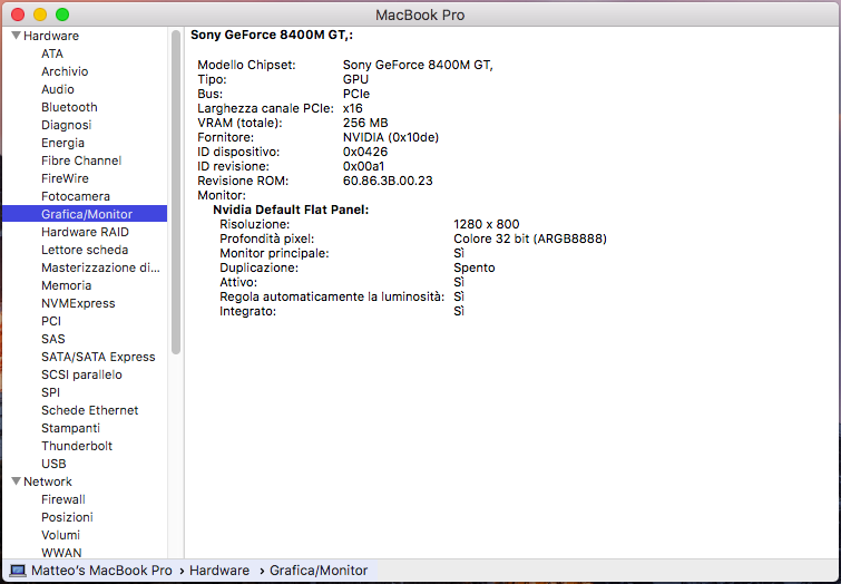

PippoX0 Posted February 23, 2017 Author Share Posted February 23, 2017 Hi, The info of 14,9" monitor instead of 15,6" ,may be related to the smbios.plist you have used .... try another one To verify if QE/Ci is enabled use VideoHardwareInfo VideoHardwareInfo.zip Yukon2.kext must have the right id in info.plist Find it with DPCIManager https://sourceforge.net/projects/dpcimanager/ To enable TRIM run terminal and insert "sudo trimforce enable" for SD/memory Stick reader Try this http://www.insanelymac.com/forum/topic/312536-voodoosdhc-sd-card-reader-for-el-capitan/ One Question: Which is your Bios version ?? Seee Ya Link to comment https://www.insanelymac.com/forum/topic/307915-sony-vaio-vgn-fz21m-qeci/page/2/#findComment-2371794 Share on other sites More sharing options...

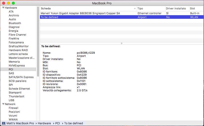

PippoX0 Posted February 23, 2017 Author Share Posted February 23, 2017 Hi, For Ethernet card, you can insert this info.plist in AppleYukon2.Kext inside IONetworkFamily.kext. Copy from /S/L/E to desktop, Patch it and Install back to /S/L/E with kext utility This is for Marvell Yukon Ethernet card 88E8036 Info_8036.zip 1 Link to comment https://www.insanelymac.com/forum/topic/307915-sony-vaio-vgn-fz21m-qeci/page/2/#findComment-2371992 Share on other sites More sharing options...
Iperzampem0 Posted February 23, 2017 Share Posted February 23, 2017 Hi, For Ethernet card, you can insert this info.plist in Yukon2.Kext inside IONetworkFamily.kext. Copy from /L/E to desktop, Patch it and Install back to /L/E with kext utility This is for Marvell Yukon Ethernet card 88e8055 Info.zip Thank you! I'm gonna try it, but don't we have the Marvell Yukon 88E8036 instead? What about the webcam? Link to comment https://www.insanelymac.com/forum/topic/307915-sony-vaio-vgn-fz21m-qeci/page/2/#findComment-2371994 Share on other sites More sharing options...
PippoX0 Posted February 23, 2017 Author Share Posted February 23, 2017 Thank you! I'm gonna try it, but don't we have the Marvell Yukon 88E8036 instead? What about the webcam? Yeah, you are right. I re-upload the right info; look back to my prior post For WebCam : It works under Windows10 ? If Qe/Ci is enabled it should work ... Link to comment https://www.insanelymac.com/forum/topic/307915-sony-vaio-vgn-fz21m-qeci/page/2/#findComment-2372004 Share on other sites More sharing options...
Iperzampem0 Posted February 23, 2017 Share Posted February 23, 2017 Try this for built-in LCD as a proper laptop (backlight) display. DSDT_HD.aml.zip Do I just need to replace the old one into /Extra folder? Looking at it with MaciASL with iAsl 5.1, I can see there're at least 75 errors will it work fine? EDIT: sorry, it was set to iAsl 4.1....... LOL switching to 5.1 gives no errors as it should be. Thanks! @pippox0 : Yes, I've seen, thanks! I'm about to try both the new DSDT and the Yukon patch. Yes, it was working in Windows 10, but right now I have only MacOS installed! Try this for built-in LCD as a proper laptop (backlight) display. DSDT_HD.aml.zip Webcam is natively detected and reported as USB UVC VideoCamera in SysProfiler (dev/ven=0x05ca/0x183b, i.e. 1482/6203 in decimal). Basically, it's the Ricoh device reported in USB section of the SysProfiler. In IOReg, it's visible under port #2 or USB2.0 controller EH02. Since it's a USB-internal device, there are no patches and probably no kexts that can help get the camera working if it ain't working already. I'm afraid it's either supported OOB or not at all... Once you have your LAN/Ethernet port working as en0 interface (or a fake Ethernet as en0), you'll be able to verify webcam behaviour with FaceTime. LAN/Ethernet port is indeed Marvell Yukon GigaEthernet 88E8036 model. Shown in IOReg as device PXSX under parent device RP05 @1c,4 (i.e. at address 0x001C0004). You can easily rename that PXSX device as "GLAN" in your DSDT". Same for the wireless card (Intel 4965AG/AGN at the moment) which is registered as device PXSX under parent device @1C,2 (i.e. at address 0x001C0002). You could also rename that PXSX device to "ARPT" in the DSDT. Mmm ok, with the new DSDT there's an actual MacBook Pro represented in the Monitor section, but I still can't access the Monitor panel inside the Settings which is weird... Really there's no way to adjust the screen brightness, even with Terminal (like in Linux if I remember correctly)?? I'm very "light-sensitive" and I couldn't stay in front of 100% light source for more than a few minutes Other than that, I've manually changed the .plist file inside the Yukon2.kext but if I make the changes you're saying also to the DSDT will it work anyway? And is there a remote chance to have also the Intel 4965agn to work!? EDIT: it seems like I still have no Ethernet according to SystemInfo. I'm about to make those DSDT changes. EDIT2: after changing 5 "PXSX" to "GLAN" the compiler says that I have 4 "syntax error, unexpected PARSEOP_INTEGER" (code 6126). I'm trying to figure out what to change. Link to comment https://www.insanelymac.com/forum/topic/307915-sony-vaio-vgn-fz21m-qeci/page/2/#findComment-2372007 Share on other sites More sharing options...
Iperzampem0 Posted February 23, 2017 Share Posted February 23, 2017 Ethernet now successfully appears into SystemInfo! Webcam still shows a black screen both on PhotoBooth and FaceTime, even though as you said it seems to be recognised.. I need to say other two things: 1) after the new DSDT, I have a 0% battery reporting which is wrong cos it should be 100%. 2) should we try to implement this ACPI Backlight https://github.com/RehabMan/OS-X-ACPI-Backlight to have screen brightness working? I would really like to know how you have saved those 2 new DSDTs with those 4 errors (6126) Another thing though, even if I can see that QE/CI and all the other things are supported, the overall graphics acceleration is extremely slow. I've tried for example to open the Chess game and it's lagging! Not to mention that every time you make a move the pc makes a "buzz" (sort of).. Link to comment https://www.insanelymac.com/forum/topic/307915-sony-vaio-vgn-fz21m-qeci/page/2/#findComment-2372021 Share on other sites More sharing options...
Iperzampem0 Posted February 23, 2017 Share Posted February 23, 2017 NEW: I apologize for before. Anyway this is what I'm getting after the WiFi patch, seems interesting but there's no driver. Aaaand I don't see anything new for the SD card reader after testing DSDT_HD3. Link to comment https://www.insanelymac.com/forum/topic/307915-sony-vaio-vgn-fz21m-qeci/page/2/#findComment-2372036 Share on other sites More sharing options...
Iperzampem0 Posted February 24, 2017 Share Posted February 24, 2017 Ok, nice to know! I did remember however of the non-Intel WiFi support on OSX, but yea defining the Full-size Mini PCIe card into DSDT makes sense I have tried the VoodooSDHC kext from a thread here stating that it was compatible with El Capitan, but even if I have changed the values the pc doesn't recognise the SD reader... Anyway I don't have already a working sleep/wake function. I mean that the Vaio can go to sleep (not closing the lid though) but waking it makes the screen completely messed up with pixels to say the best. So, right now: --> Sleep works BUT after wake the screen is completely dead and the system becomes unresponsive, forcing a shutdown. --> SD card reader is still not working even with the patched VoodooSDHC. I'm looking into it. --> Bluetooth works BUT not 100% because for example it can't connect to the internet shared from another device (with all the prerequisites) and it can't be stopped. --> The battery percentage reports 0% after the new DSDTs with the monitor defined. --> Still it's impossible to access the Monitor panel into Settings and display brightness is still a "who knows!?" So yea, it's kinda working but I was expecting to have at least a useable machine with display/graphics fully working along with the integrated BT at least for now. Link to comment https://www.insanelymac.com/forum/topic/307915-sony-vaio-vgn-fz21m-qeci/page/2/#findComment-2372342 Share on other sites More sharing options...
