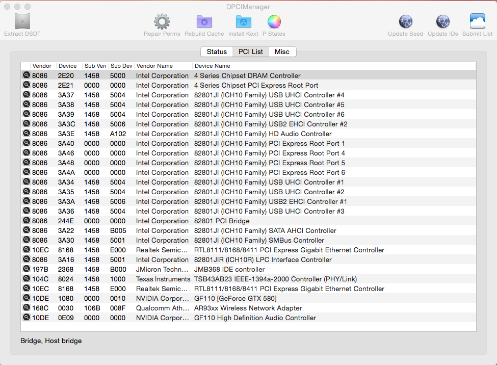

NelsonF Posted July 30, 2015 Author Share Posted July 30, 2015 É esse daqui? 82801JIR (ICH10R) LPC Interface Controller - Vendor 8086 - Device 3A16. Para facilitar anexei foto do DPCIManager e o DSDT extraído pelo MaciASL. Karacas muito nebuloso e eu tô ceguinho ceguinho... System DSDT.zip Link to comment https://www.insanelymac.com/forum/topic/307353-yosemite-em-ga-ep45t-ds3r-lga775/#findComment-2156652 Share on other sites More sharing options...
Allan Posted July 30, 2015 Share Posted July 30, 2015 Com esse chipset, vai usar esse patch - Já editei o patch, é só aplicar. into method label _DSM parent_adr 0x001F0000 remove_entry; into device name_adr 0x001F0000 insert begin Method (_DSM, 4, NotSerialized)\n {\n Store (Package (0x02)\n {\n "device-id", \n Buffer (0x04)\n {\n 0x16, 0x3A, 0x00, 0x00\n }\n }, Local0)\n DTGP (Arg0, Arg1, Arg2, Arg3, RefOf (Local0))\n Return (Local0)\n } end Para clarear para você, leia aqui: DSDT/SSDT: Basic knowledgeDSDT/SSDT: Edit using MacIASLDSDT/SSDT: Common DSDT patches 1 Link to comment https://www.insanelymac.com/forum/topic/307353-yosemite-em-ga-ep45t-ds3r-lga775/#findComment-2156655 Share on other sites More sharing options...

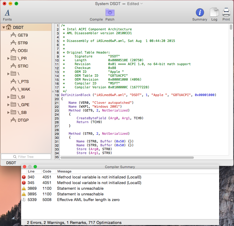

NelsonF Posted July 31, 2015 Author Share Posted July 31, 2015 Editei as patchs e ao compilar deu esse erro: Desculpem mas não entendi como corrigir esse erro... Link to comment https://www.insanelymac.com/forum/topic/307353-yosemite-em-ga-ep45t-ds3r-lga775/#findComment-2156873 Share on other sites More sharing options...
Allan Posted July 31, 2015 Share Posted July 31, 2015 Tenta adicionar os patchs do RehabMan no MaciASL. Geralmente tem a solução para o seu erro: DSDT/SSDT: Edit using MacIASL Link to comment https://www.insanelymac.com/forum/topic/307353-yosemite-em-ga-ep45t-ds3r-lga775/#findComment-2156874 Share on other sites More sharing options...

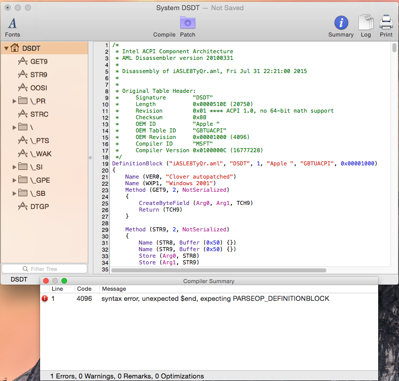

NelsonF Posted July 31, 2015 Author Share Posted July 31, 2015 Karakas... Editei errado e mandei o DSDT pra vc Editando os patchs que vc mencionou fica assim: Por isso que não se deve fazer as coisas qdo se está c/ sono...Só dá KaKa...Por favor, pode me ajudar a clarear isso? Link to comment https://www.insanelymac.com/forum/topic/307353-yosemite-em-ga-ep45t-ds3r-lga775/#findComment-2156960 Share on other sites More sharing options...
