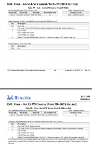

Mirone Posted July 23, 2015 Share Posted July 23, 2015 Post your codec_dump for a better analysis, although I know very well how ALC1150 works, but TimeWalker75a may have other ideas analyzing it. Maybe this picture helps: Link to comment https://www.insanelymac.com/forum/topic/307265-codeccommander-problems-with-alc1150-on-a-gigabyte-ga-z97x-ud3h-with-clover-and-cloveralc/#findComment-2155121 Share on other sites More sharing options...
CarlosML Posted July 24, 2015 Author Share Posted July 24, 2015 I opened an issue at Codec Commander's github repo and Dolnor has diagnosed an issue: https://github.com/Dolnor/EAPD-Codec-Commander/issues/14#issuecomment-124227826 It seems that indeed this motherboard has EAPD capable nodes (Gigabyte website claims it has built-in amp for speakers). Enabling "Update Nodes" makes the sound work after sleep, but only for a little while. After a couple of minutes of playback I can listen an audible pop and the sound dies, as if the amp is being deactivated again. Link to comment https://www.insanelymac.com/forum/topic/307265-codeccommander-problems-with-alc1150-on-a-gigabyte-ga-z97x-ud3h-with-clover-and-cloveralc/#findComment-2155130 Share on other sites More sharing options...
