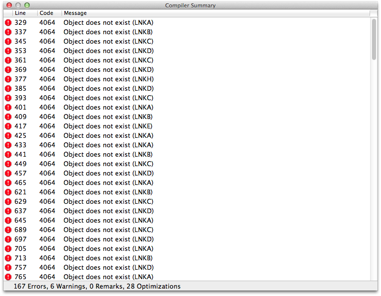

Whaka Posted April 21, 2015 Author Share Posted April 21, 2015 thanks guys but still the same issue. when i want to simply compile it (with acpi 4, i think it's the better choice ?), i still get this : Link to comment https://www.insanelymac.com/forum/topic/305762-compaq-cq10-130sf-bad-dsdt-dissasemble/#findComment-2129950 Share on other sites More sharing options...
RehabMan Posted April 21, 2015 Share Posted April 21, 2015 thanks guys but still the same issue. when i want to simply compile it (with acpi 4, i think it's the better choice ?), i still get this : Capture d’écran 2015-04-21 à 18.02.06.png Use ACPI 5.0. Be prepared to fix errors. Link to comment https://www.insanelymac.com/forum/topic/305762-compaq-cq10-130sf-bad-dsdt-dissasemble/#findComment-2129995 Share on other sites More sharing options...

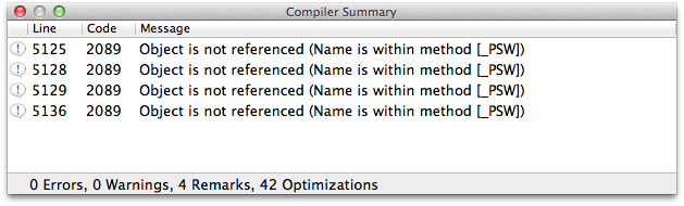

Whaka Posted April 22, 2015 Author Share Posted April 22, 2015 Be prepared to fix errors. 5203, 6126, syntax error, unexpected PARSEOP_DEVICE, expecting $end and premature End-Of-File yep... this one is gonna make me crazy... Link to comment https://www.insanelymac.com/forum/topic/305762-compaq-cq10-130sf-bad-dsdt-dissasemble/#findComment-2130068 Share on other sites More sharing options...
RehabMan Posted April 22, 2015 Share Posted April 22, 2015 5203, 6126, syntax error, unexpected PARSEOP_DEVICE, expecting $end and premature End-Of-File yep... this one is gonna make me crazy... Use ACPI5. Disassemble with 'iasl -da -dl *.aml' The errors you have are obvious... Intel ACPI Component Architecture ASL+ Optimizing Compiler version 20150410-64 Copyright (c) 2000 - 2015 Intel Corporation Compiler aborting due to parser-detected syntax error(s) dsdt.dsl 5020: If (_OSI ("Windows 2009")) Error 6126 - ^ syntax error, unexpected PARSEOP_IF dsdt.dsl 5066: If (_OSI ("Windows 2009")) {} Error 6126 - ^ syntax error, unexpected PARSEOP_IF dsdt.dsl 5082: If (_OSI ("Windows 2009")) {} Error 6126 - ^ syntax error, unexpected PARSEOP_IF dsdt.dsl 5089: Error 6126 - syntax error, unexpected PARSEOP_DEVICE, expecting $end and premature End-Of-File ASL Input: dsdt.dsl - 5089 lines, 206458 bytes, 1727 keywords Compilation complete. 4 Errors, 0 Warnings, 0 Remarks, 0 Optimizations Note code not allowed by ACPI spec anymore... If (_OSI ("Windows 2009")) { Method (_PSW, 1, NotSerialized) // _PSW: Power State Wake { If (Arg0) { Store (0x03, URES) } Else { Store (Zero, URES) } Acquire (ECMX, 0xFFFF) If (ECRG) { If (LEqual (^^SBRG.EC0.ADP, Zero)) { Store (Zero, URES) } } Release (ECMX) } } Change to: //If (_OSI ("Windows 2009")) //{ Method (_PSW, 1, NotSerialized) // _PSW: Power State Wake { If (Arg0) { Store (0x03, URES) } Else { Store (Zero, URES) } Acquire (ECMX, 0xFFFF) If (ECRG) { If (LEqual (^^SBRG.EC0.ADP, Zero)) { Store (Zero, URES) } } Release (ECMX) } //} And really dumb stuff: If (_OSI ("Windows 2009")) {} Method (_S3D, 0, NotSerialized) // _S3D: S3 Device State { Return (0x03) } Replace: //If (_OSI ("Windows 2009")) {} Method (_S3D, 0, NotSerialized) // _S3D: S3 Device State { Return (0x03) } Repeat for all occurrences. After you fix all of that, you'll have _PLD buffer/package error. Use "Fix _PLD Buffer/Package Error" from: https://github.com/RehabMan/Laptop-DSDT-Patch Link to comment https://www.insanelymac.com/forum/topic/305762-compaq-cq10-130sf-bad-dsdt-dissasemble/#findComment-2130150 Share on other sites More sharing options...
