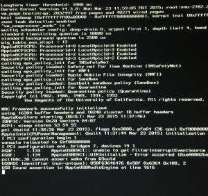

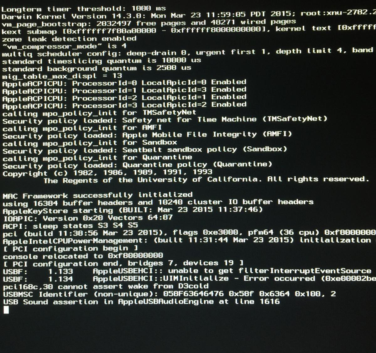

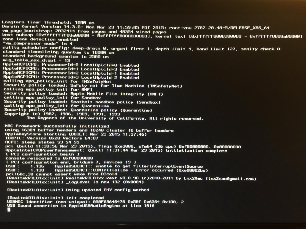

Luthraz Posted April 12, 2015 Share Posted April 12, 2015 I've had a few issues since updating to Yosemite on my Gigabyte EP45T-UD3LR, and now especially since updating to 10.10.3. Initially, my only issue was several USB ports not working on my tower, which I learned to deal with basically after no resolution being found.Now, after updating to 10.10.3 I cannot boot without ignoring caches (-f) at boot and sound does not work no matter what I try. I am attaching my boot screens both before attempting to fix the hanging boot by removing a kext (attachment 1.jpg) and the hanging verbose boot after the kext is removed (attachment 2.jpg). The kext removed is needed for my Ethernet as well, so I'm at a loss. Any help would be greatly appreciated! Link to comment https://www.insanelymac.com/forum/topic/305617-yosemite-issues-10103-gigabyte-ep45t-ud3lr/ Share on other sites More sharing options...

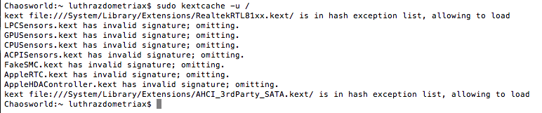

WaldMeister Posted April 12, 2015 Share Posted April 12, 2015 Well, since you can boot with -f, try rebuilding the caches after booting with -f. Open up a terminal windows and type: sudo touch /System/Library/Extensions sudo kextcache -u / Are you injecting any USB related kexts? Link to comment https://www.insanelymac.com/forum/topic/305617-yosemite-issues-10103-gigabyte-ep45t-ud3lr/#findComment-2127424 Share on other sites More sharing options...
Luthraz Posted April 13, 2015 Author Share Posted April 13, 2015 LexHimself: No I am not. I believe in the cache rebuild (thanks for that btw) it lists off everything I've installed via multib, here is a screenshot of that readout: Link to comment https://www.insanelymac.com/forum/topic/305617-yosemite-issues-10103-gigabyte-ep45t-ud3lr/#findComment-2127557 Share on other sites More sharing options...
