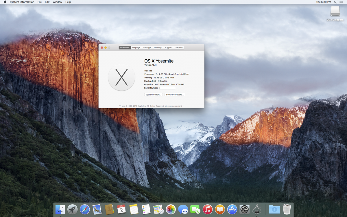

Blaggah Posted February 21, 2016 Share Posted February 21, 2016 -----UPDATED----- Complete Guide Clover Boot Manager Mode ESP here ☟ http://www.insanelymac.com/forum/topic/307920-guide-clover-dell-precision-690-workstation/ DELL Precision 690 Workstation :: Specs :: Double Intel® Xeon® Processor E5335 (8M Cache, 2.00 GHz, 1333 MHz FSB) 16 Gig Ram Kingston DDR3 667 Mhz Graphics ASUS Geforce GT 610 2 gig (Silent Fan less) SSD Kingston 120 gig (OS X) / HDD WD 200 Gig sata (Windows 8) Downloads latest Bios from Officiel Site DELL.com ************************************************** What you need? USB drive 8 Gig Installer OS X Yosemite.app on Applications Folder Formate the USB one partition Mac OS Extend journalise / Guid and Run Installer to your USB Install OS X 10 to your SSD or HDD Reboot with the USB to your New Installation Now Install manually with kexwizard BCM5722D.kext now you need to do Maintenance with kexwizard Repaire and rebuild cache and now your safely reboot. and go to Apple menue and Install Update 10.10.2 and reboot again and complete the post installations with DELL Precision 690 postInstaller.pkg or complete manually your post installation and finishing with VoodooHDA-v2.8.2.x64.ML.pkg All files is available on the attaching Zip THIS IS THE RESULT Enjoy Credit and thanks to Chameleon Team for Chameleon v2.3svn r2570 And all dev for the kext and App janek202 Alex Auditore Développeurs : zef, Turbo, dfe, netkas, mackerintel, mercurysquad, fassl, Kabyl, Crazor, Dense, kaitek, iNDi, munky, DHP, JrCs, asereBLN, rekursor, mozodojo, meklort, AnV, valv, AzimutZ, Slice, cosmo1t, cparm, Conti, ErmaC Merci à : bumby, kalyway, Krazubu, Eddie11c, JaS, fassl, XyZ, SMF, flama, Galaxy, sckevyn, MasterChief, smith@@, blackosx, DHP, nawcom, scorpius, dmazar Packageurs : kalyway, AzimutZ, blackosx, ErmaC, scrax, JrCs Paquet construit par: ErmaC, traduction par: JrCs Copyright © 2008-2014 Credits to: - Pike R. Alpha - ErmaC - Bungo - blackosx - Micky1979 - crazybirdy - oldnapalm - janek202 - MinusZwei Packager chris1111 I've been looking at the Precision 690 for a very long time now and was wondering if the version of motherboard really is essential in order to run 2 quad core xeon cpus. One particular guy by the name of ATL Shogun from youtube has a video showing his Precision 690 in action and stated that you need the MY171 Rev. A02 motherboard or above in order to run 2 quad core cpus. Link to comment https://www.insanelymac.com/forum/topic/305442-guide-dell-precision-690-os-x-yosemite-1010x/page/2/#findComment-2217141 Share on other sites More sharing options...

Toskache Posted February 27, 2016 Share Posted February 27, 2016 Would a System with two 2,3 GHZ INTEL XEON type E5345 also work? Link to comment https://www.insanelymac.com/forum/topic/305442-guide-dell-precision-690-os-x-yosemite-1010x/page/2/#findComment-2218976 Share on other sites More sharing options...
chris1111 Posted February 27, 2016 Author Share Posted February 27, 2016 Would a System with two 2,3 GHZ INTEL XEON type E5345 also work? Why not! depends more then the Graphics cards Link to comment https://www.insanelymac.com/forum/topic/305442-guide-dell-precision-690-os-x-yosemite-1010x/page/2/#findComment-2218990 Share on other sites More sharing options...
Blaggah Posted February 27, 2016 Share Posted February 27, 2016 I don't see why not because Chris got 2x quad xeon chips running on his and I've just got the same CPUs as him, just waiting on heatsink to upgrade mine. Link to comment https://www.insanelymac.com/forum/topic/305442-guide-dell-precision-690-os-x-yosemite-1010x/page/2/#findComment-2219006 Share on other sites More sharing options...
chris1111 Posted February 27, 2016 Author Share Posted February 27, 2016 I don't see why not because Chris got 2x quad xeon chips running on his and I've just got the same CPUs as him, just waiting on heatsink to upgrade mine. heatsink is a big big difference Link to comment https://www.insanelymac.com/forum/topic/305442-guide-dell-precision-690-os-x-yosemite-1010x/page/2/#findComment-2219010 Share on other sites More sharing options...
