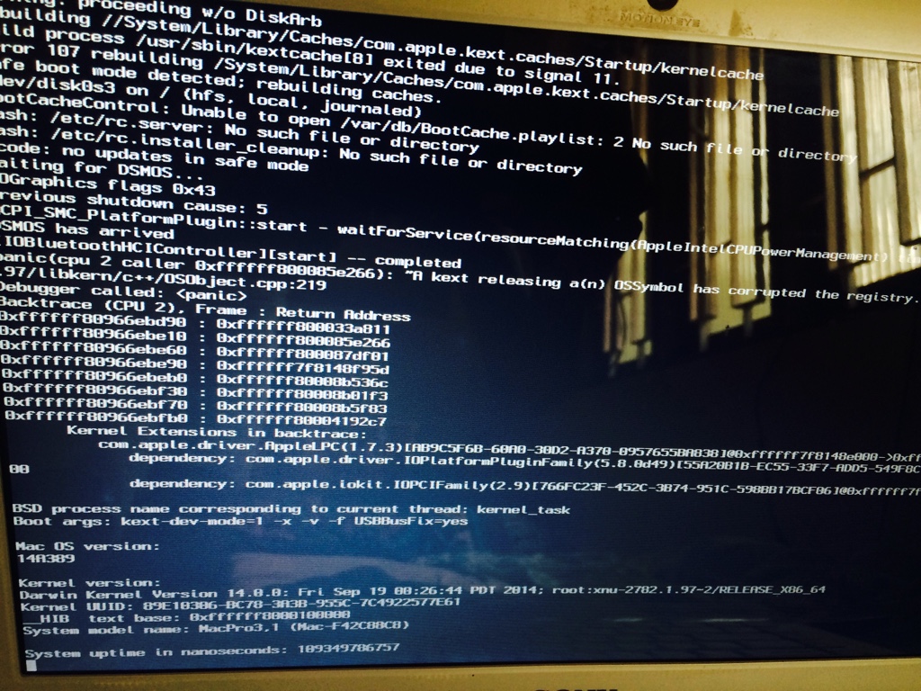

sistoelemento Posted March 22, 2015 Author Share Posted March 22, 2015 Actually i made wifi working last time and on the fly i installed some kexts and got a kernel panic. So i reinstalled yosemite and now when i boot using the usb installer to my yosemite installation i get a kp, scereenshot is attached i used the flags when i first installed yosemite and succesfully went to welcome screen. But now its not working. I think im getting the same kernel panic which forced me to reinstall yosemite. Link to comment https://www.insanelymac.com/forum/topic/305238-qeci-on-ati-mobility-5470-radeon-512-mb/#findComment-2122052 Share on other sites More sharing options...

sistoelemento Posted March 24, 2015 Author Share Posted March 24, 2015 hello use clover and set it <key>Inject</key> <dict> <key>ATI</key> <true/> </dict> <key>LoadVBios</key> <true/> <key>InjectEDID</key> <true/> <key>FBName</key> <string>Hoolock</string> good hack can you please see the picture of verbose attached Link to comment https://www.insanelymac.com/forum/topic/305238-qeci-on-ati-mobility-5470-radeon-512-mb/#findComment-2122547 Share on other sites More sharing options...
artur_pt Posted March 24, 2015 Share Posted March 24, 2015 hello first u have wrong smbios .. should be macbookpro6,1 or 6,2 then u have problems in lpc have u a proper edited dsdt ? and should use the stock kext i have a lappy with same graphics .. is in my sig and run yose with that clover set for the graphics without problems good hack Link to comment https://www.insanelymac.com/forum/topic/305238-qeci-on-ati-mobility-5470-radeon-512-mb/#findComment-2122549 Share on other sites More sharing options...

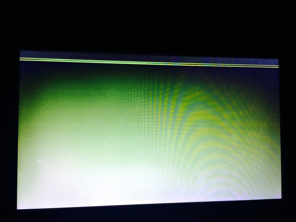

sistoelemento Posted March 26, 2015 Author Share Posted March 26, 2015 hello use clover and set it <key>Inject</key> <dict> <key>ATI</key> <true/> </dict> <key>LoadVBios</key> <true/> <key>InjectEDID</key> <true/> <key>FBName</key> <string>Hoolock</string>good hack Im getting this screen after setting these options. Link to comment https://www.insanelymac.com/forum/topic/305238-qeci-on-ati-mobility-5470-radeon-512-mb/#findComment-2123361 Share on other sites More sharing options...

sistoelemento Posted March 30, 2015 Author Share Posted March 30, 2015 hello http://clover-wiki.zetam.org/Configuration/Graphics#CustomEDID good hack Still not working . i Got this same error with Eulemur framebuffer in Mountai lion and when i change it to Hoolock i got full qe/ci but in this case both does not work ! Link to comment https://www.insanelymac.com/forum/topic/305238-qeci-on-ati-mobility-5470-radeon-512-mb/#findComment-2124265 Share on other sites More sharing options...
sistoelemento Posted March 30, 2015 Author Share Posted March 30, 2015 hello http://clover-wiki.zetam.org/Configuration/Graphics#CustomEDID good hack Update: i used my ml kexts using which this card worked before. Now the display has proper resolution but black color and it shows mouse updates and keypresses See attached. I think im nearing success And when i enable ati injector and disable load vbios and set fb to hoolock im getting display. and here is the dpci screenshot Link to comment https://www.insanelymac.com/forum/topic/305238-qeci-on-ati-mobility-5470-radeon-512-mb/#findComment-2124270 Share on other sites More sharing options...
