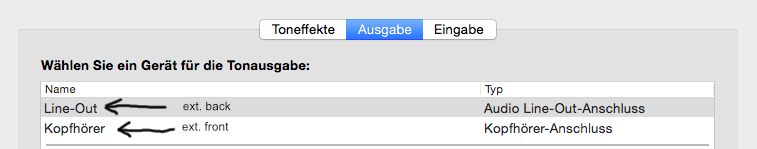

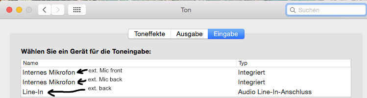

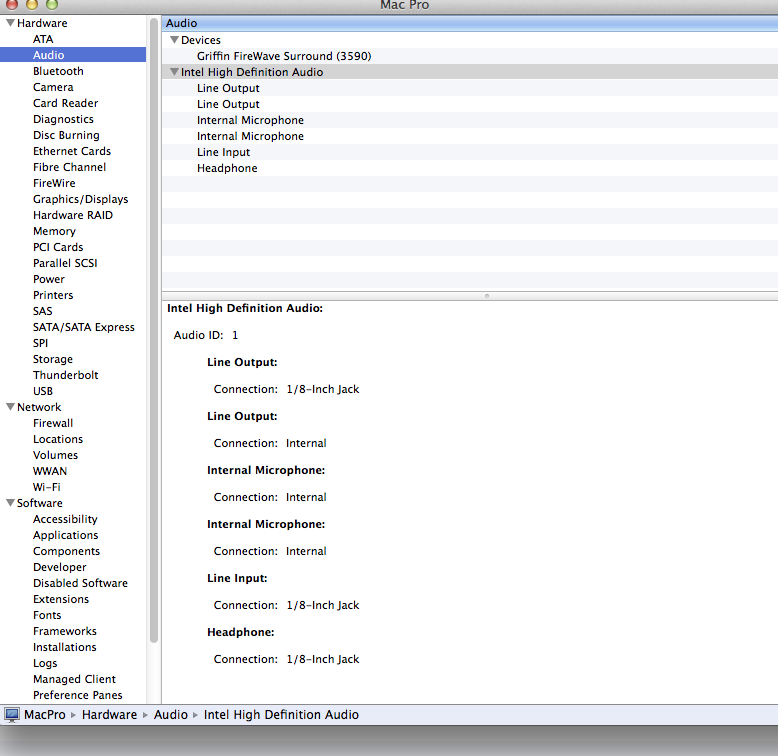

MacPeet Posted June 20, 2015 Share Posted June 20, 2015 Here's a version with LineOut back and LineIn back. These nodes should definitely go. You can also try it yourself. This goes even faster. The Binary patch of HDA's is already finished. The PinConfig is also ok. You have only the nodes in the platform.xml test and see. input nodes: Mic (front) test with 7 36 25 Mic (back) test with 9 34 24 LineIn (back) test with 8 35 26 output nodes: LineOut (back) is definitely 21 12 2 Headphone (front) test with 27 12 2 or 27 13 3 AppleHDA.kext_Z800_10.9.5_002.zip Link to comment https://www.insanelymac.com/forum/topic/303989-fix-my-hp-just-a-few-random-dsdt-edits-to-improve-your-hacmac-experience/#findComment-2146798 Share on other sites More sharing options...
MacPeet Posted June 21, 2015 Share Posted June 21, 2015 It looks a bit after VoodooHDA? The Z800 ALC262 and my Esprimo are almost the same. Only the output nodes are probably different. With a little patience, we get it to work safely. That's the goal. see pictures Here are two versions for testing and one Version for 10.9.5 AppleHDA_Yosemite_ALC262_HP_Z800_003.zip AppleHDA_Yosemite_ALC262_HP_Z800_004.zip AppleHDA.kext_Z800_10.9.5_003.zip Link to comment https://www.insanelymac.com/forum/topic/303989-fix-my-hp-just-a-few-random-dsdt-edits-to-improve-your-hacmac-experience/#findComment-2147036 Share on other sites More sharing options...
