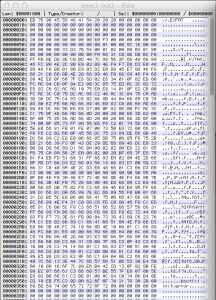

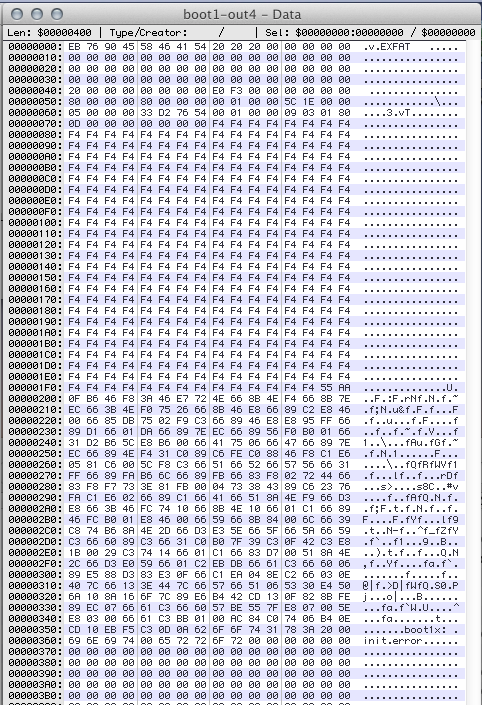

OK,
this way boot1-install successfully write boot1 on my USB drive.
It now looks like
Attempt to boot from is failed.
Now I boot into system usual way and see the drive is broken
What is happen? Why the contents changed?
Continue testing with QEMU...

  • The problem with illegal instruction is call to CFStringGetCStringPtr which sometimes fails.  I need to change code to provide a buffer.  Will fix. Fixed.
  • Do you know why the boot sector got overwritten with 0xf4?  (hlt instruction)  It's the default boot sector OS X creates for exFAT.  Anyways, the sector looks okay in your disc image. [Note: the boot sector may have been overwritten if the partition wasn't dismounted when installing boot1x.]
  • I'll analyze the disc image you uploaded later when I have time. See post #12.
  • I've tested boot0xg, and it seems to work, but chameleon boot2 is not succeeding in loading org.chameleon.Boot.plist from adjoining fat32 partition.  So I'm still checking it. Done testing boot0xg.  It works.  For some reason, when the adjoining partition for /Extra is FAT32, Chameleon's boot2 can't read it on GPT.  However, if the adjoining partition for /Extra is HFS+, things work fine.  I've repackaged boot0xg with the other stuff and added a Readme.txt file for installing.   EDIT: starting with r2494, Chameleon can read files off FAT32 in GPT.
  • Now it's 433 posts :)

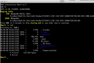

I confirm, it works!
I used tolerant version and made "make" in src folder of 1.0.2 package.
Inserted USB drive and make
sudo ./boot1-install -yM /dev/rdisk1s1
It's fine.
Then use Disk Utility to make ISO from the drive.
Yesterday I made a mistake creating iso from partition while for QEMU it must be whole drive. Now it is.
CFx3.img.lzma.zip
Then I will think how to add this possibility to Clover package.
