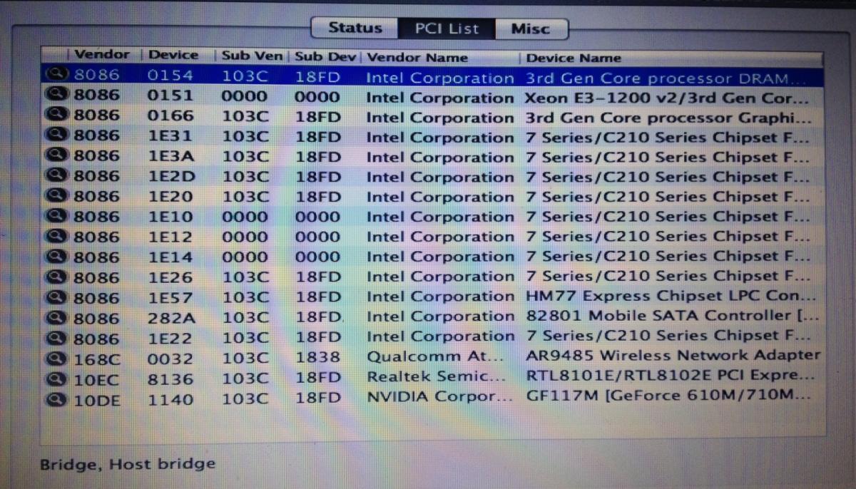

Allan Posted November 5, 2014 Share Posted November 5, 2014 Please, download DPCIManager app, and go in PCIList section, take a screenshot and upload here. 1 Link to comment https://www.insanelymac.com/forum/topic/302378-no-wifi-in-niresh-mavericks-su-hp/#findComment-2081652 Share on other sites More sharing options...
carbo178 Posted November 5, 2014 Share Posted November 5, 2014 Fai uno screen con DPCI Manager, per vedere il dev-id Edit: Allan mi ha preceduto... 1 Link to comment https://www.insanelymac.com/forum/topic/302378-no-wifi-in-niresh-mavericks-su-hp/#findComment-2081658 Share on other sites More sharing options...
osborn87 Posted November 5, 2014 Author Share Posted November 5, 2014 Attached the screenshot of DPCI manager Link to comment https://www.insanelymac.com/forum/topic/302378-no-wifi-in-niresh-mavericks-su-hp/#findComment-2081670 Share on other sites More sharing options...
carbo178 Posted November 5, 2014 Share Posted November 5, 2014 Brutte notizie, non è supportata; trova una AR9285 1 Link to comment https://www.insanelymac.com/forum/topic/302378-no-wifi-in-niresh-mavericks-su-hp/#findComment-2081674 Share on other sites More sharing options...
osborn87 Posted November 5, 2014 Author Share Posted November 5, 2014 Brutte notizie, non è supportata; trova una AR9285 Cioè? Link to comment https://www.insanelymac.com/forum/topic/302378-no-wifi-in-niresh-mavericks-su-hp/#findComment-2081683 Share on other sites More sharing options...
carbo178 Posted November 5, 2014 Share Posted November 5, 2014 Cioè non ci sono kext per il chipset in questione, non funziona nemmeno aggiungendo il dev-id della schedina nel kext AirPortAtheros40. Devi trovare una scheda compatibile con il tuo portatile (a causa del bios che dispone di una blacklist delle periferiche), consiglio di cercarla con chip AR9285 Link to comment https://www.insanelymac.com/forum/topic/302378-no-wifi-in-niresh-mavericks-su-hp/#findComment-2081692 Share on other sites More sharing options...

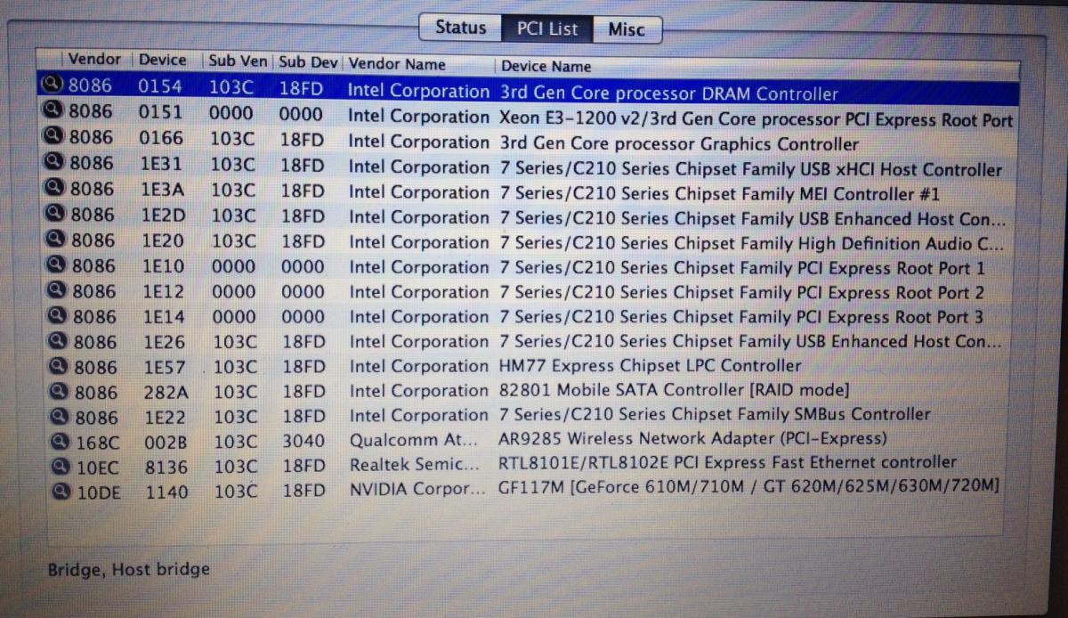

osborn87 Posted November 5, 2014 Author Share Posted November 5, 2014 Ho sostituito e ora in DPCIManager mi dà AR9285 ma quando ho riacceso non c'è nessun wifi Link to comment https://www.insanelymac.com/forum/topic/302378-no-wifi-in-niresh-mavericks-su-hp/#findComment-2081744 Share on other sites More sharing options...
carbo178 Posted November 5, 2014 Share Posted November 5, 2014 Fai lo screen di DPCI Manager Link to comment https://www.insanelymac.com/forum/topic/302378-no-wifi-in-niresh-mavericks-su-hp/#findComment-2081771 Share on other sites More sharing options...
osborn87 Posted November 5, 2014 Author Share Posted November 5, 2014 Ecco qua! Link to comment https://www.insanelymac.com/forum/topic/302378-no-wifi-in-niresh-mavericks-su-hp/#findComment-2081779 Share on other sites More sharing options...
maurus2705 Posted November 5, 2014 Share Posted November 5, 2014 Io ho dovuto usare Hordnis, praticamente il mio smartphone funge da modem e mi collego tramite wifi di casa Link to comment https://www.insanelymac.com/forum/topic/302378-no-wifi-in-niresh-mavericks-su-hp/#findComment-2081780 Share on other sites More sharing options...
osborn87 Posted November 5, 2014 Author Share Posted November 5, 2014 Ho risolto! Ho installato il KEXT: AirPortAtheros40.kext Link to comment https://www.insanelymac.com/forum/topic/302378-no-wifi-in-niresh-mavericks-su-hp/#findComment-2081793 Share on other sites More sharing options...
