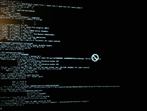

oOo Posted November 4, 2014 Share Posted November 4, 2014 @asd0rr by video glitch, do you mean something like the attached image? It happens right after I get the "Missing Bluetooth Controller Transport!" error. Looks like this drive (Patriot Supersonic Magnum 64GB USB 3.0) might not be compatible. I'll report back later with a USB 2.0 drive. --- A few small tweaks to the guide. Extract pokenguyen's files anywhere, then open the 'EFI' folder, navigate to the CLOVER folder, copy two things from here Also do you replace the kexts folder or only move over the contents in “Other”? Looks like either one would work. 1 Link to comment https://www.insanelymac.com/forum/topic/302322-guide-os-x-1010-yosemite-on-surfacepro2-multiboot/#findComment-2081350 Share on other sites More sharing options...

Oxycodon-IV Posted November 5, 2014 Share Posted November 5, 2014 I have a similar problem: When booting from Clover and Pressing enter on "Boot Mac OS X from OS X Base System"... I DO get the apple logo with the black background, then the loading bar appears under the Apple logo...it loads 1/3 of the way then the Apple logo turns in that symbol in the Image above (Circle with a Line through it) Any Ideas guys? Link to comment https://www.insanelymac.com/forum/topic/302322-guide-os-x-1010-yosemite-on-surfacepro2-multiboot/#findComment-2081397 Share on other sites More sharing options...
oOo Posted November 5, 2014 Share Posted November 5, 2014 After a quarter of the loader bar fills up, the apple logo turns into a cancel icon so I tried the verbose mode. I'll report back in a few hours when I try another hard drive. Ahh, looks like we have the same issue oxycodon-IV. Link to comment https://www.insanelymac.com/forum/topic/302322-guide-os-x-1010-yosemite-on-surfacepro2-multiboot/#findComment-2081398 Share on other sites More sharing options...
oOo Posted November 5, 2014 Share Posted November 5, 2014 I have a similar problem: When booting from Clover and Pressing enter on "Boot Mac OS X from OS X Base System"... I DO get the apple logo with the black background, then the loading bar appears under the Apple logo...it loads 1/3 of the way then the Apple logo turns in that symbol in the Image above (Circle with a Line through it) Any Ideas guys? After searching around the forums for quite a bit of time, I tried a bunch of random suggestions... needless to say, I finally got the installer to show up. About to attempt the rest of the guide. From the looks of it, an older / slower flash drive seemed to do the trick. SanDisk Cruzer Fit 32GB USB 2.0 Low-Profile Flash Drive What didn't work - Attempting to change the config.plist params - Pulling off the surface touch keyboard when attempting to load the base drive - Using an external HD as a flash drive - Connecting a flash drive / external HD to a USB 2.0 hub then connecting the hub to the surface - Connecting a flash drive / external HD to a USB 3.0 hub then connecting the hub to the surface Link to comment https://www.insanelymac.com/forum/topic/302322-guide-os-x-1010-yosemite-on-surfacepro2-multiboot/#findComment-2081428 Share on other sites More sharing options...

asd0rr Posted November 5, 2014 Share Posted November 5, 2014 @asd0rr by video glitch, do you mean something like the attached image? It happens right after I get the "Missing Bluetooth Controller Transport!" error. Looks like this drive (Patriot Supersonic Magnum 64GB USB 3.0) might not be compatible. I'll report back later with a USB 2.0 drive. Yep, it seems that usb 3.0 pen doesn't work fine, I switched to 2.0 and worked fine without any issue Link to comment https://www.insanelymac.com/forum/topic/302322-guide-os-x-1010-yosemite-on-surfacepro2-multiboot/#findComment-2081556 Share on other sites More sharing options...
Oxycodon-IV Posted November 5, 2014 Share Posted November 5, 2014 wow seriously? USB 3.0 don't work? everything I own is 3.0 :S Link to comment https://www.insanelymac.com/forum/topic/302322-guide-os-x-1010-yosemite-on-surfacepro2-multiboot/#findComment-2081642 Share on other sites More sharing options...
oOo Posted November 5, 2014 Share Posted November 5, 2014 wow seriously? USB 3.0 don't work? everything I own is 3.0 :S Yep, I'll have to try passing the devices through a USB 2.0 hub to see if it works, but I'd imagine it won't since I wasn't able to boot a USB 3.0 flash drive through a USB 2.0 hub. I wonder if it's related to drivers. I'll do more exploration later and report back. 1 Link to comment https://www.insanelymac.com/forum/topic/302322-guide-os-x-1010-yosemite-on-surfacepro2-multiboot/#findComment-2081646 Share on other sites More sharing options...
